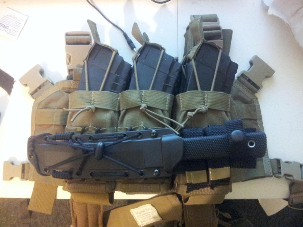

As for the fighting ability of the WW2 model. It seems very practical for me though I do recognize what you say about the thinner ones. I also have a Cold Steel Recon Tanto San Mai III strapped to the front of my chest rig for fighting. I just like having the option of the Khukuri too.

A khuk and a small (5") antipersonnel scraper would render the cold steel redundant.

I was thinking of using the Tanto with the Khukuri.

This is what I carried. Maybe 5" blade, reverse grip inside main edge. Pure antipersonnel scraper/grappling accessory but I never knew it was there. Ziptied it into my paraclete under the cummerbund, let a little bit of lanyard stick out for accessing.
Nobody else even knew it was a blade.
