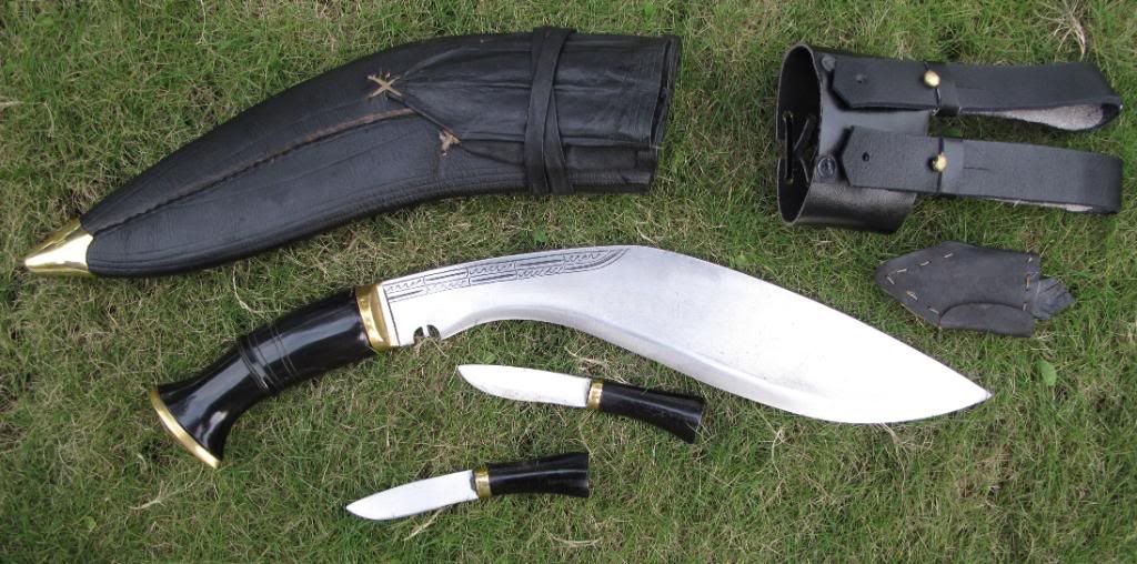

Yes, the kami for the chiruwa horn-handled WWII is Dil.
Here's a non-chiruwa WWII by Vim kami. A little smaller, at 17" OAL and 24.5 oz, and just as beautiful in my opinion.
The shape of the handle there really interests me. Can you tell me more about it? It looks like it is offset. I have seen other Khukuris made by other companies that have a different style of handle like this one here. Can you tell me the benefits and disadvantages of both?
This is one interesting design I found. It looks as if the handle is more curved.
