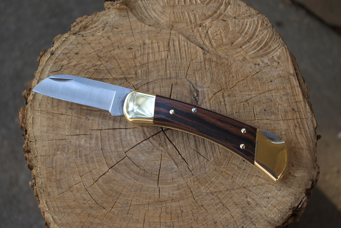

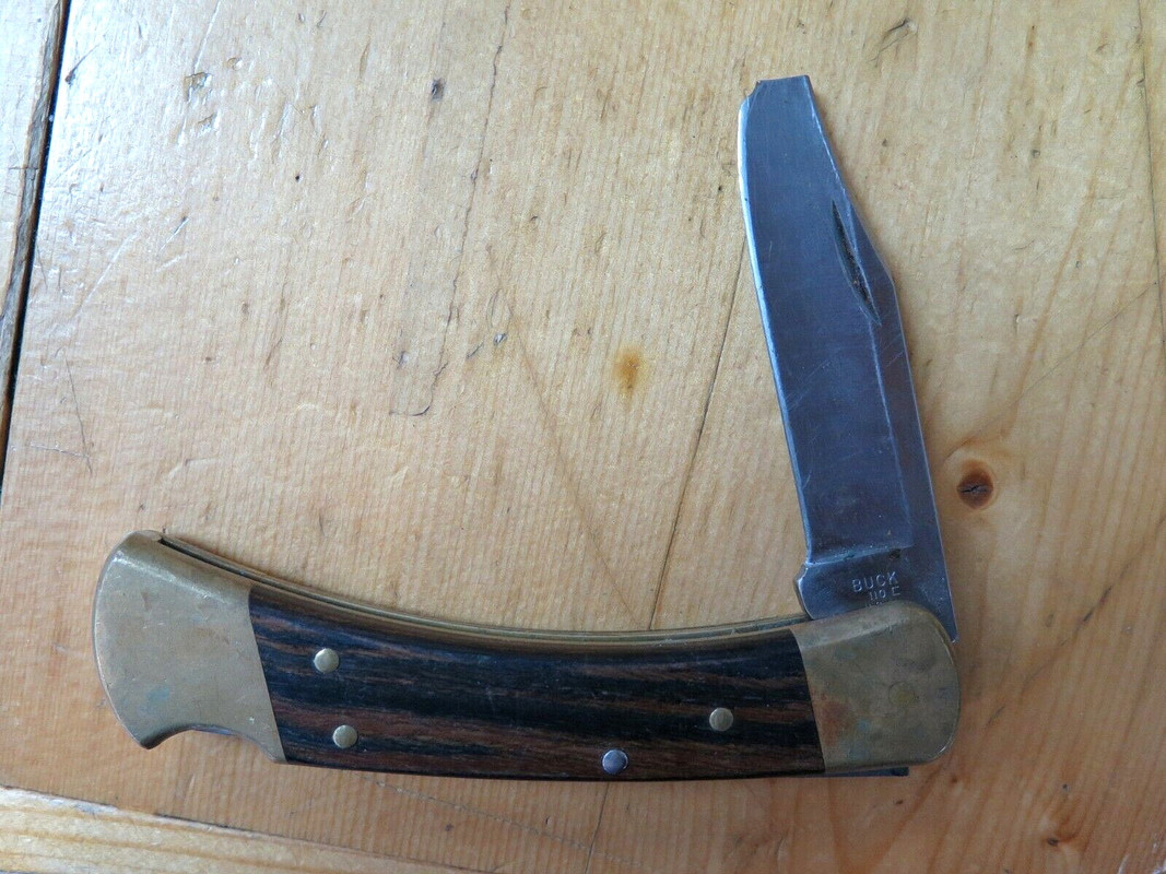

….Since the tip snapped off on the 110 yesterday, anyone have a good idea of how to shorten the blade without ruining the temper, or taking 200 years on a whetstone? Lol
It's not difficult to carefully sand or grind it without getting it too hot. Just make sure you grind the spine down, if you grind from the edge up then the blade may stick out of the blade well, not fun, not to mention you lose the profile of the edge.

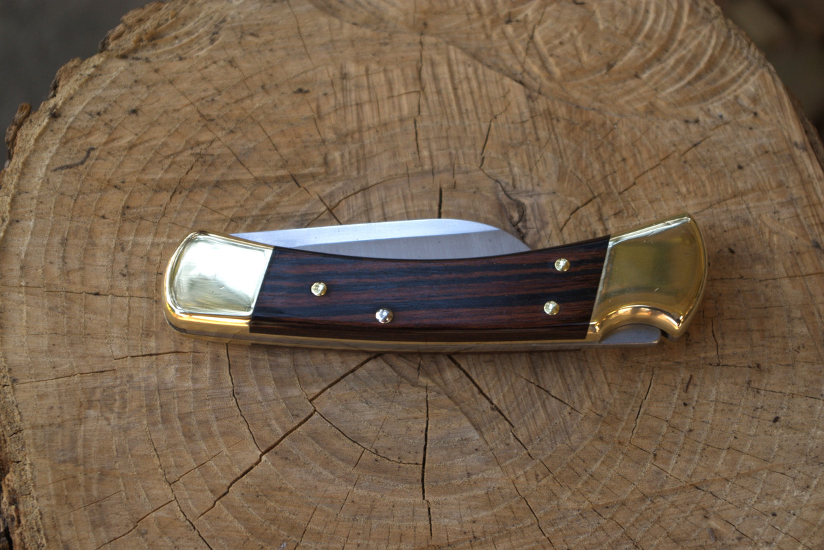

Exactly - I recently reshaped a badly broken blade using a bench grinder, working slowly from the spine down and dipping it in water between passes to keep it cool. Ended up with a nice stubby sheepsfoot shape. Gave it my home spa treatment and here are the before and after photos:
