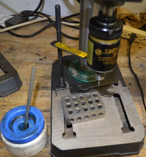

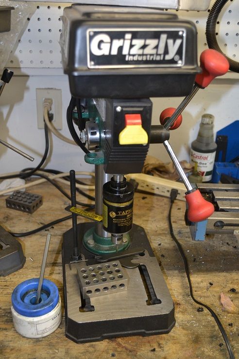

Here's a cool shop addition... dedicated tapping setup!
I removed the stop and guard from the drill so they were not in the way. A lot of tapping heads have a JT33 taper so I picked up this drill which has an arbor taper that matches.
I also chopped about 4" off of the drill column and removed the table so the tap height is just right with a 1-2-3 block underneath my work. I do this to all of my drill presses, it improves rigidity by eliminating the table and makes the height just right for what I do in the knife shop.
The stop for the Tapmatic arm went in a hole in the base of the press... it worked out well and is nice and out of the way.
It works great too!

I have a shars version of the same design and a larger procunier that will tap up to 1/2" in mild steel (if I haven't forgeotten the species). Then are so easy to use. Does yours reverse feed and 2x the speed compared to the downfeed?
That is a great setup. Have you yanked the tapping head out of the spindle yet while feeding? That a fun experience.

Daniel, Great minds think alike. :D This is the same setup I did last year. Even the same drill press. Though I still use the table that came with the Drill. Never looked back and don't break taps anymore. :thumbup:

I think it does the 2x reverse speed...
No pulling out the spindle but I don't want to see that! I tried so hard to get my previous tapmatic out of the spindle I think that is what eventually killed it.

I like it but you can also chuck one up in the drill or a mill collet depending on our setup... this just saves me time.

Stay on the lookout for used ones, I have seen them go for very cheap. If I understand correctly they can be fixed for 40% of the new price but don't quote me on that. The Procunier and other brands work well too from what I hear. I was breaking a tap on just about every folder before I got mine so it was the cheapest way to go! :D

Very nice! I saw your setup on the Bingalor thread and it reminded me to get going on this!
The press is very nice for the money, it beats the heck out of my HF press.
