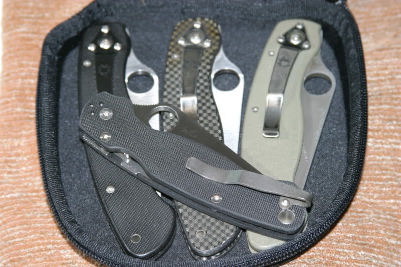

Does anyone know where one can get a deep carry clip for the Spyderco Endura/Delica?
Thank you.
This fits with slight filing (diamond file or Dremel) to the holes.
http://www.usaknifemaker.com/store/ti-pocket-clip-formed-tumbled-040-low-rider-thin-p-1941.html
Looks like this on a Para2:

The holes for the clip screws are a bit too far apart (fits the older Spyderco 3 screw clips) so you need to widen the holes a bit towards the center. Takes a few minutes with a good file or Dremel tool.
STR is very nice:
The usaknifemaker clips are Ti so you can always heat annodize them to a darker color, I got mine to match my jeans very well.
