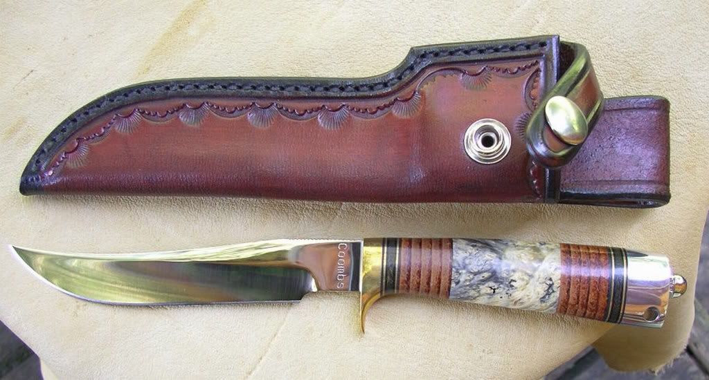

Some pics of knives I would deem hunters, or potential hunters. As you can see, blade shape and length varies.
Sorry, an aside:
Halbie, after seeing the top knife in your pictures (which looks beautiful, unique, and expertly designed) I went to Keith Ouye's website and found many great looking knives. I want to try and save up for one, should take about 10yrs. (very pricey).

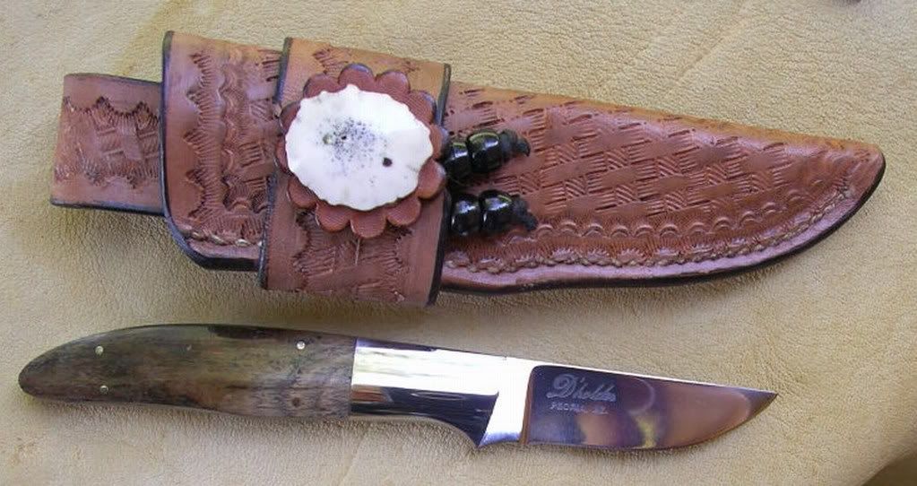

I carried and used a lot of different blade styles and sizes until I finally settled on this one about 10 years ago. I had a very good friend who was one of the best makers I have known and he helped me with the design and made the one I still carry. He has since passed away and I now make this pattern.
It's small enough not to get in the way while I'm hunting yet big enough to do whatever I need it to. It has plenty of belly for skinning but still has a bit of a point when needed.
This is what works for me.
