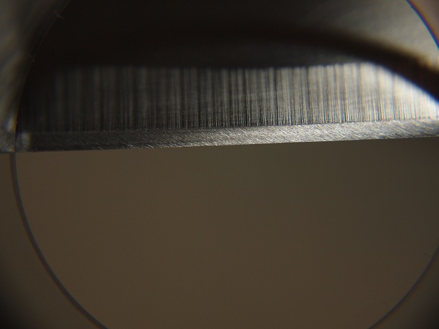

Hi, My Young Apprentice. I’m not a pro by any means, but I’ve been learning a lot lately, and I’m happy to share what I’ve learned. I hope this helps! I was sharpening a few knives today and came across the perfect candidate to illustrate this issue. Same problem: a warp on the straight segment of the blade. I sharpened it on the Norton Combo India stone but left the warp intact to illustrate for our purposes.
Here is the clean side of the blade after normal sharpening (coarse and then fine side of the stone):
Here is the warped side after the same sharpening. As you can see, the bevel was hardly even touched by the stones. You can still distinctly see the factory grind, and the edge was not sharp on those sections:
Here is the warped side after repair. You can see that the some of the gouges from the warp damage are still there, but the bevel is scratched with the final stone’s pattern, and the edge is now apexed:
Here is the video showing how I got those results:
[youtube]h9_3tdfnOWg[/youtube]

Any suggestions for that part that won't hit?
If I understand you correctly it sounds like there is a slight recurve in the cutting edge, you can either rock the blade off the edge of the stone as you sharpen, or you can continue to sharpen until you've ground away the edge on either side of the part that won't hit, thereby wearing down and removing the slight recurve.
If it's not recurved but possibly bent as in when looking directly at the spine or edge, and in your case when you say it's just the right side that doesn't hit then perhaps this means the right side would be on the inside of the curve. you could workaround this by teetering the blade off the edge as before. if you tried to wear it down till it hit though it might result in a main bevel width being greater on either sides of that 'part that won't hit' even with the same edge angle along the blade.
These are the only two things that I have found that result in a stubborn area of the blade not hitting the stone, (on a flat stone) , when its from a slight recurve I usually just grind way down the edge nearest the handle till it's good, and I bought a straight razor once that was a bit warped so it was from a bent blade, I had to rock it off the edge for that one..
Hope this helps :)
