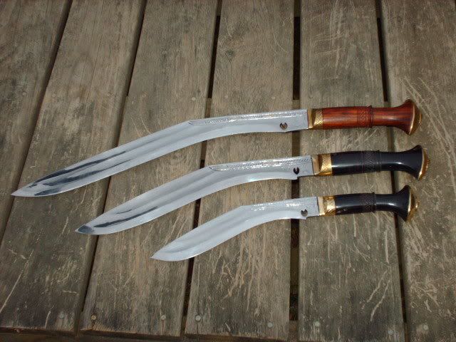

Just to see if it could be done, I turned these H.I. chitlangi's into khukuri-shaped straight razors:
After some months of use after applying those wicked edges, they're showing virtually no signs of dullness.
I used the big 26" one for the last couple of days to butcher a downed maple tree. It will still cleanly remove hair from your arm as easily as a Gillette will.
The small 15.5" chitlangi belongs to my wife. It also took - and holds - a surgical quality edge. She usually puts it to work as a meat cleaver in the kitchen. I bought it for her last summer and I have yet to touch up that edge.
The one in the middle is my baby but I don't baby it. It's a 21.5" chitlangi by Sher. It's one of my most prized possessions. It took a frightening edge and nearly a year later it still has that edge.
I'd be happy to put a nice convex edge on one for any of you gentlemen. No charge, just return postage. I've never had any of mine lose sharpness in the scabbard.
WOLF: What is your sharpening method?
I convex by hand using a variety of stones, butcher steel, etc.
Convexing the edge is something I discovered on my own as a teenager helping neighbors butcher livestock.
But, IIRC I used a diamond hone to establish the geometry, then used increasingly finer stones to refine it, then finished them off using a butcher's steel and the chakmas. The 21.5" Chitlangi got an extra touch; just a little final touches from my Surgical Black stone.
I don't really have any magical secret to reveal. It might sound hinky to some but I've done it for so long now that I can just feel it or something when I'm working that edge.
There's someone with the screen name Desertangel who might show up here and tell you what he's personally seen regarding my sharpening abilities. I scored a Panchthar Chitlangi for him last year on a DOD and the surgical edge I put on it is still just as sharp as it was months ago.

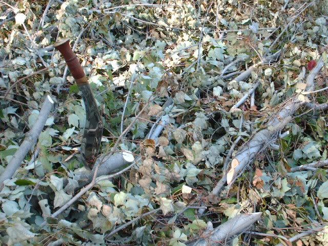

I used my 20" H.I. Ang Khola to chop up this downed tree last september after the big wind storms.
Notice how many of the branches were severed with only one or two blows.
Nice work! That's impressive.
