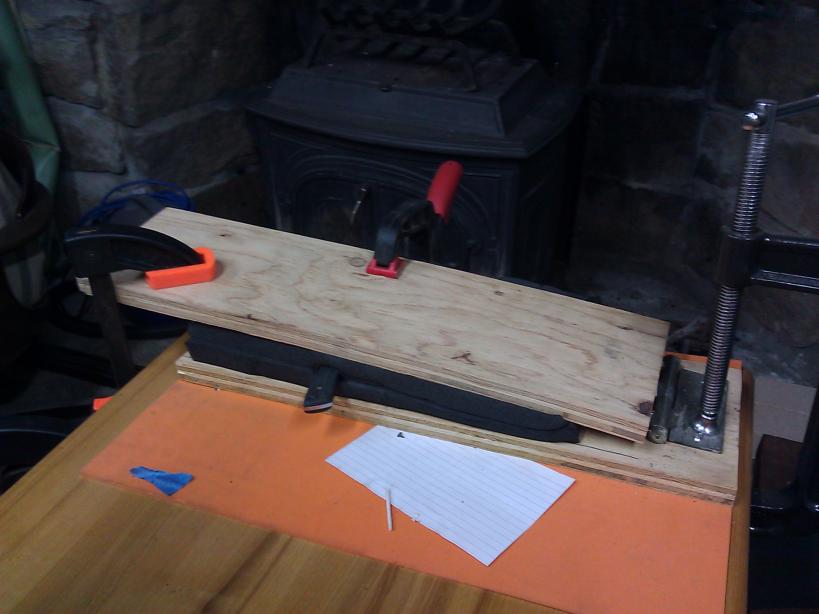

I also dabble in the Kydex, and to press I just use 2 boards, a solid packing type foam, and a vise and clamps. I also prefer something less then .9, unless I'm making a clip. And those are fantastic sheaths! Lol, I'm not so sure I'd post pictures of my first! :p
Messing around this afternoon with the HIPPIE.
The new press worked great.

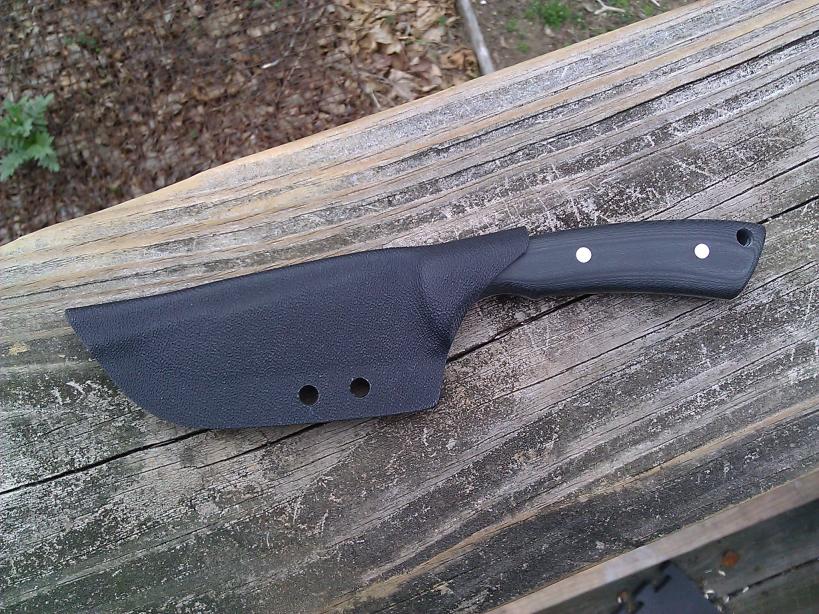

The hippies BK2 sheath.
Did a pretty good job for third sheath ever.
I went with a BK9, BK2, and a mora.
I still need to trim up the Mora and BK9 sheaths, I ran outta time.

Here's mine - I think the speed clamps are the way to go.
I need to cut an inch or two off the end of the top so I can get the speed clamp centered so I need only one - at least on this table...

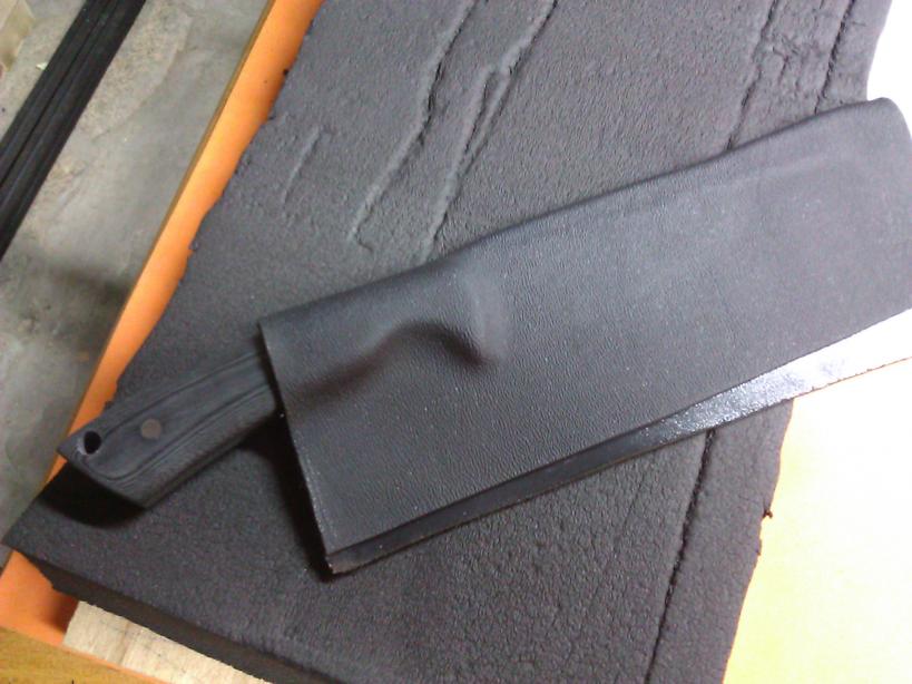

This was really tough to get out... I had to flex it way open.
I had to shape the mouth way forward to get the retention right - it works REALLY well and I love the look. They all come out a bit differently, and this is the first I've done with a finger groove.
I continue to avoid the grommets because I like to be able to flex open, wash, dry, and completely blow out debris with air. All the knives I've squoze kydex for are uncoated carbon steel, so I prefer it that way for now.
You can see with this one that the spine of the blade is not all the way up in the fold the way I wanted it, but it came out so well in the end I'm not re-doing it.

I am rather surprised it came out as well as it did considering that this was more of an experimental test run before I got my arbor press in.
kydex is quite addictive, and the more sheaths you do the better they come out. The mouth is always the critical part. DerekH, although it is looking good so far you would have saved enough kydex for a 2nd sheath if you had folded a taco over the spine after measuring width of blade x 2 and adding an inch or 2 to allow for thickness and scales, but it does look cool so far. Arbor press is not completely necessary, a good hammer and riveting dies do the job nicely. In the same way, I try to keep it simple and just step on the top board for like a minute or the duration of whatever song is playing on the radio, haven't hinged my press yet and dont think I would. A heat gun and belt sander help a LOT with finishing and adjusting mouth retention.
