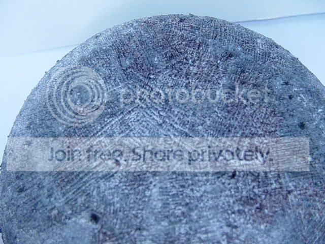

here some dendrites on the bottom of one of my wootz ingots.. ... they look very wimpy compared to that wonderful picture
Greg
