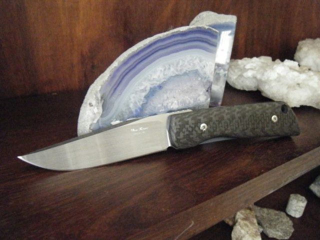

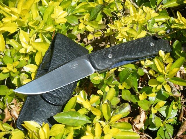

Therefore, introducing my grail…the Imvubu.

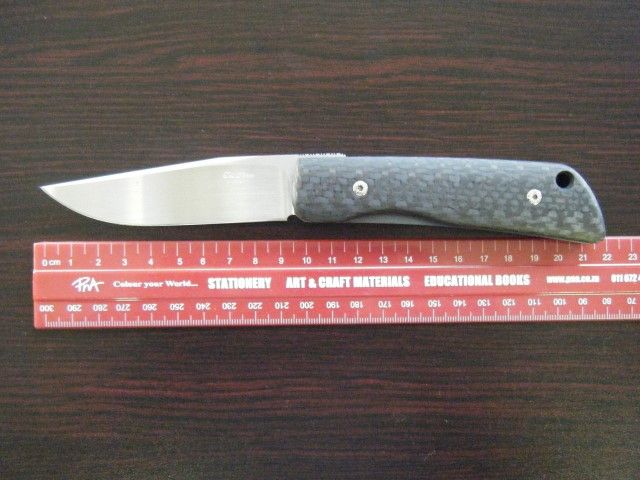

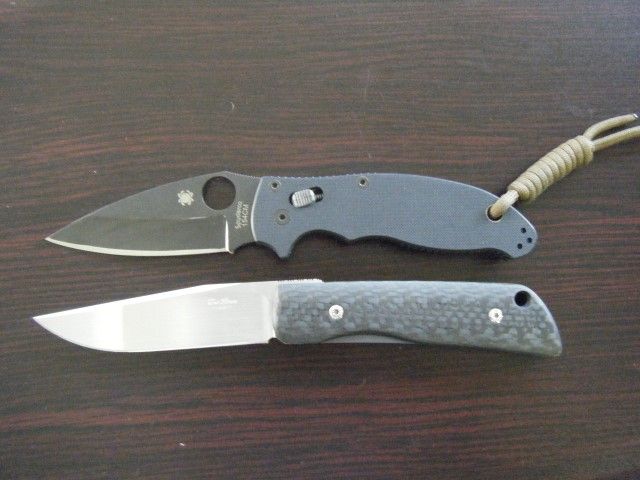

• Blade Length: approx. 4 inch
• Cutting edge: 3.687 inches (94mm). Same as Spyderco Military
• Blade Thickness: 4mm
• Length closed: 4.812 inches (122mm). Same as Spyderco Para Military
• Weight: 3.67 ounce (104g)
• Handle: Black Site Carbon Fiber
• Lock: Liner Lock
More comparison >>HERE<<
• Steel: Nitrobe 77.

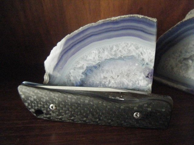

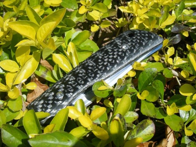

Initial impressions:

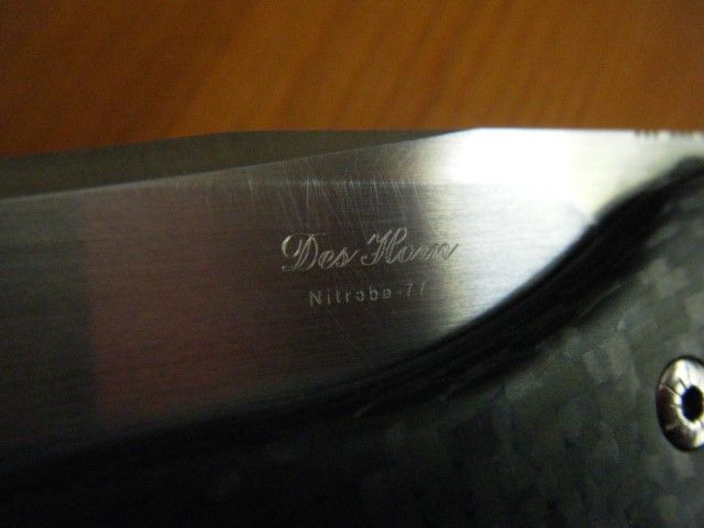

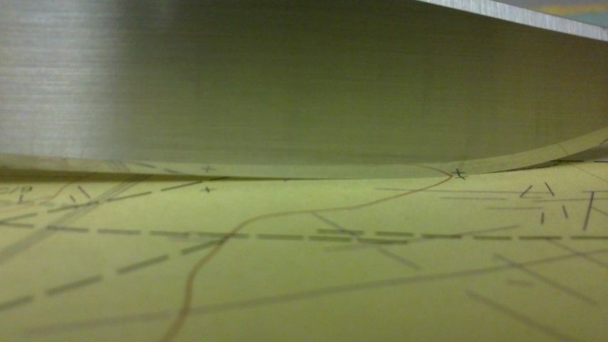

• Deep hollow grind (approximately 5 degrees per side and the hollow drops below that and this is considered a rather strong (thicker than normal) edge).
• 15degree per side edge. Less than 1mm (0.039 of an inch) wide.

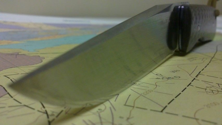

• Highly polished edge (mirror finish, though Des Horn did mention he prefers a more toothy edge. I believe Des sharpens the knives by hand).

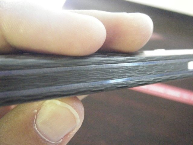

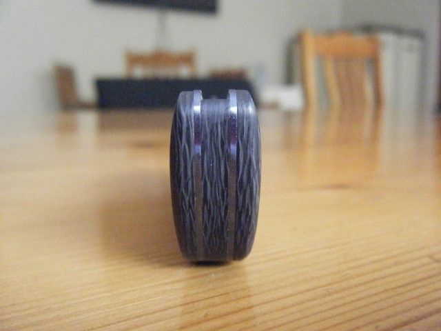

• Grip is surprising as it has some traction to it.
• Contoured grip and lack of pocket clip feels great.
• No real curves to the handle shape, personal preference that I tend to prefer.
• Lip opening, another personal preference.

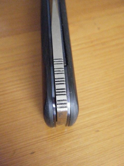

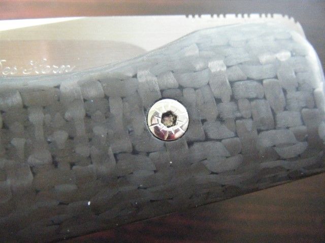

• Jimping is in a nice 3-gap-3 type pattern. Gives good traction.
• Details on the screws for the handle are something I like. To my knowledge Des hand mills everything himself.
• Lanyard hole is big, no one should have an issue getting any type of cord through there.
• Not a flow through construction, once again, I like that.
• Cant adjust the pivot from what I can tell, but the action is that smooth hydraulic feel.
• Solid lockup.
• Silicon Nitride (Ceramic?) ball detent.
• Hand rubbed satin finish is even and looks great to the eye.
No photos of the knife before use. The above I took today.

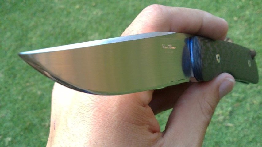

Stock testing:
• Initial sharpness is very high.
• Pushcuts newsprint at 90 degrees
• Shaves arm, beard and head hair &#61514; in either direction – no burr on edge
Video of some use and some thoughts (it is a long video guys and the sound quality did suffer a bit):
[video=youtube;GCITlARJvcY]http://www.youtube.com/watch?v=GCITlARJvcY[/video]
To recap:
• The knife is pleasing to the eye and cuts well with little hotspots
• Edge shows minimal to no edge deformation (rolling or chipping) after extended use
• The shaving sharp edge was lost after abrasive use through cardboard
• The slight drop in the blade making it lower than the handle, similar to that of a Spyderco Military.
• Did not crack open hard food such as apples, potatoes etc. Clean cuts.
• Though I tried to compare it to H1 (corrosion resistance) it dawned on me that Nitrobe 77 “feels” on the stones like 52100. Imagine something like 52100 and H1 had a love child.
• Ease of sharpening is high. Sharpens very similar to 52100
Now, it is due to my uses that I have concluded minimum edge thickness and minimum edge angle will give you maximum cutting ability/ease of sharpening/minimum fatigue/maximum control/ maximum pleasure and comfort when doing my specific chores. However, there is some balance that I want between the above mentioned performance and coolness factor. I enjoy a high performing knife, but I can also appreciate a craftsmanship piece.
I believe the Imvubu, for me is the balance I want.

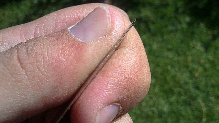

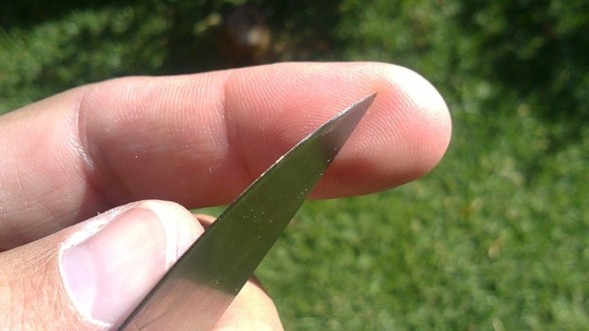

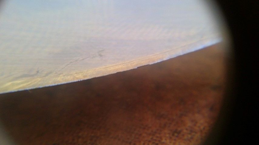

An update.

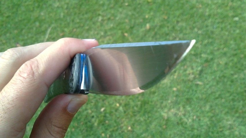

I have been EDCing the knife non stop. Used for multiple tasks, one of which was to use it as a scraper on a plastered walls. Due to the texture of the wall it had hills of cement. This did its due on the edge, of coarse I did not baby it and continued to use it for all manner of tasks. At the end. This is how the edge looked where most of the work was done.
As you can see I did a number on the edge.
So, pulled out the stones, destressed the edge, reshaped the edge and dropped the angle a bit. I used a sharpie to help. My eye coordination did not work that well when I did this. Took around 5 minutes to remove and reshape the edge.
Went onto the Spyderco UF stone and this is the result.
After that the knife was used again for some time until I decided to reprofile and drop the angle to as low as I could. Edge is around 7 degrees per side. Took around 15 minutes to reshape the edge, remove any microbevel and polish the edge to mirror.

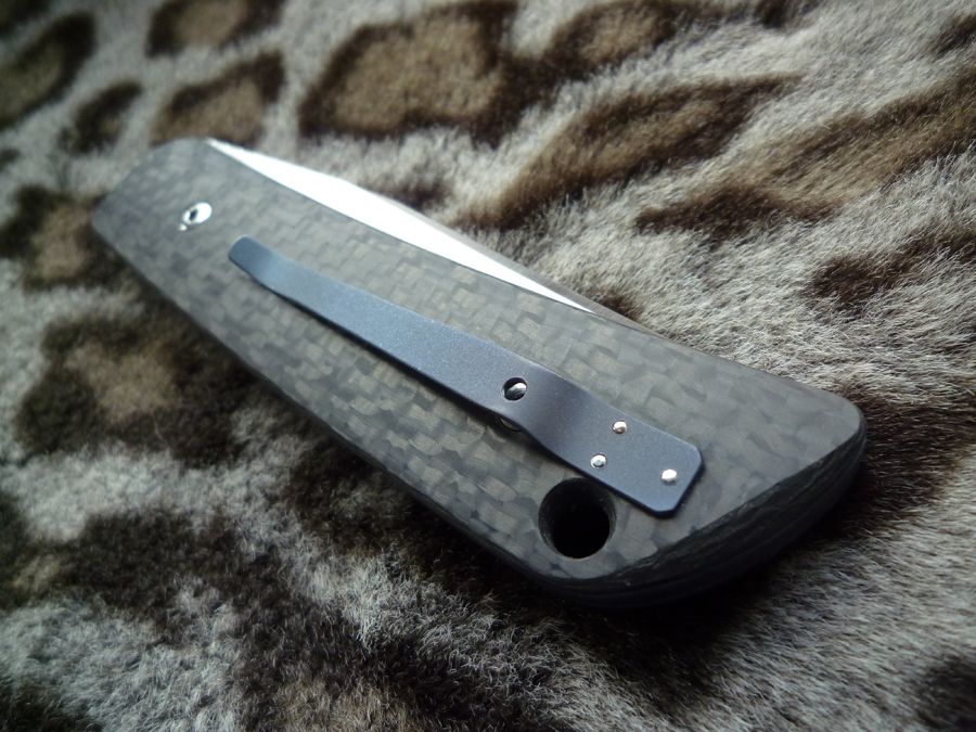

Nice review, and the steel sounds interesting. Knife is pretty nice looking, though not honestly as eye catching to me as a lot of other blades. And the lack of pocket clip is a HUGE strike against it for me-if a folder has no clip and isn't a keychain knife, it will never be carried by me.
When you mentioned it in another thread I was going to ask you to post photos, so I'm glad I stumbled on this thread.
I think it is an attractive knife, although I myself have passed on similar looking customs because of a lack of pocket clip. Maybe that is something I will re-look, especially as I have a couple of non-clip traditionals incoming in the mail.
I have also been interested in the performance of low carbon steels and much appreciate your testing and commentary. Well done.

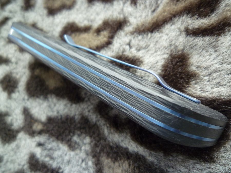

Thanks for the kind words. Not all knives will appeal to everyone. Thank goodness we have so much to chose from. See below for pictures and details on a clip.
Great looking knife man. Des knows his stuff for sure. Congrats.
Glad you found the thread.

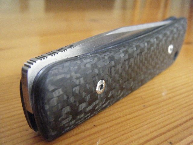

The thing I do when it comes to custom knives is ask questions. That is the advantage of custom knives that one should explore IMO. Ask the maker about handle shapes, materials, screws, lock, clip, steel....pretty much everything. At the end one should try to get the knife you want. That is the advantage of going that direction.
Sorry, a bit off the path, back on topic. Here are a few pictures from Chui over at British Blades with his RWL34 Imvubu and pocket clip. You will notice that the pocket clip is screwed from the inside of the handle. Similar is done by Bob Terzuola to my knowledge. It creates a cleaner look IMO.
