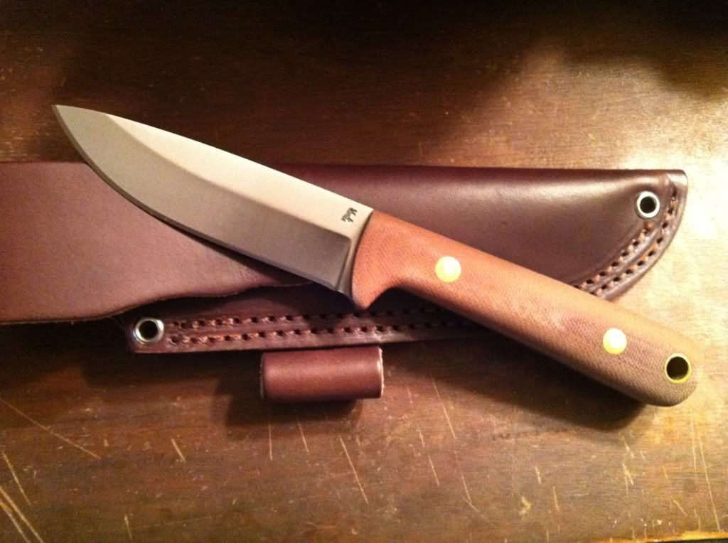

I 2nd the blades of the above (4th and 5th pictures shows it nicely), a pointy spear point, not so much a Kephart point if that makes sense. 4 to 4 1/4 inch length and 1 inch wide , similar handle length for better control overall. Full thin tapered tang or heavily skeletonized. If tapered than the scales "have to make up for it". Maybe just good quality epoxy with no bolts at all (for weight), if bolts than I then G10/Micarta. A rather oval shape handle with a bit contour, distal scale taper as a "thumb rest" in different holds. round butt (using as a drill with palm on top) and a lanyard hole. Tiny guard (only to know where I am). 52100, A2, O1 or 3V. If scandi grind then 1/8 thick, I'd prefer a heigh zero convex on 5/32 though. Rounded spine (I always use a steel and scraper), no filework for me. I would prefer simple grippy Micarta (Maroon Linen Micarta?), if wood than Desert Ironwood or Cocobolo (less maintenance).
Here are my two favorites when they were new. First one is my hands down favorite. I think you know the specs.
I also like this one by BHK, but I don't take it out very much since I got the JK CBK. 4" saber ground blade with convexed edge. 5/32" thick. 4 3/4" micarta handle.

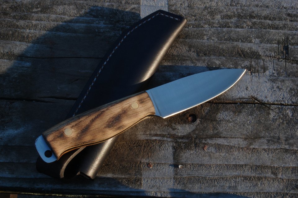

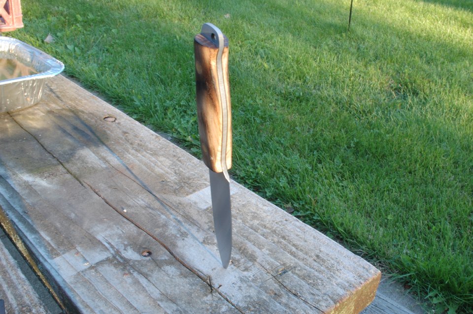

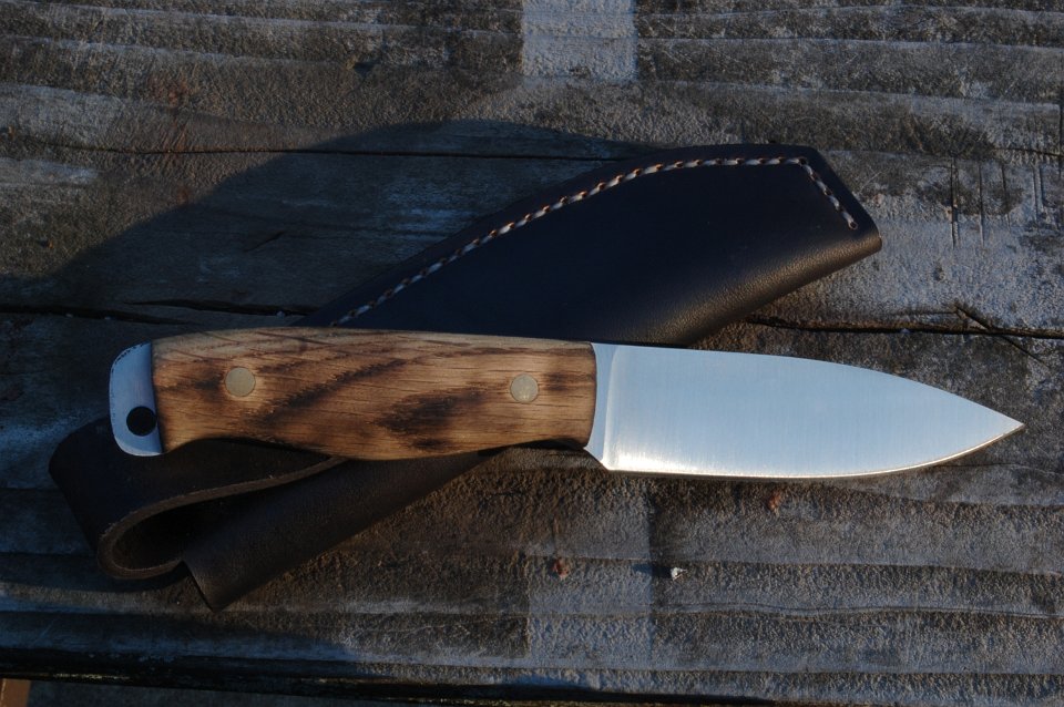

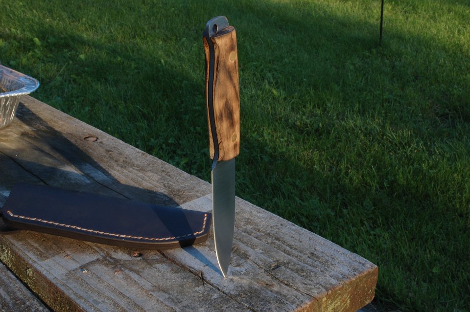

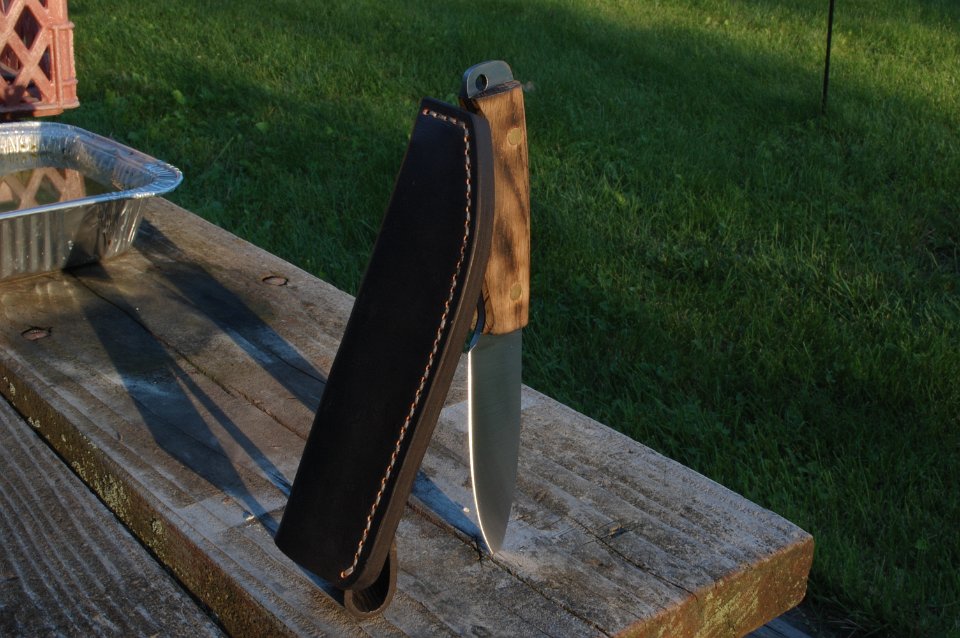

Hi folks -
This evening I was delighted to find a package from Mokena, and inside was my new Mack Designed Rule Number 9!!
I asked John to make this knife with his torched oak treatment, so that I have a classic design from one of my knife friends (Mack) with a classic treatment from John.
John used to do a lot more torched oak, and I think he does torched oak better than anyone!
This particular knife has a couple of changes from Mack's standard design.
I asked John to round the spine and delete the thumb-serrations. I also ask John to grind the choil all the way down to the handle so that the blade was sharpened all the way with no unsharpened choil area.
I think he did an outstanding job, and the sheath supplied is the best example I have in terms of finish from the JK Shops - the stuff just keeps getting better and better!!
I took some quick pictures this evening for my friends here -
Note the black liners -
Just look at that sheath!
Perfect grinds as usual!
Thanks again John for a great knife, and Mack for a great design!
