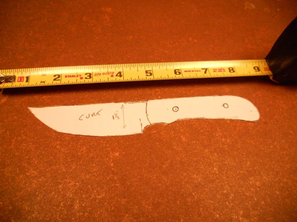

I sent John my drawing and cutout of what I think will be the perfect knife for me. I am on the list for March for it. maybe John will be so kind as to post a picture of my drawing. I don't have the means of doing it.
Cool. I hope John puts up a pic. I'm really interested in seeing it.
My tastes have changed so much in the few years that I have been hanging around here, I'm always open to new and exciting things.
I can`t download the drawing, I will try to get a picture of the cutout, probably tomorrow. Going to the hospital again today.
Thanks John. Please give Hanna a hug from us.

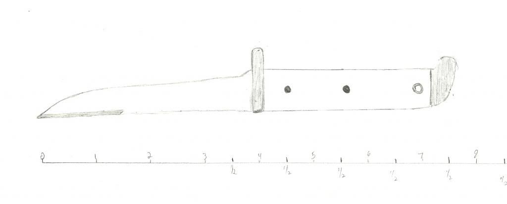

My knife ( for work ) is based on a western 628 bird knife, a few changes but same knife just larger. I got one of these knives a few years ago that I keep in my shop just for use around there and its shape and size are fantastic. I probablly would carry it for work but the sheath is messed up bad and wouldnt hold up to what I do. Its a nice straight knife and fits my hand good so I have a lot of control. Grind would be up to John and the bottom part of handle could change but I like the shape the way it keeps my hand is place. I would like to have orange or yellow micarta and if I had 2 made the second would have snakewood. anyway here is my idea...
I have often imagined a knife like that with John's heat treat. I think it would be a sure winner.

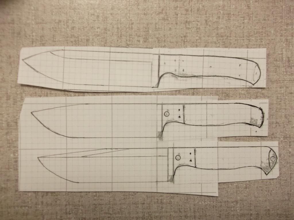

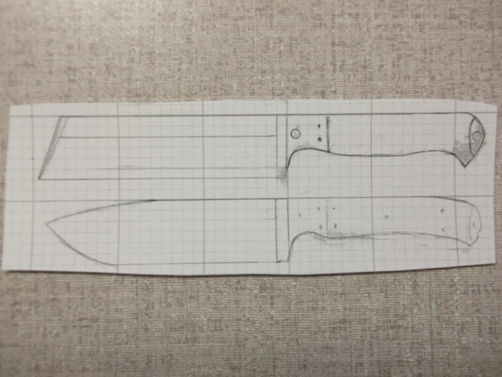

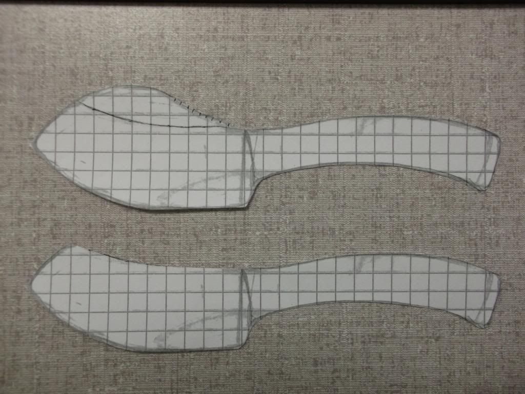

Not my "perfect knife" but some I would like to get made some day:
Mucks (with and without hump):
5.5" Bushcraft, 5.5" camp knife, 6" tactical:
6" (may get longer) Chopper (which I would like to name Stomper Chomper if it gets made), and another 5.5" Camp knife:
nice designs guys.
i saved a "just in case" copy of the cutout that i sent to John for my march order (camp-style knife). i took a pic this morning and went to upload it, and it wasn't on my phone. i think i put it in "sleep" mode (or whatever you call it) before the pic saved.
i think i already have my "perfect" all-around knife in the VT Hunter. haven't found anything i don't like about it yet. the custom camp will be my "big" knife. i would also like to do a fillet knife, at some point. i think that would about cover my bases.
cool thread mack. i'll try to really take pics tomorrow.
Nice design, Curt!~

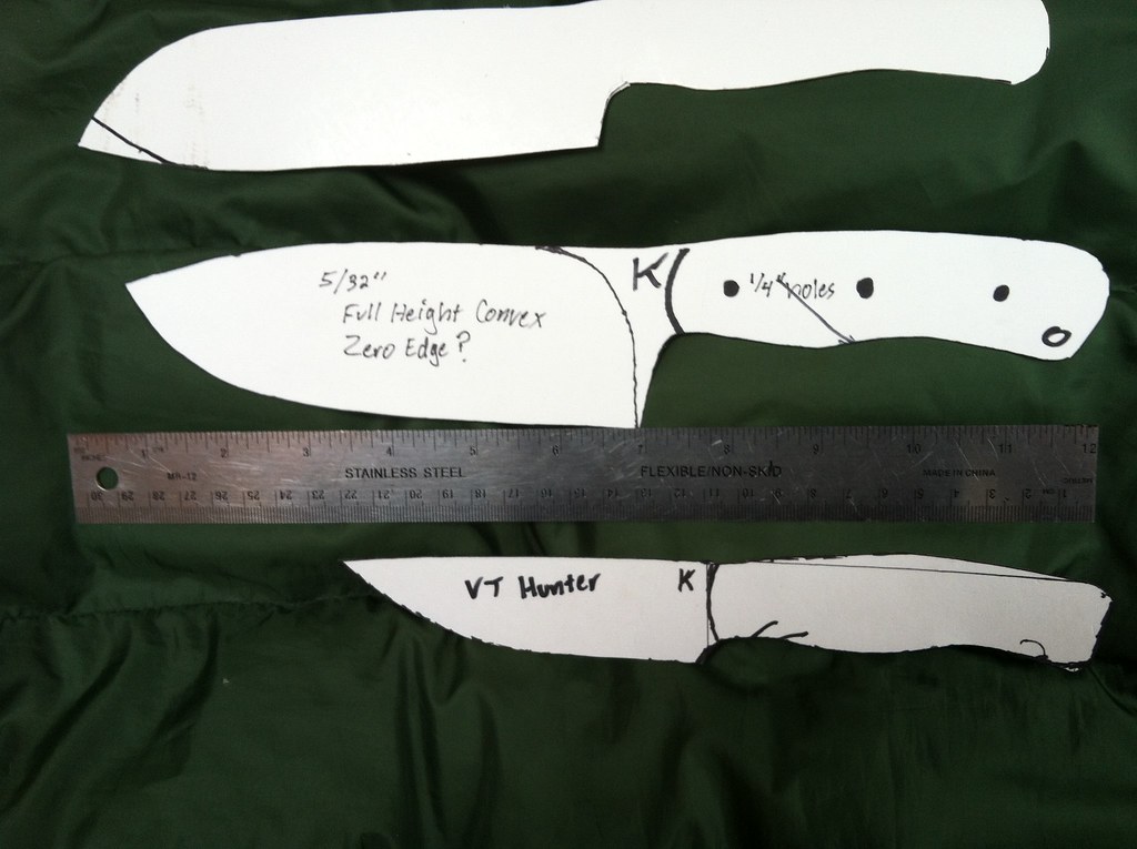

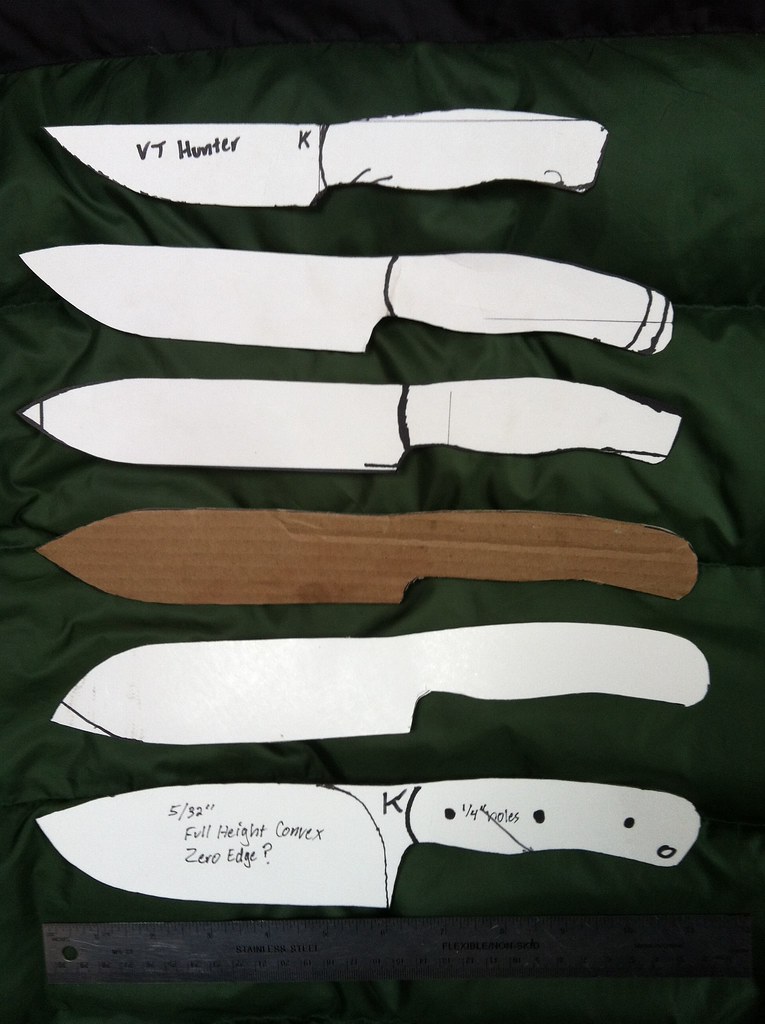

Ok...i stopped at my place at lunch and got a couple pics. i found a bunch of cutouts i still have that show my thought process i went through with the new design i sent John.
Let's read from the top and progress down. Starting at the top is the design i had for the VT Hunter. I wanted a big knife, so #1 cutout (just below VT Hunter) shows the same basic shape of the hunter, but extended.
#2. i decided i wanted to see what a spearpoint would look like.
#3. the cardboard one shows essentially the same shape as #2, but i wanted to put more steel toward the tip for better heft when chopping. i also added some thickness around the first finger groove.
#4. I wanted to see what it would look like in more of a sheepsfoot blade shape.
#5. this is the final design i sent to John. i decided i didn't want to worry too much about chopping. and, #4 reminded me of a kitchen knife (santoku style). and, thinking about the kitchen led me to extend the blade well past the handle to give me room for my fingers. the cutout says 5/32", but i ordered in 1/8".
and, here is a closeup pic of the new design with its companion, the VT Hunter.
