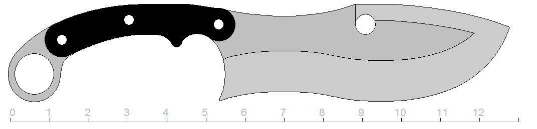

The RC9:
9" cutting edge. Bow drill divot. Thumb cutout and choil for more control on finer tasks.

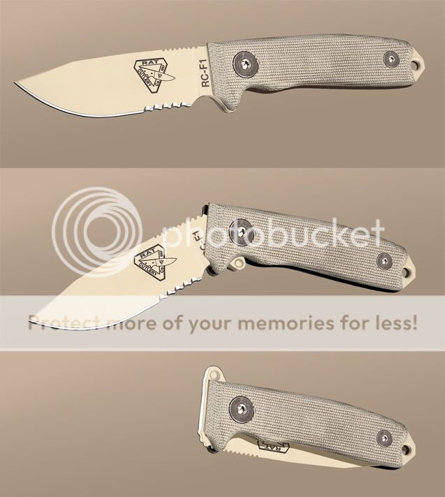

:D a nice and simple folder that should be easy to clean.
Length open: 7 1/2 inches
length closed: 4 3/8 inches
blade length: 3 1/8
Blade: Coated 1095 or CPM-D2
Foliage green or OD G10 scales: nice feel and strong
Stainless steel frame lock: frame lock should be one of the easier locks to clean
flipper: I know some people don't like the flipper, but you don't have to worry about a thumb stud or disk falling off or getting loose and you don't have to worry about cleaning gunk out off a hole in a hole opener.
Open back design: With 4 back spacer pins and not a solid back spacer it should be plenty strong enough and still easy to clean.
The clip: a four way low riding clip would be nice.

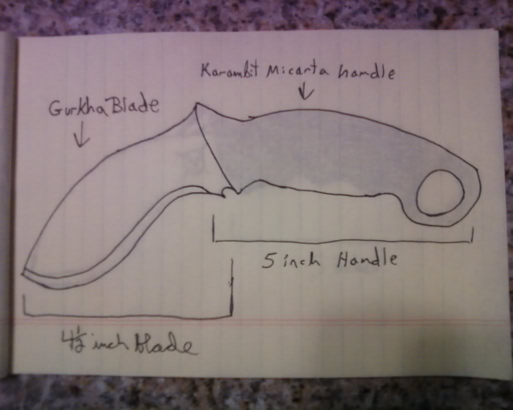

A karambit handle (offering safety) with a ghurka blade. The ghurka blade is forward weighted. The arc in this design puts the blade in front of the swing, ensuring that the blade will be accelerating at the point of contact. The combination of the the two make it an incredible cutting tool.
