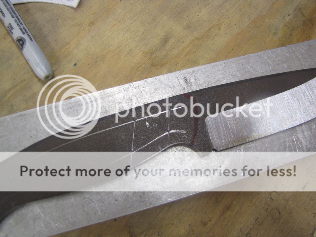

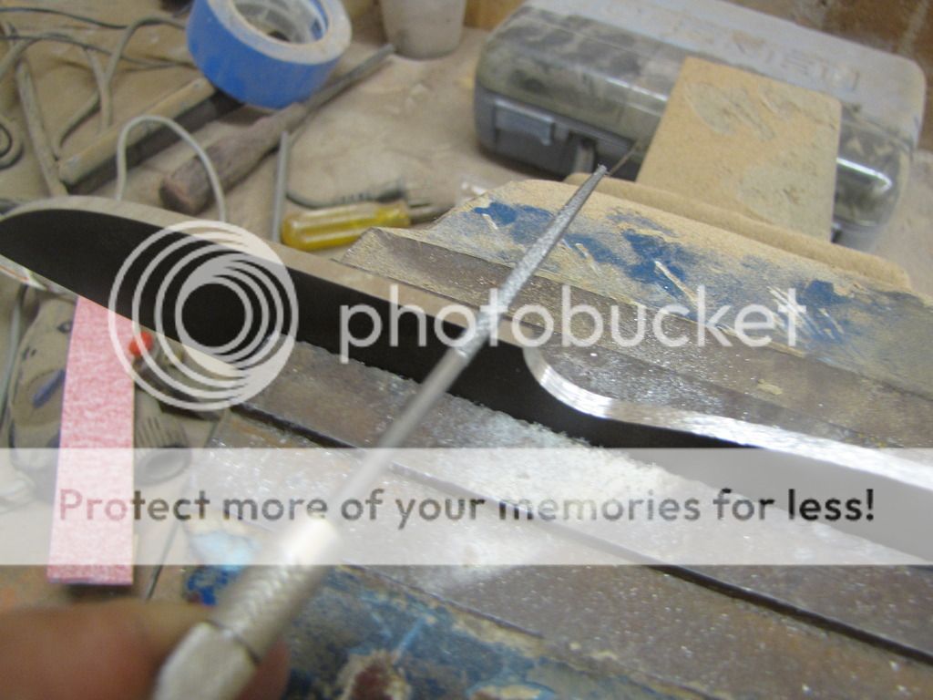

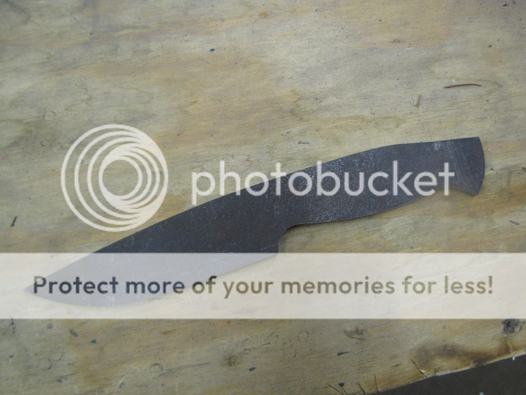

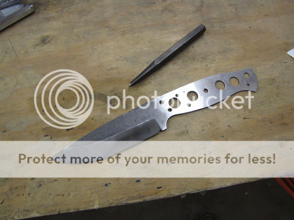

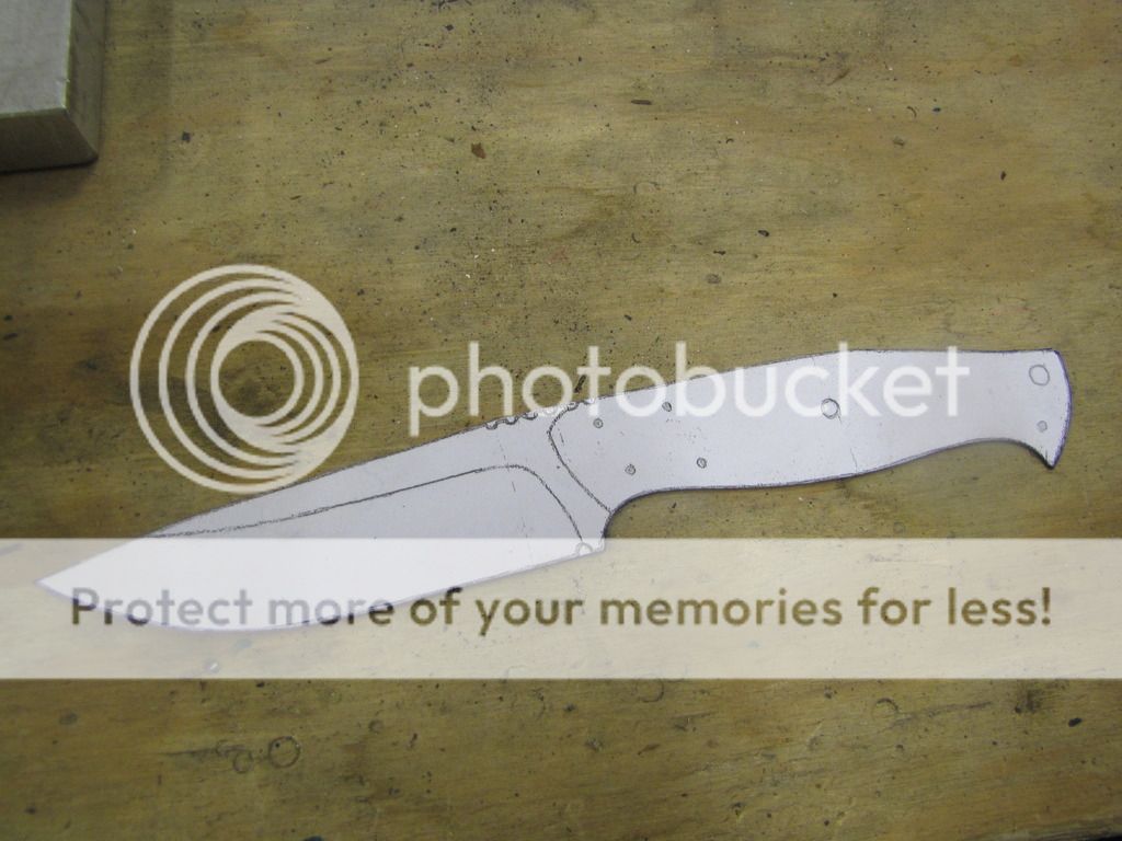

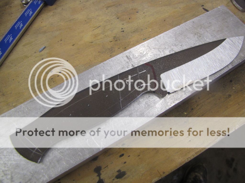

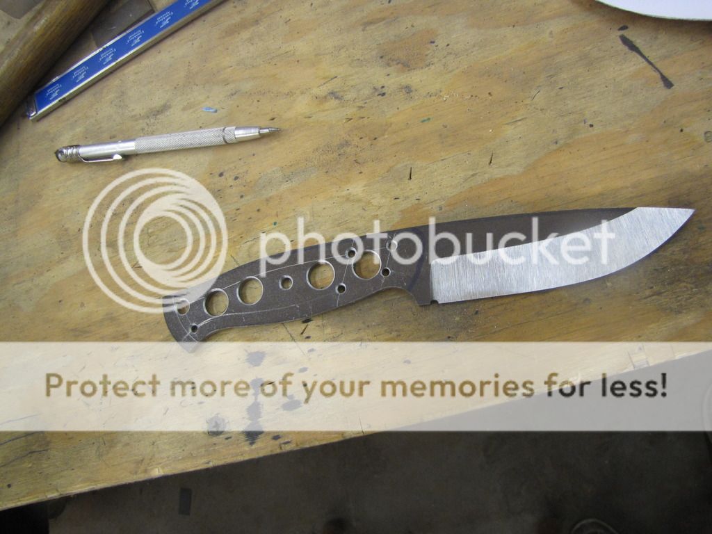

First step is to profile the blade

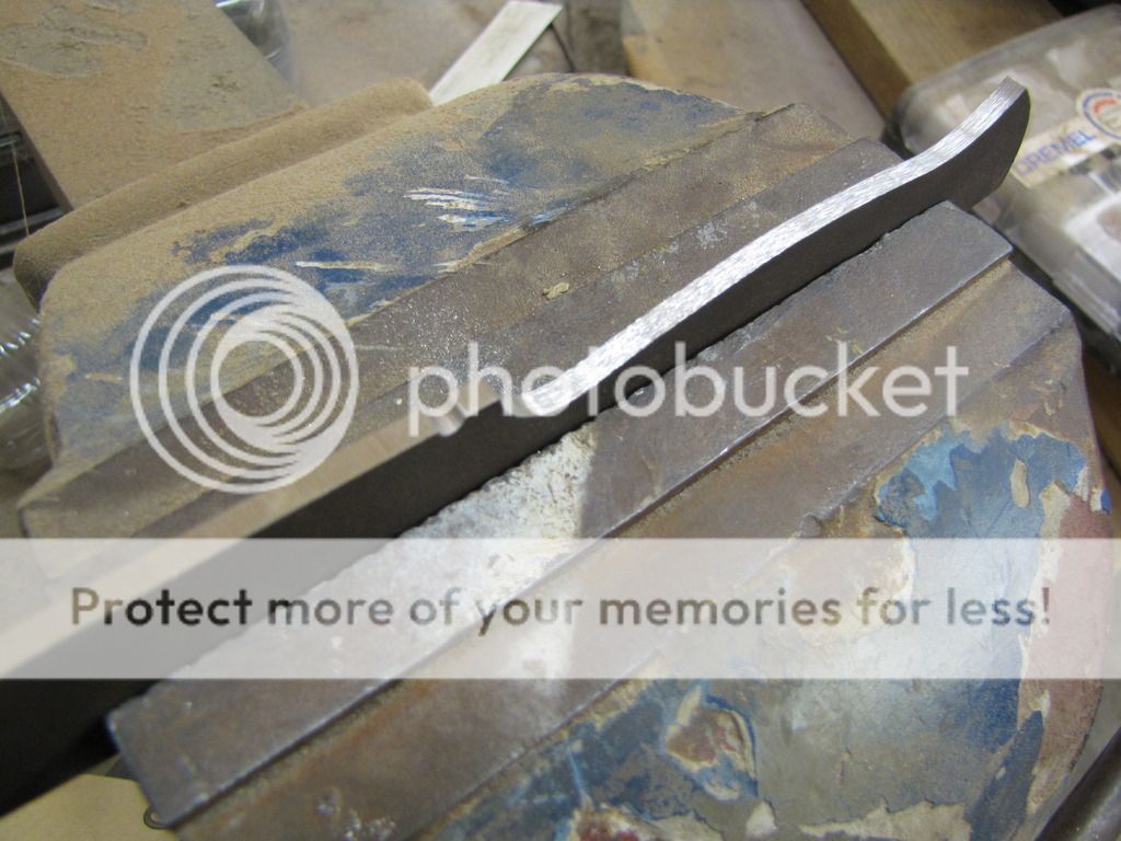

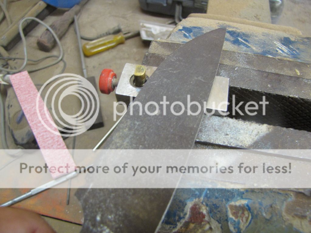

Filing in the sharpening notch

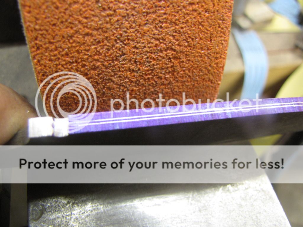

Scribing the edge
This is about how thin I want to go before heat treat

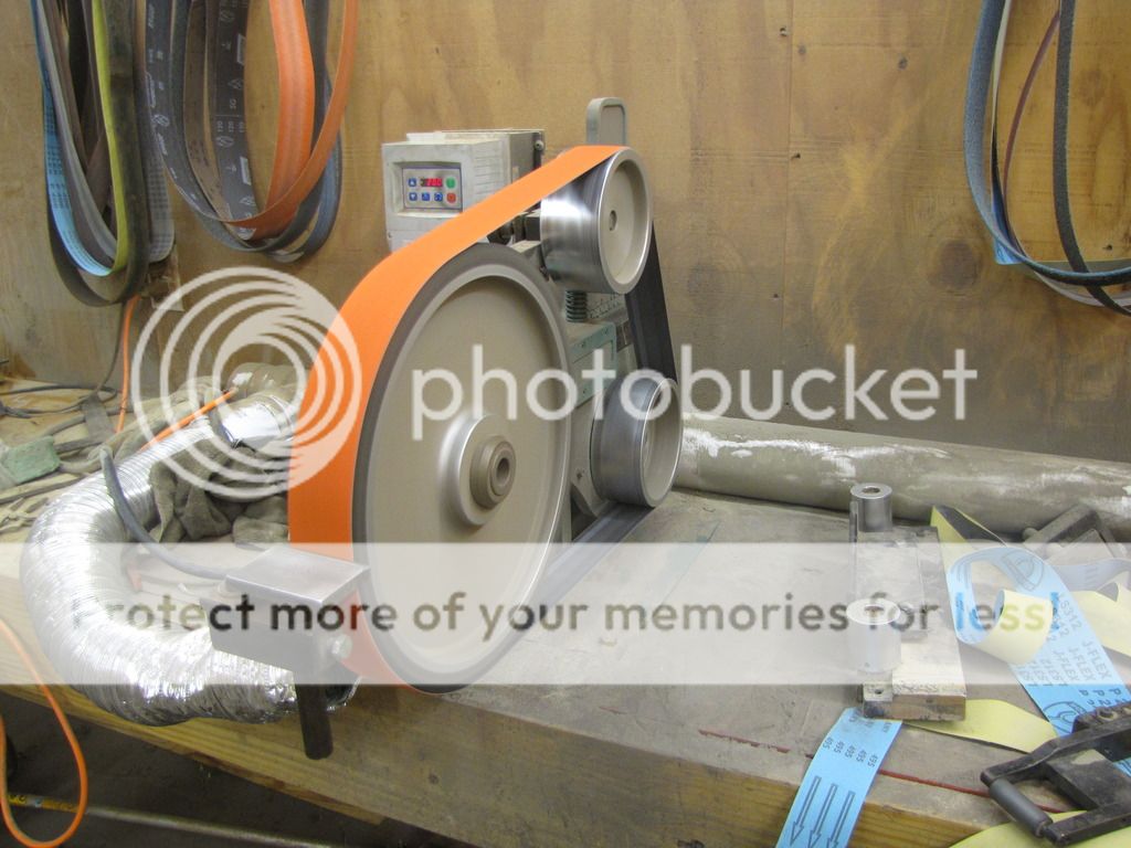

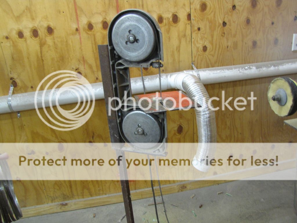

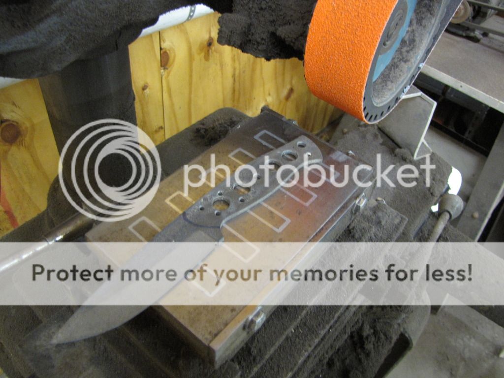

Starting up the grinder
Bevels have been rough ground and then cleaned up to 120 before heat treat (hard to tell)

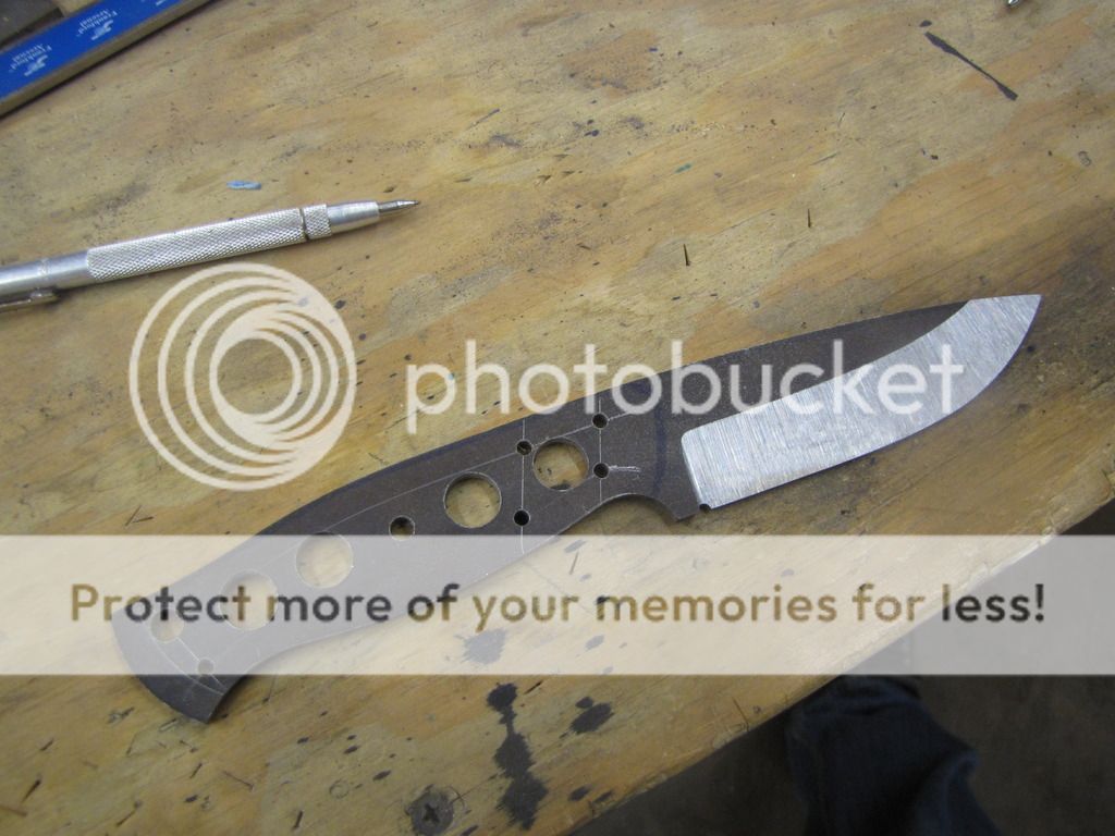

Next I mark where I want to drill my holes
Holes have been marked and punched

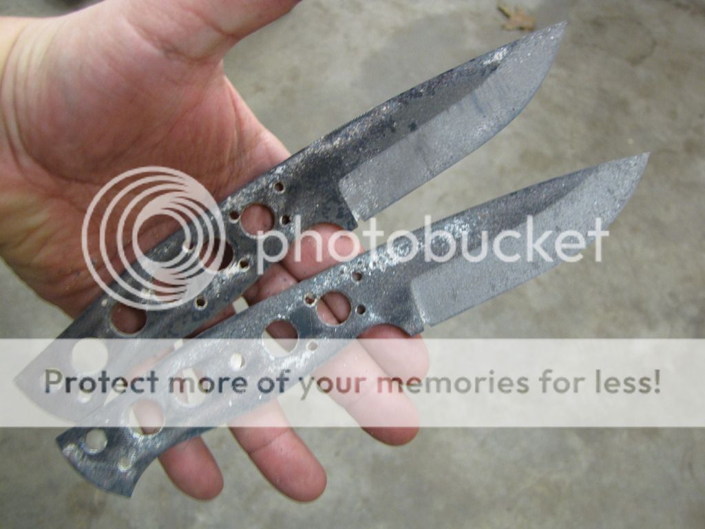

Holes are drilled and then chamfered

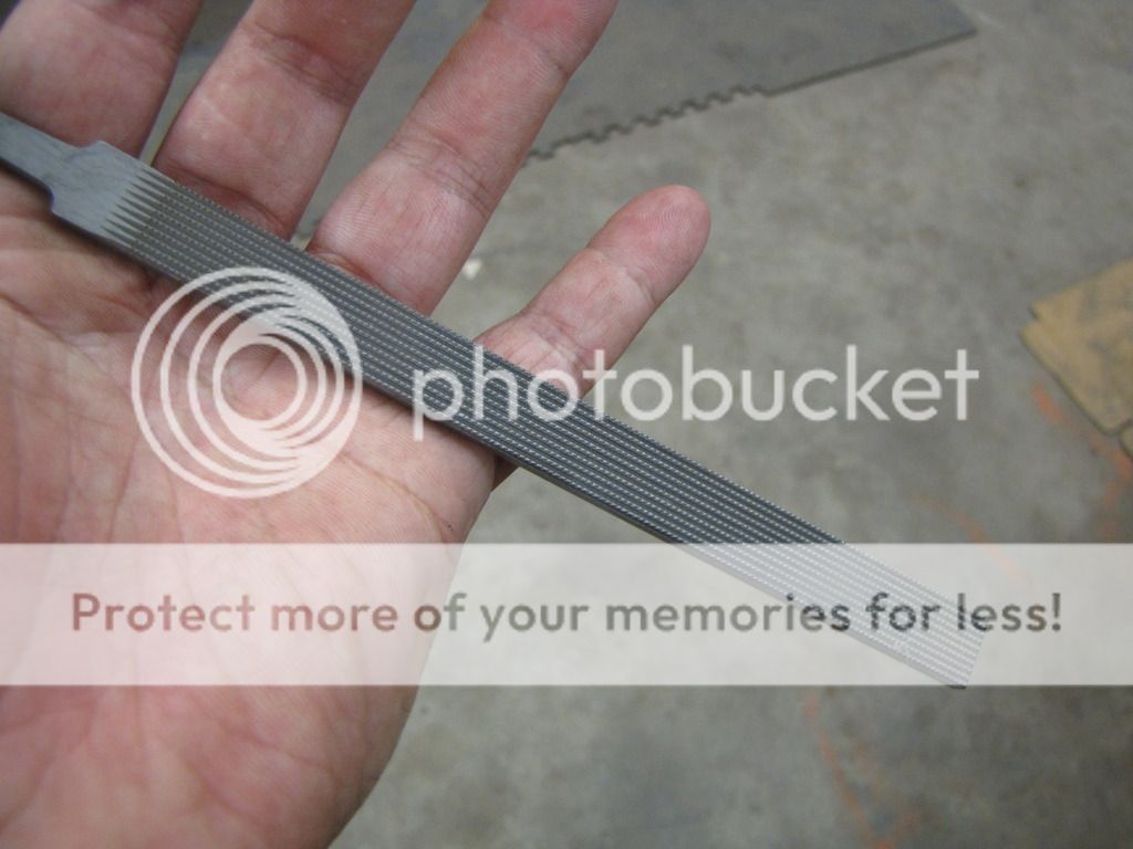

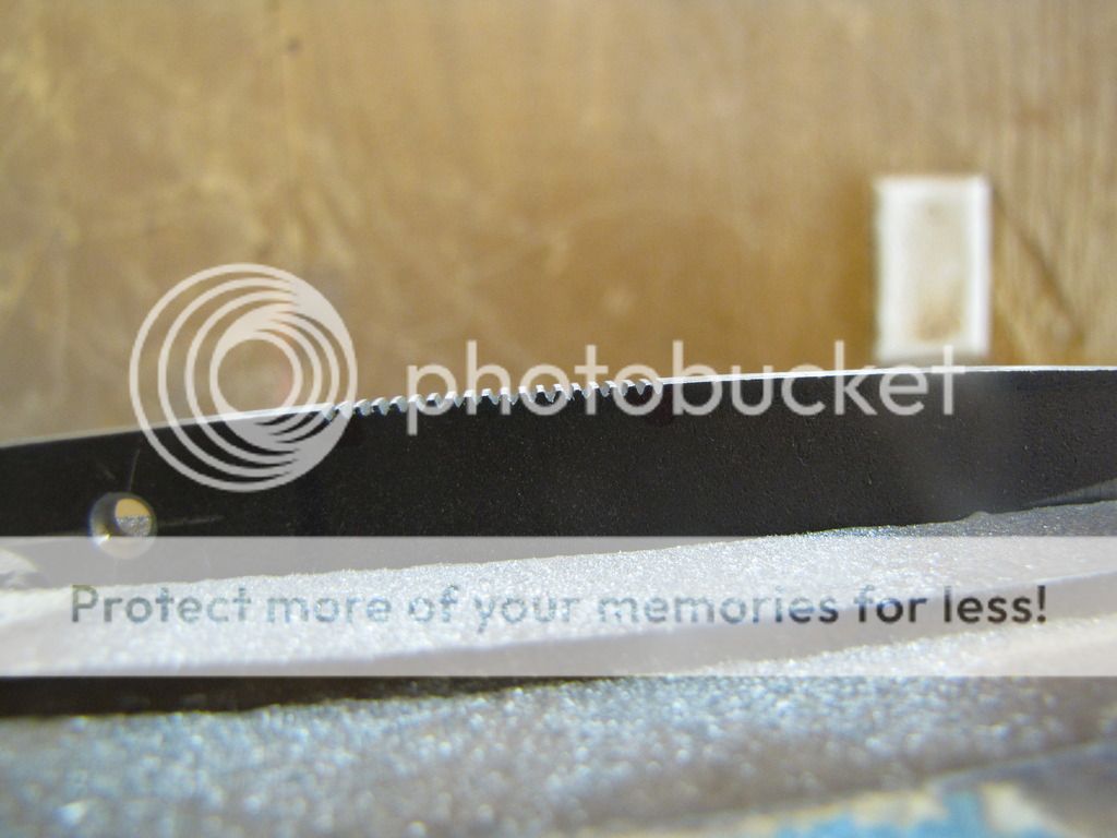

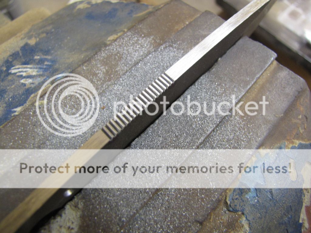

Marked where I wanted the jimping
I decided to go with a finer jimping pattern than the drawing. It still serves it's purpose and I can be much more precise with a checkering file

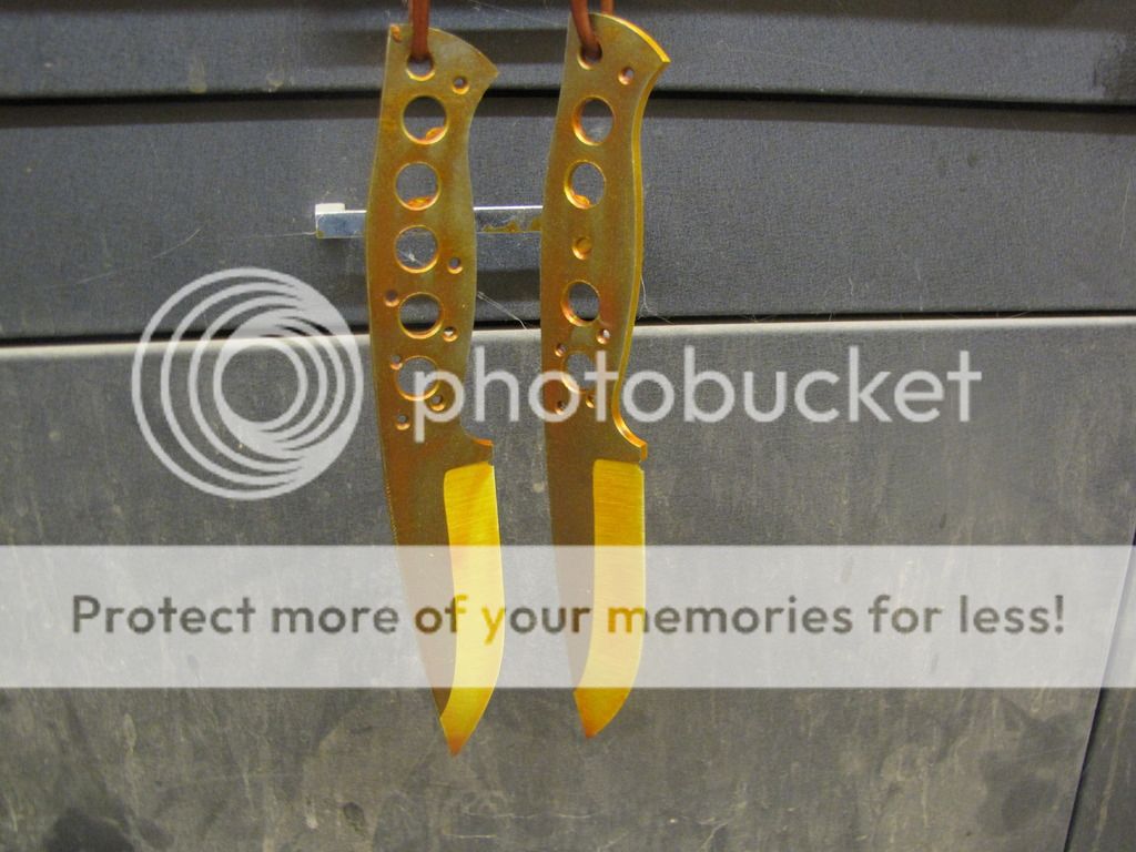

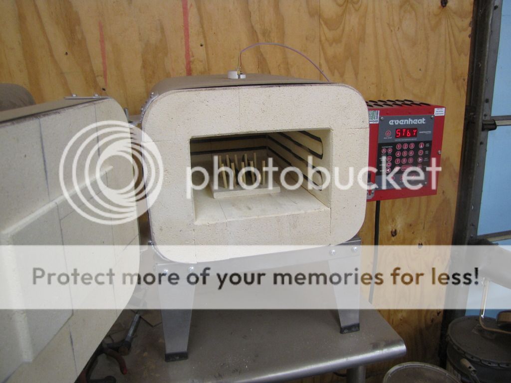

Decided to make 2! Blades are dipped in turco before heat treat

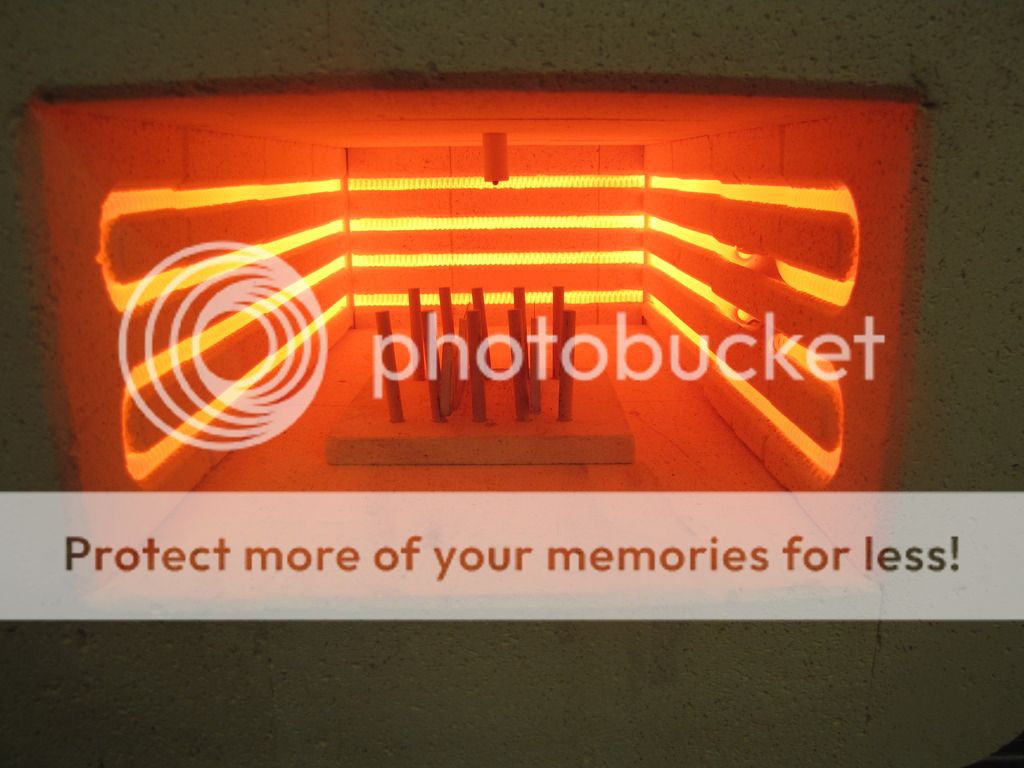

Into the evenheat they go
Oven coming up to temp

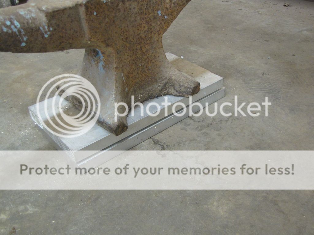

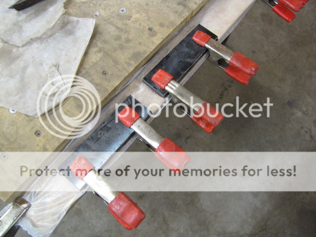

After the blades have soaked in the oven at temp it is time to quench between the aluminum plates.
The blades go from 1900+ degrees to being able to handle them in a matter of seconds

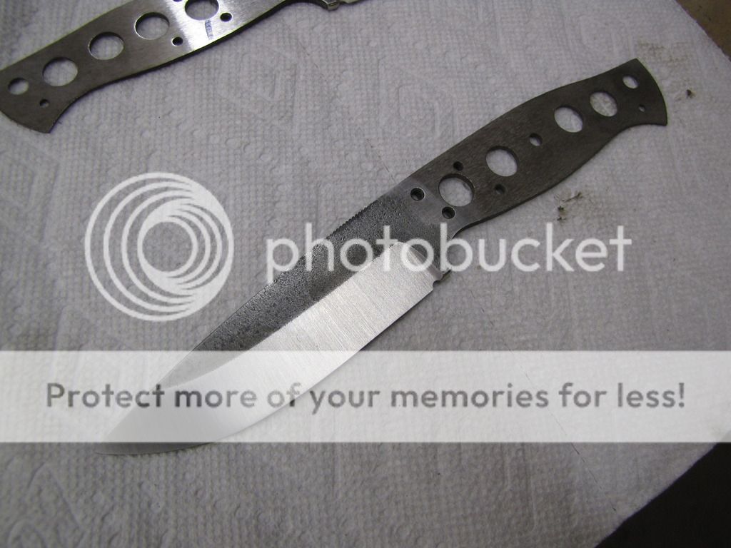

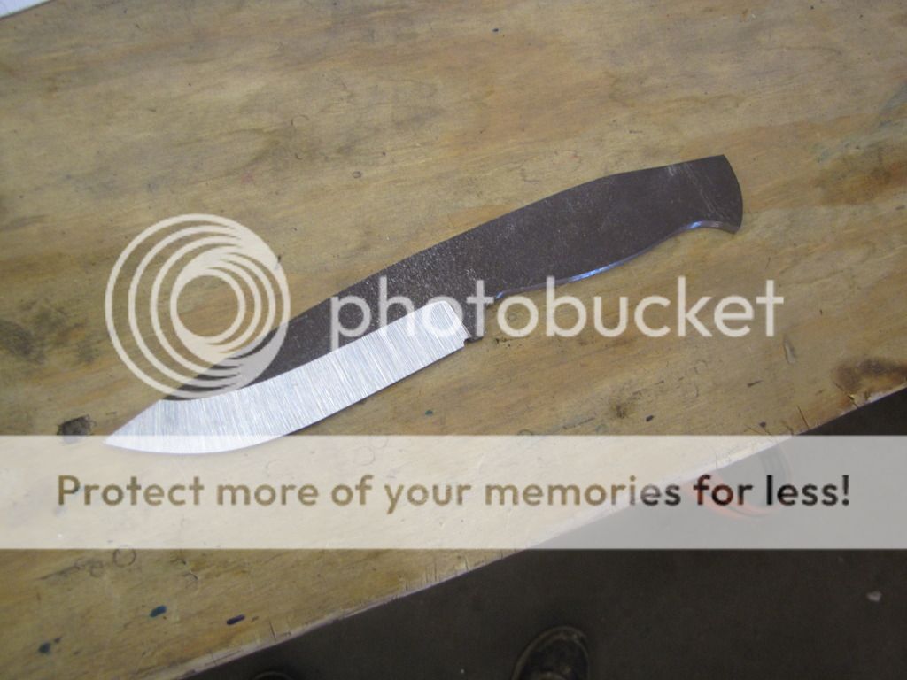

Here they are after hardening
After quenching the blades go into my secondary oven for 2 tempering cycles

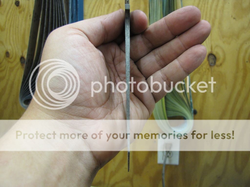

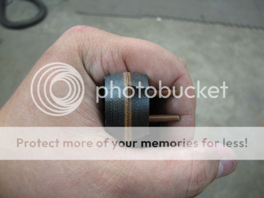

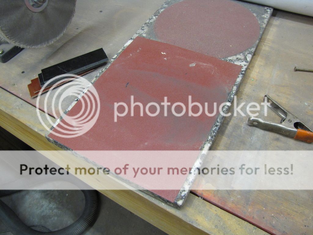

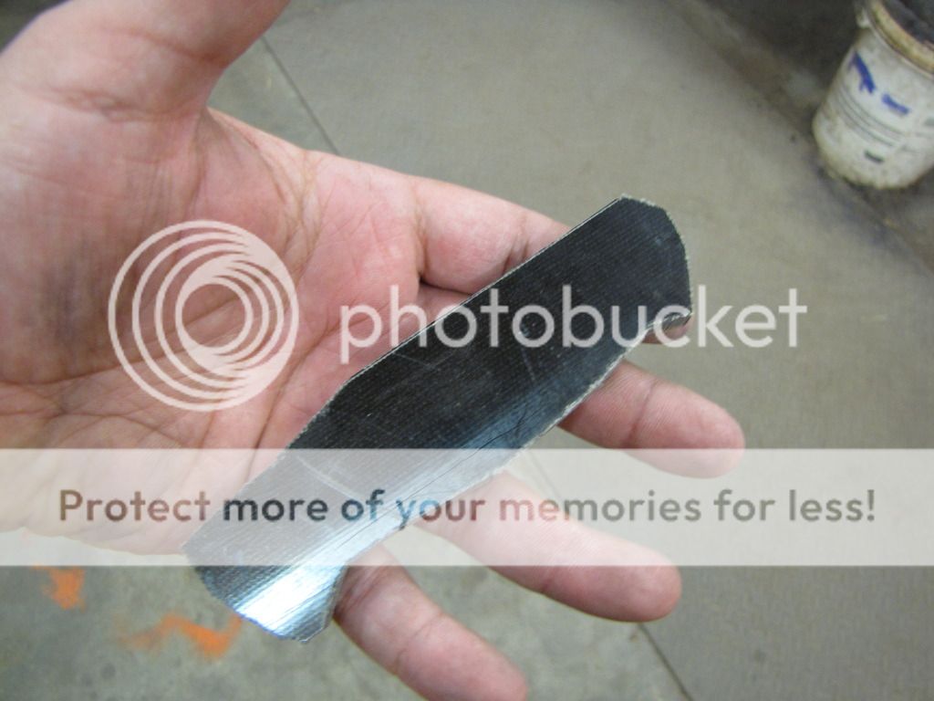

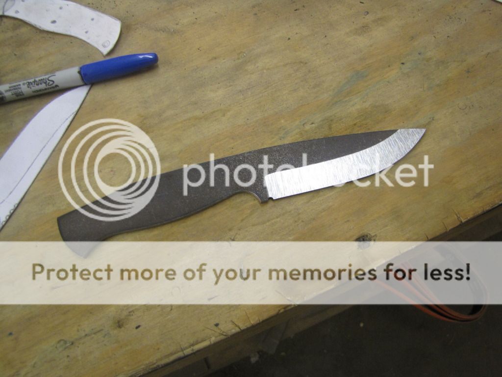

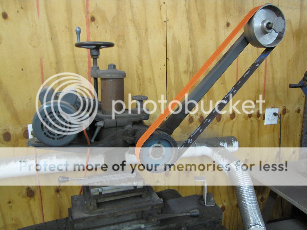

After tempering the blades I tapered the tangs. I prefer to taper tangs using my surface grinder

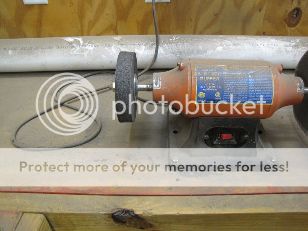

Then I clean up the flats on the scotchbrite wheel
The bevels are taken to the final finish

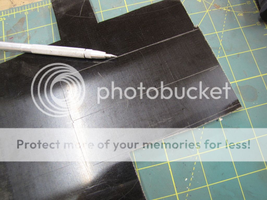

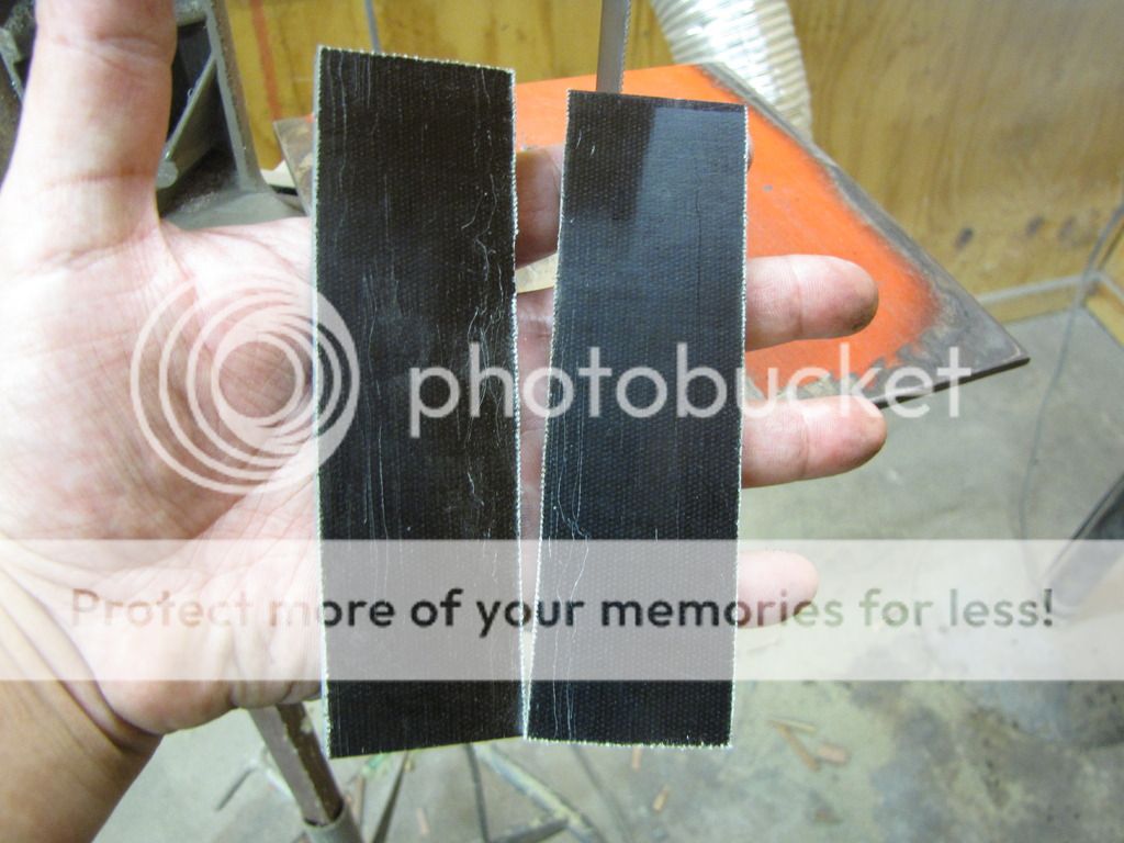

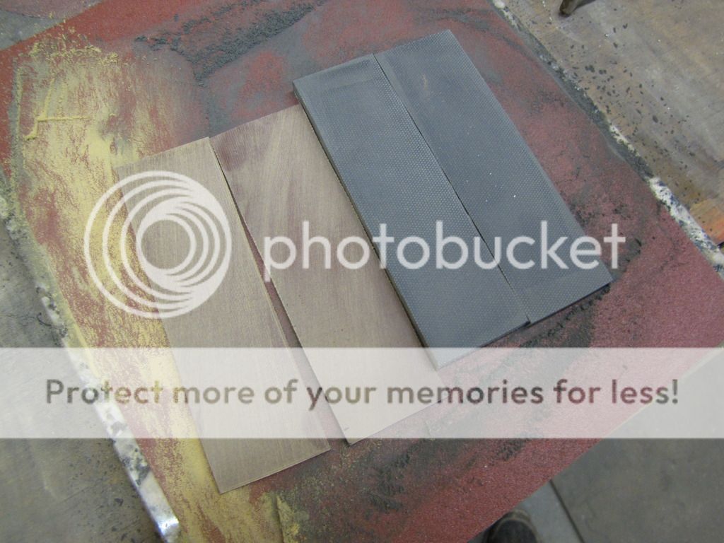

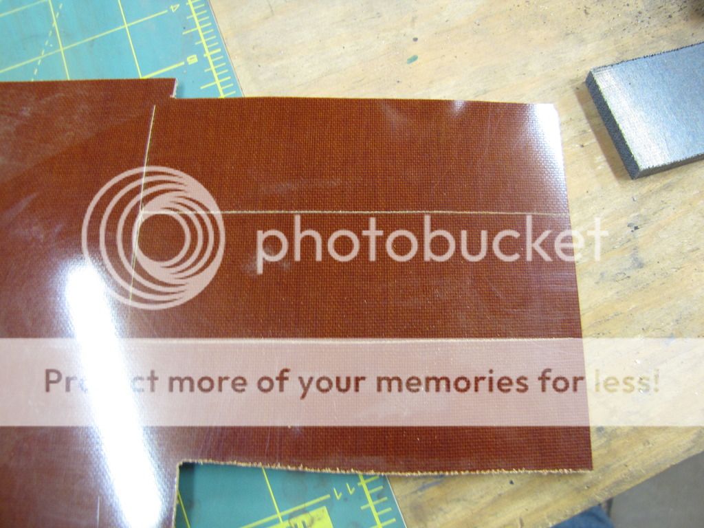

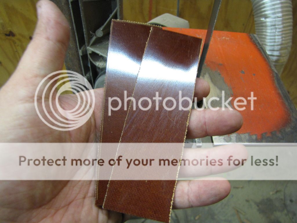

Time to cut out the liners and handles

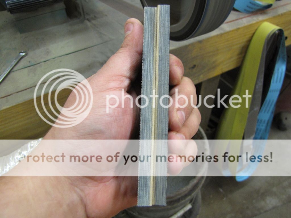

The liners and handles are flattened and surfaced prepped for glue up

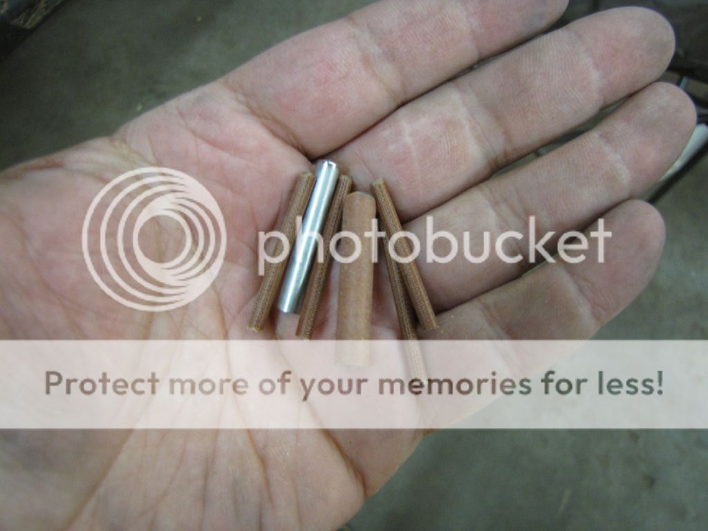

Scales and pins are cut out

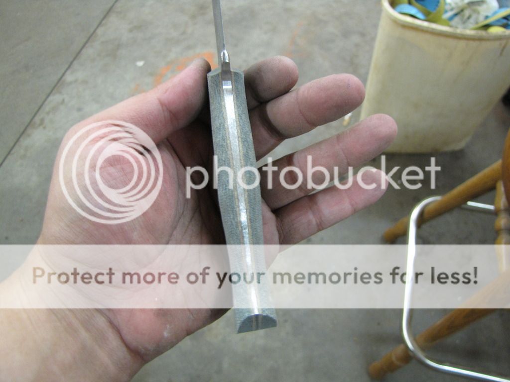

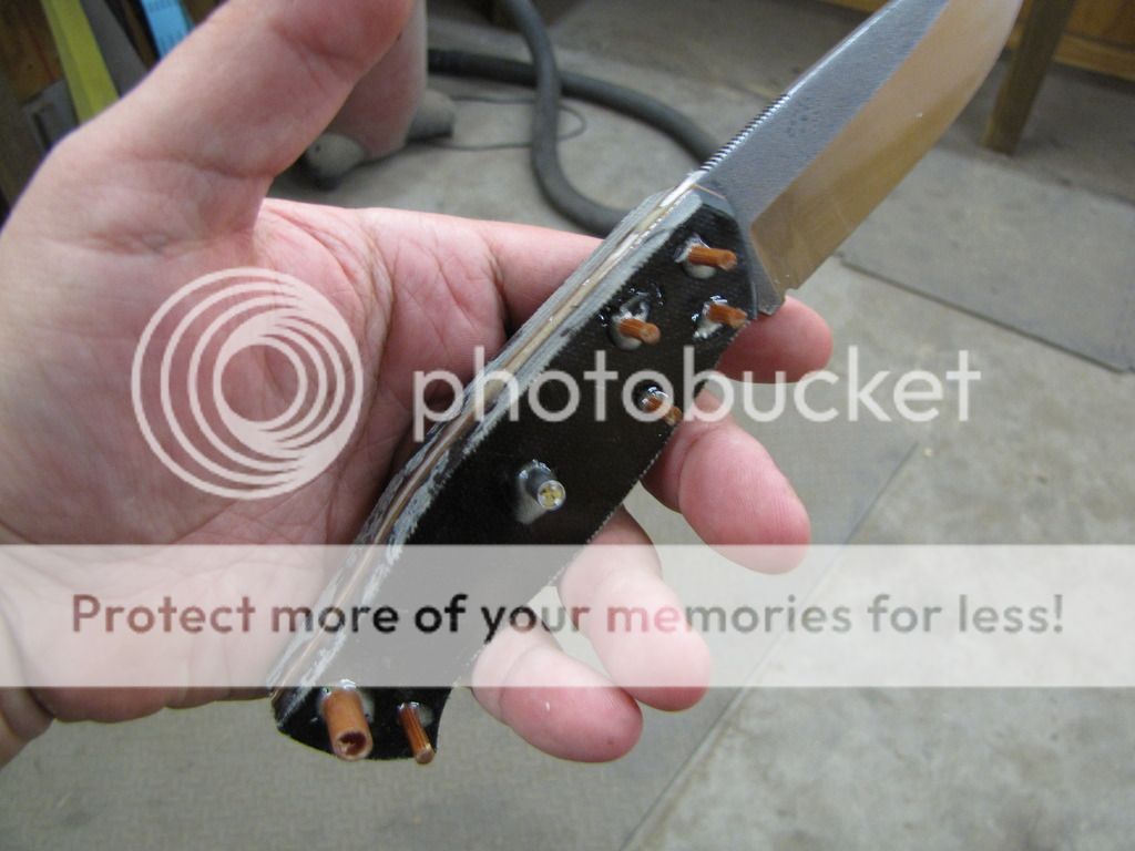

Holes are drilled and handles fitted
The front of the scales are finished

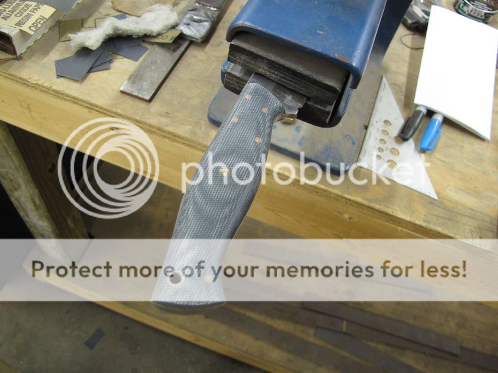

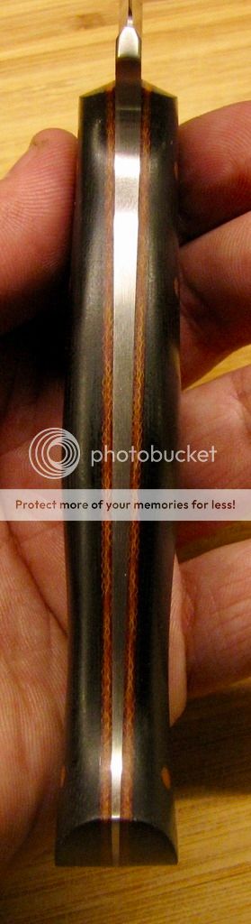

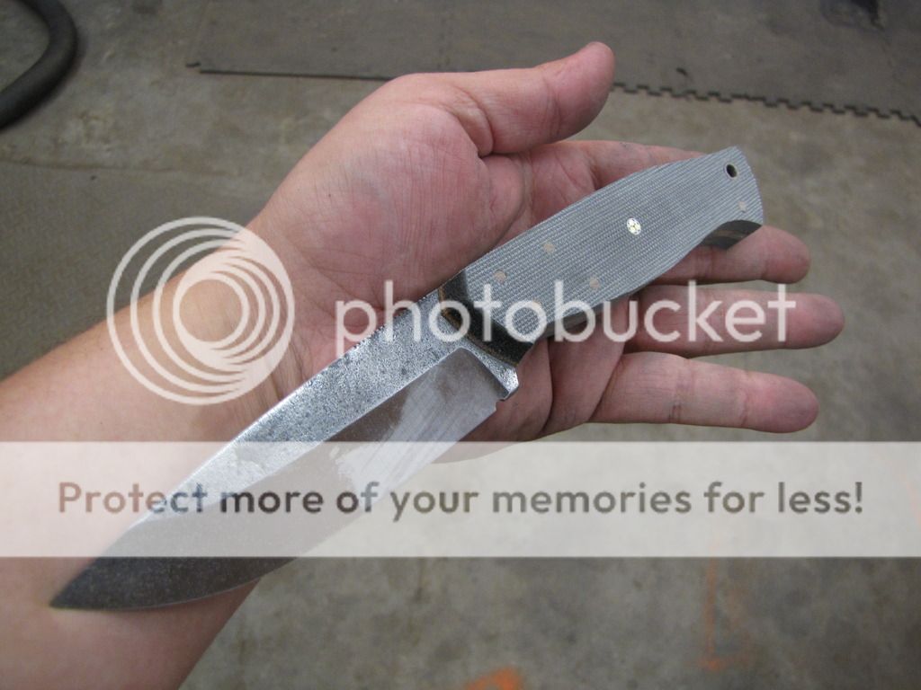

All glued up and cleaned up

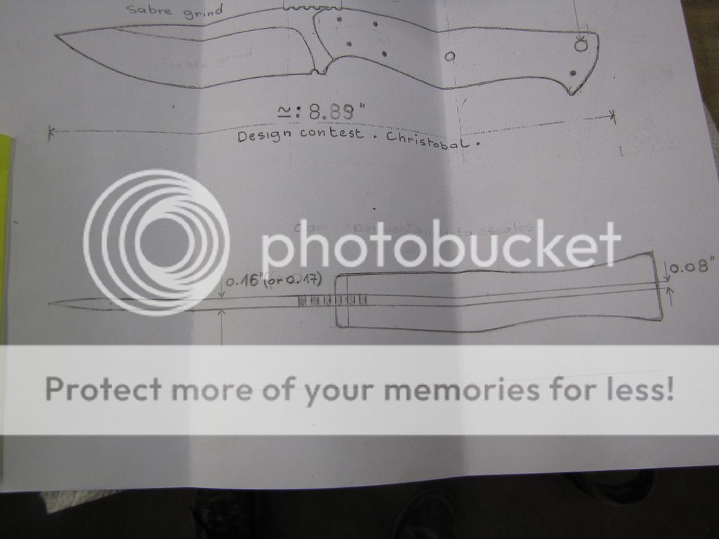

This is the drawing Christian sent me showing the handle shape

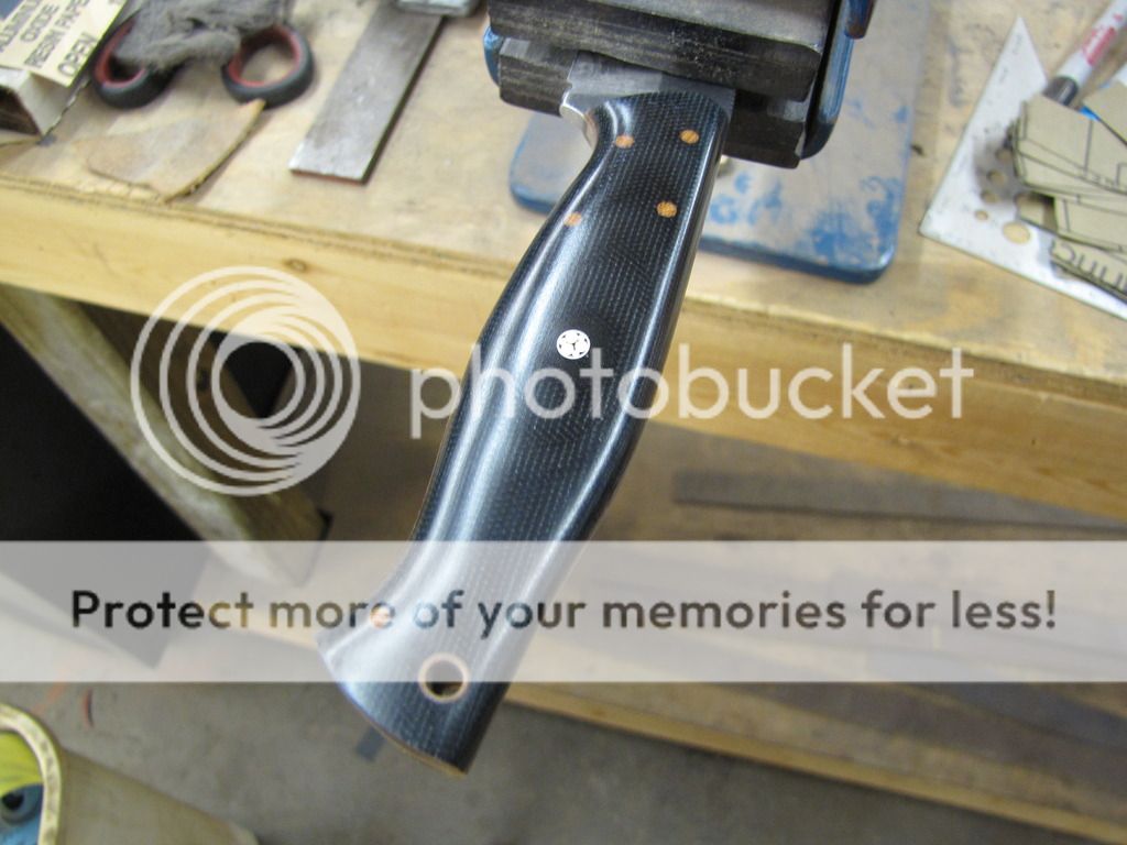

Handles are rough shaped and finished as far as I can go on the machine
Time for hand sanding

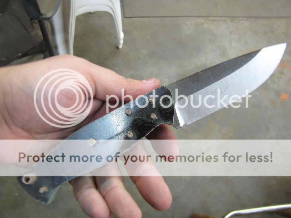

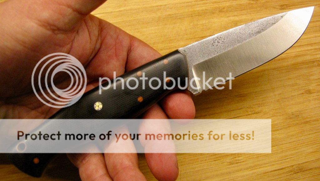

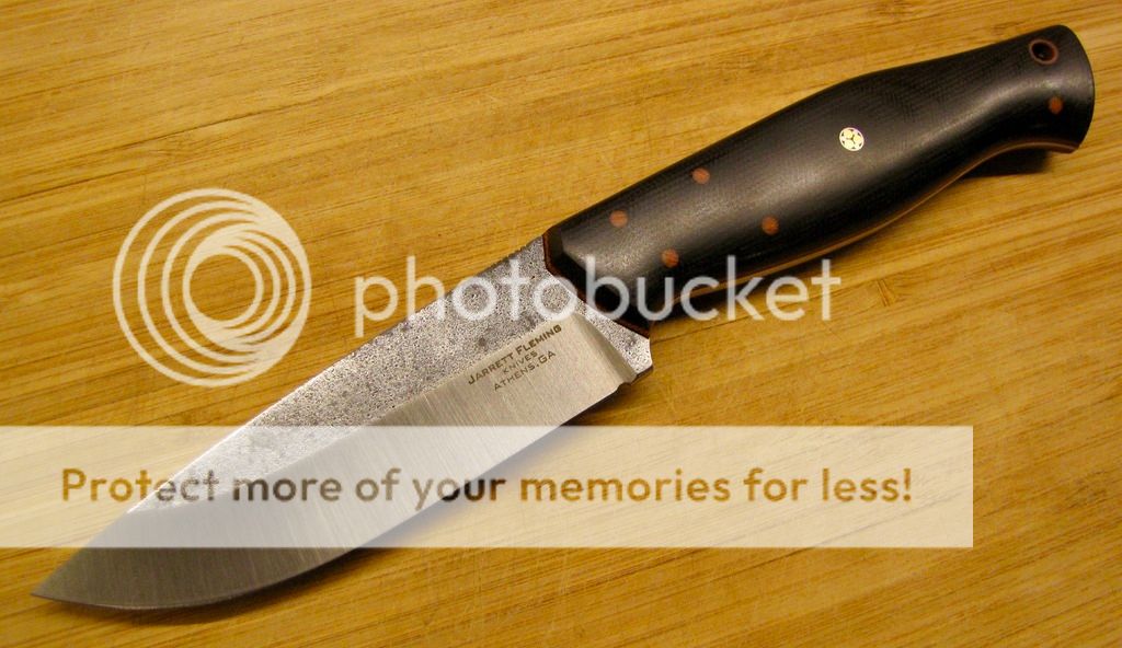

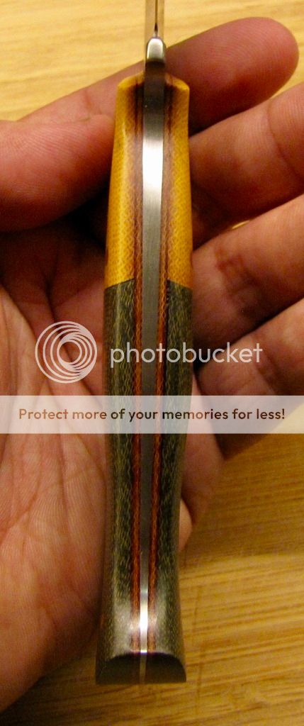

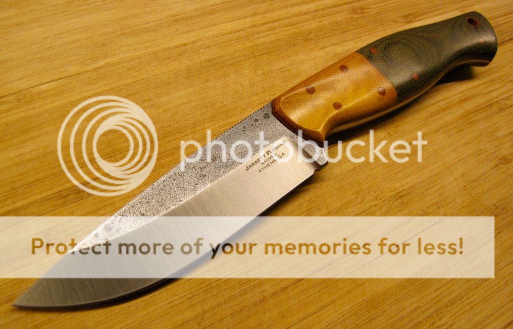

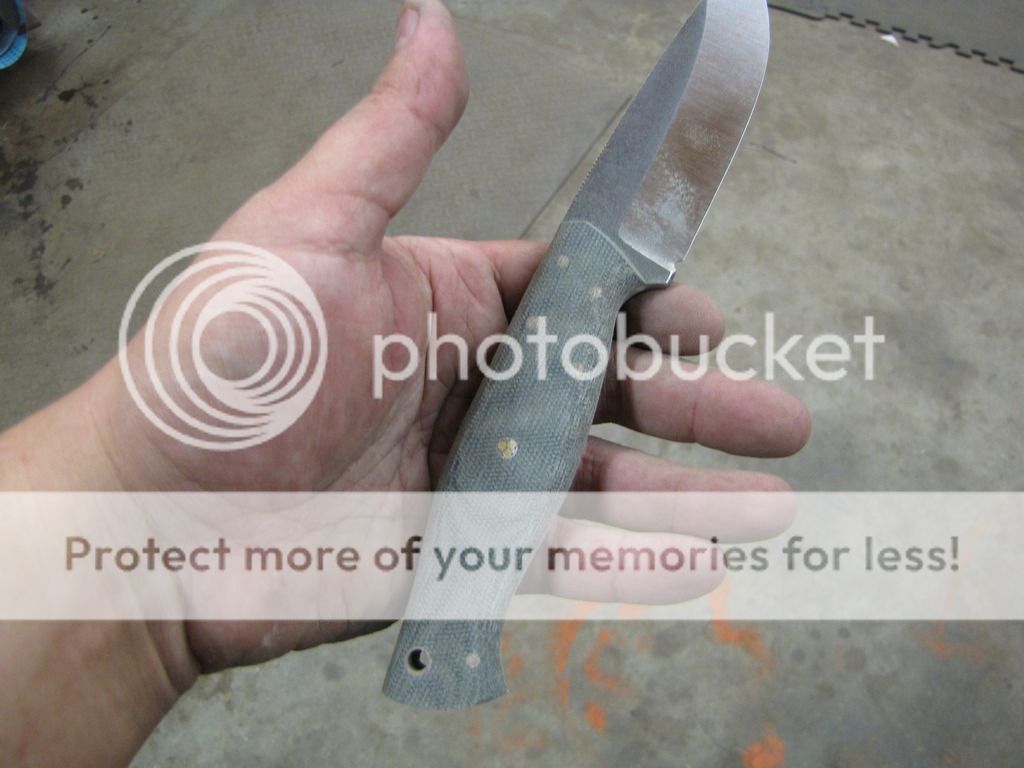

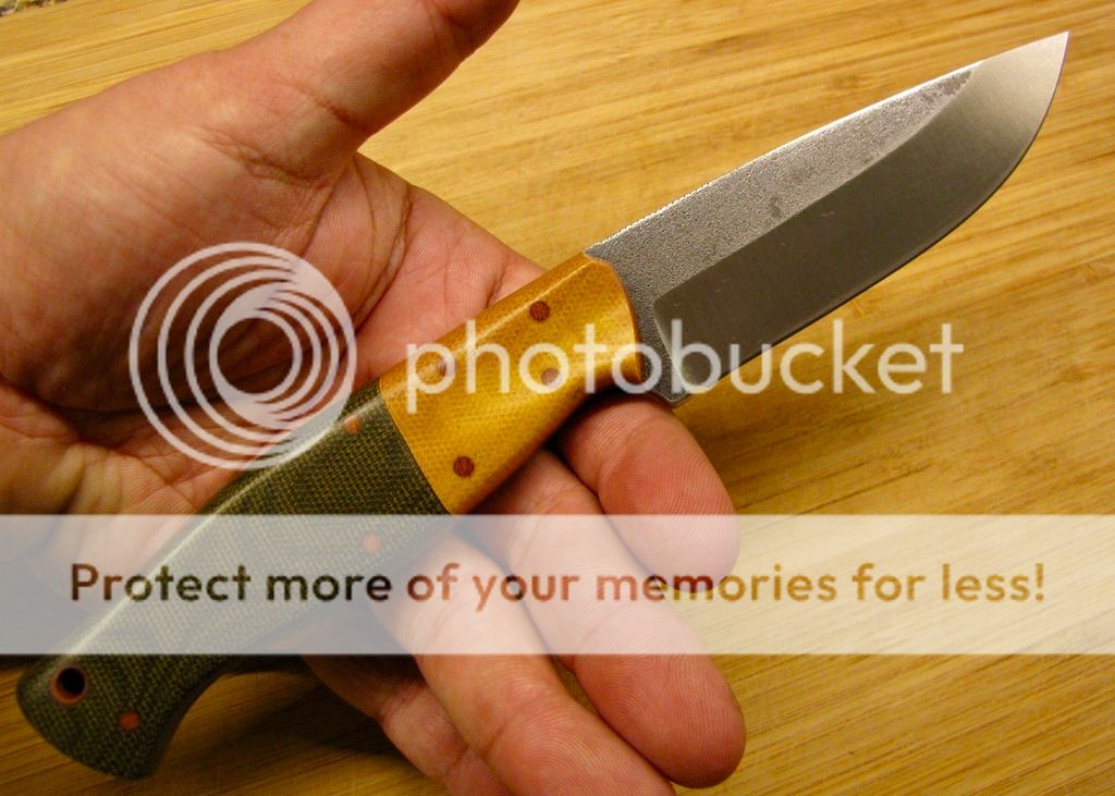

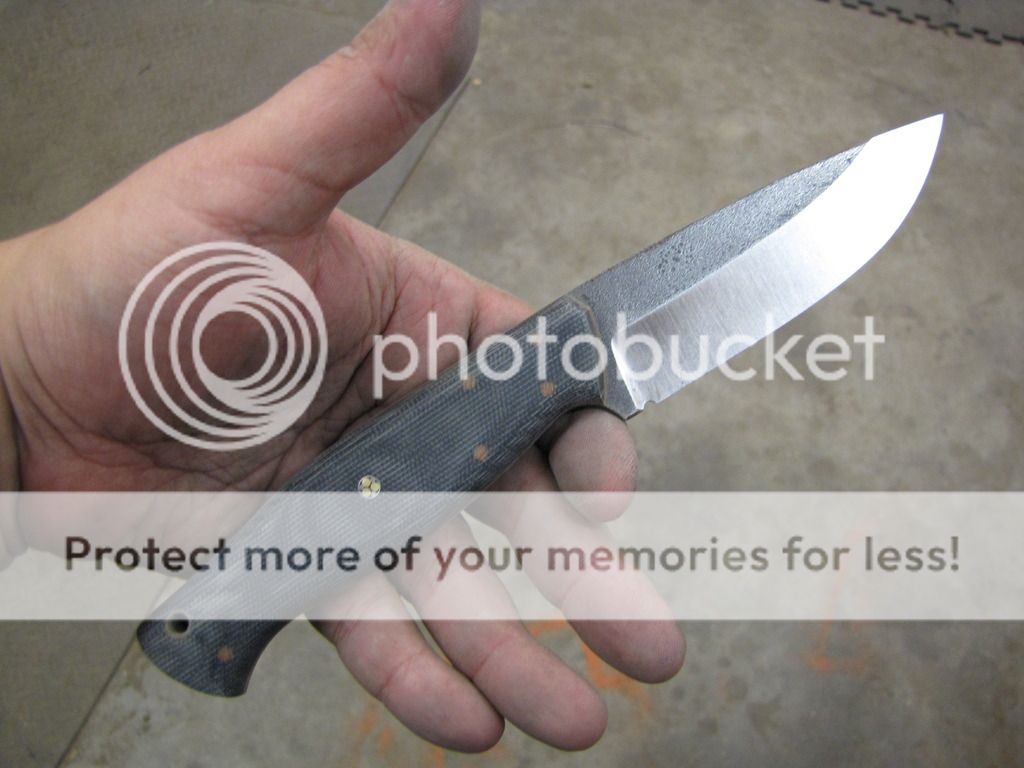

After a few more finishing details, sharpening, and marking the knife is complete
The second knife was finished up as well. I decided to try something new with this one and added some finger pinches.

I really like the finger pinches on the second one. that is a handsome looking knife.
Yup. That definitely is a winner. Really like the pinch grip on the second...hunter.
