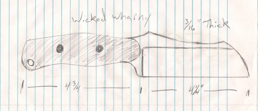

Here's another. I don't know why, but something about it looks familiar...either way, I chose a handle that was simple but very comfortable (in my experience, this kind of handle is usually quite comfortable) with a blade that has enough belly to do food prep and other EDC type stuff. 3/32" blade, and the handle material doesn't really matter. You can place a lanyard hole anywhere, I don't think it matters much.

Hey I like this one Shotgun, I'm not a fan of wharnies but this looks great !!!!;):thumbup:
Thanks, I've been thinking about a wharnecliff(sp?) for an EDC for a little while now. I find I don't use the points on my knives very much so thought, 'why not have a knife that was easier to sharpen?'
I agree on the sharpening aspect of Wharncliffes. I kind of like this size.
