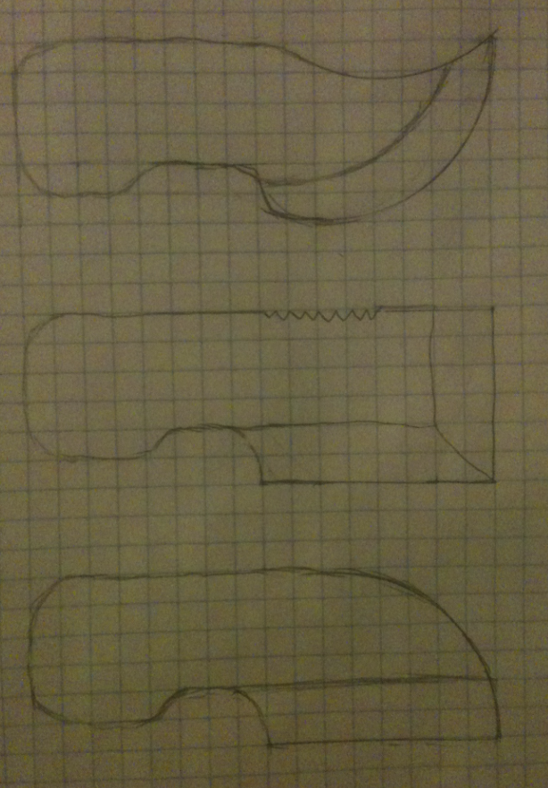

Dimensions on each knife are 4" X 1.5"
Will be made from 1/8" O1 tool steel, professionally heat treated.
Scandi grind on the trailing point and sheepsfoot. Chisel grind on the chisel point.
Still debating on whether I should add a lanyard hole, and whether or not to add handle scales.
Harsh critique wanted. I think they are awesome little designs, but I know they can be better. Help me get them better before I start cutting and grinding.
Your opinion on the lanyard hole and scales is also appreciated.
I am working on a drop point in the same size and theme, just haven't got a profile I'm happy with yet.
If Mother Goose and Grim are looking for knives, those will work great!
IMO, more handle is needed. Also, on sonething that small, I'd say scales are a must, just make them removeable for those that want it slimmer. Lanyard holes aren't hard, allow more adding if a lanyard to fill out the hand. So yes and yes
But, id only be interested in the chisle, do beyond that its just meh to me
To be frank, those are terrible. Look at some knives online and in The Gallery and The Exchange to see what a knife should look like.
I know you are trying for a necker, but you need to learn knifemaking first.
I would suggest you start with a simple design like a drop point hunter and use 1/8" stock.

These weren't designed as tin knives per say, because I don't do the survival thing. But it is ideally a small two finger grip that can be kept in tight spaces. I was thinking pocket, glove box, or in a sheath around the neck, but an Altoids tin work too.
Of the similar knives I've found none had handle scales. I wondered if there was a reason for this? If there isn't a reason, I'll make some with and some without. I'll let the users decide which is preferable.
I don't like lanyards. I can't think of a situation where I would want a lanyard on my knife. But you're right MIGUY, the lanyard whole should be there, and the user can decide to use it or not.
What about the jimping on the chisel blade? I don't like jimping, but I thought it could actually serve a purpose on this one.
It appears you are trying to get 3 items from one piece of 12" long stock...none of these are that appealing. Make a nice drop point hunter and make a keychain bottle opener or widgets from the left over piece of material.

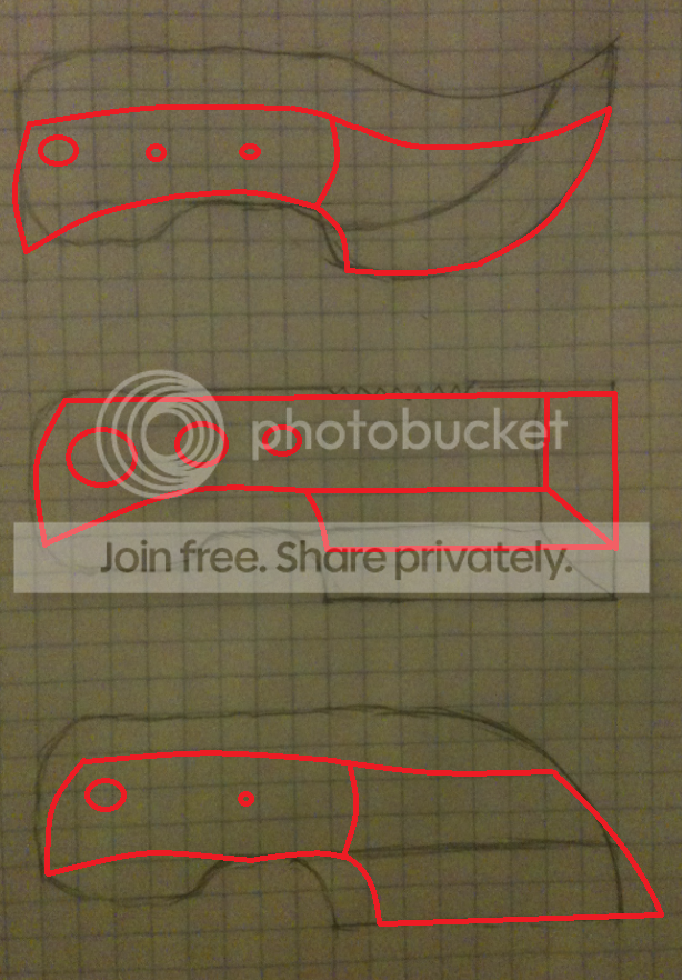

I looked at your drawings and thought about the dimensions, and I assumed were joking; like you were being funny. You need to give some serious thought to the usefulness of these. Compactness and portability are not everything.
From going off your originals these are some quick improvements I made. If you say it is to get 2 fingers grip on it make them able to do that right now it looks like a one finger grip with the way you designed the handles .
These are merely suggestions, hope it helps.

For small knives, they are much too wide. They should be half the width.
Here's a small 5" oal knife I made a little while ago. Notice how it looks like a normal knife, only smaller?
This ^ check out the boker gnome - handle has to be less wide so that you can get decent purchase when using the top of the blade as a thumb ramp.
For me, any knife that I make or buy has got to be at least a 3 finger knife. Anything less doesn't have any control or leverage. Justin's modifications help you out a ton IMO.
I like the middle design, round off the front ahead of the serrations, and add a little length for grip
Design has to follow function. Ask yourself what those serrations would do besides chafe your fingers?
The redrawn chisel ground knife in the middle is a good style....and has been for many years. It is called a Graham Razel. I met Jon and his brother about 15 years ago when they set up next to me at the Southeast Custom Knife Show. They were brand new and introducing a basic simple necker and EDC design then. Today they are a successful company with many designs and styles. Simple as it was, it was out of the box at the time, but still had all the design and function requisites. I can't find the photo right now, but the second link below is the basic shape. The ring was added later. In the beginning it was almost a sharpened bar of steel with a paracord wrap. Later they added a serrated line cutter on the last inch of edge, IIRC.
