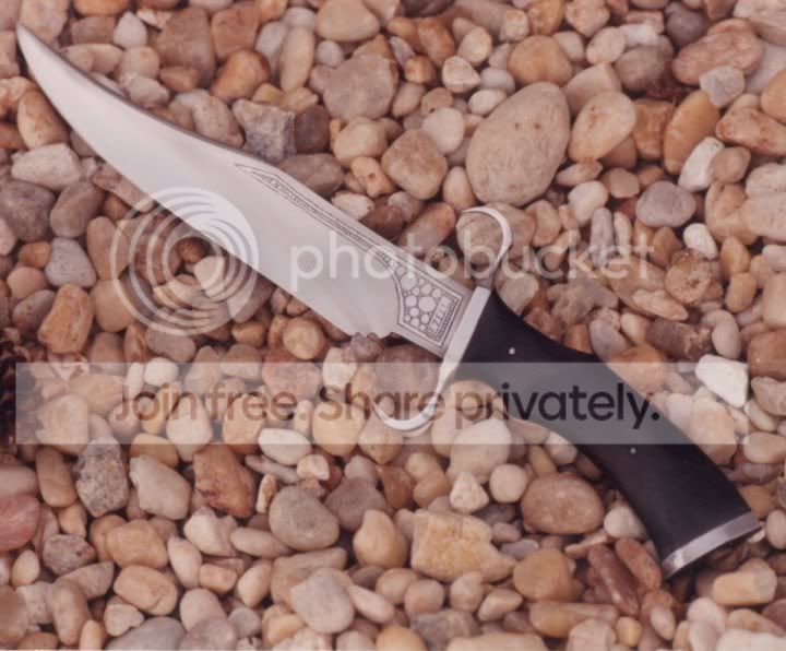

I've been etching steel with ferric chloride for some time now. For a resist I use enamel spray paint. You will need to experiment a bit to determine the time required to reach the depth you want on the steel you are using. I would not suggest using this method on damascus, as the 'bright' layers will etch much more slowly than the dark, and it looks a bit funky... a stronger acid would be required for damascus, I think. This method works very well on copper, too.
I spray on the paint, avoiding runs and bubbles, and let it almost dry, then use a sharp scribe to cut the pattern I want through the paint. I then submerge the part to be etched in the FC. The time will depend on the strength of the etchant and the type of steel being etched... with my mix it takes about an hour and a half to get a good deep etch on 5160, a bit less for 1095, and a bit more for L6 or 15n20. Every thirty minutes or so of the etch, it is advised that you lightly brush the etched area with a feather to remove the oxides that form.
This is one I got a little crazy with...
