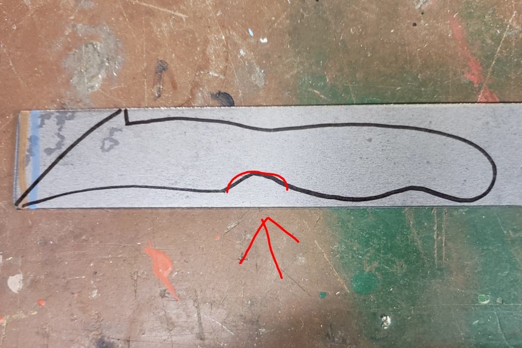

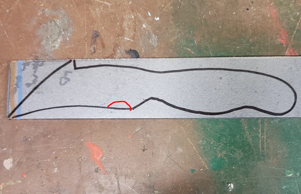

If I could make a suggestion on your wifes garden knife. Maybe add a small finger choil so she could choke up on the blade for hard cutting/digging.
Suggestions are always welcome!
Are you saying make this deeper?
Or add one on the blade part like this?

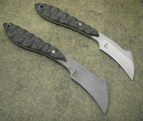

That’s Paul Letourneau’s work.
https://www.pmlknives.com

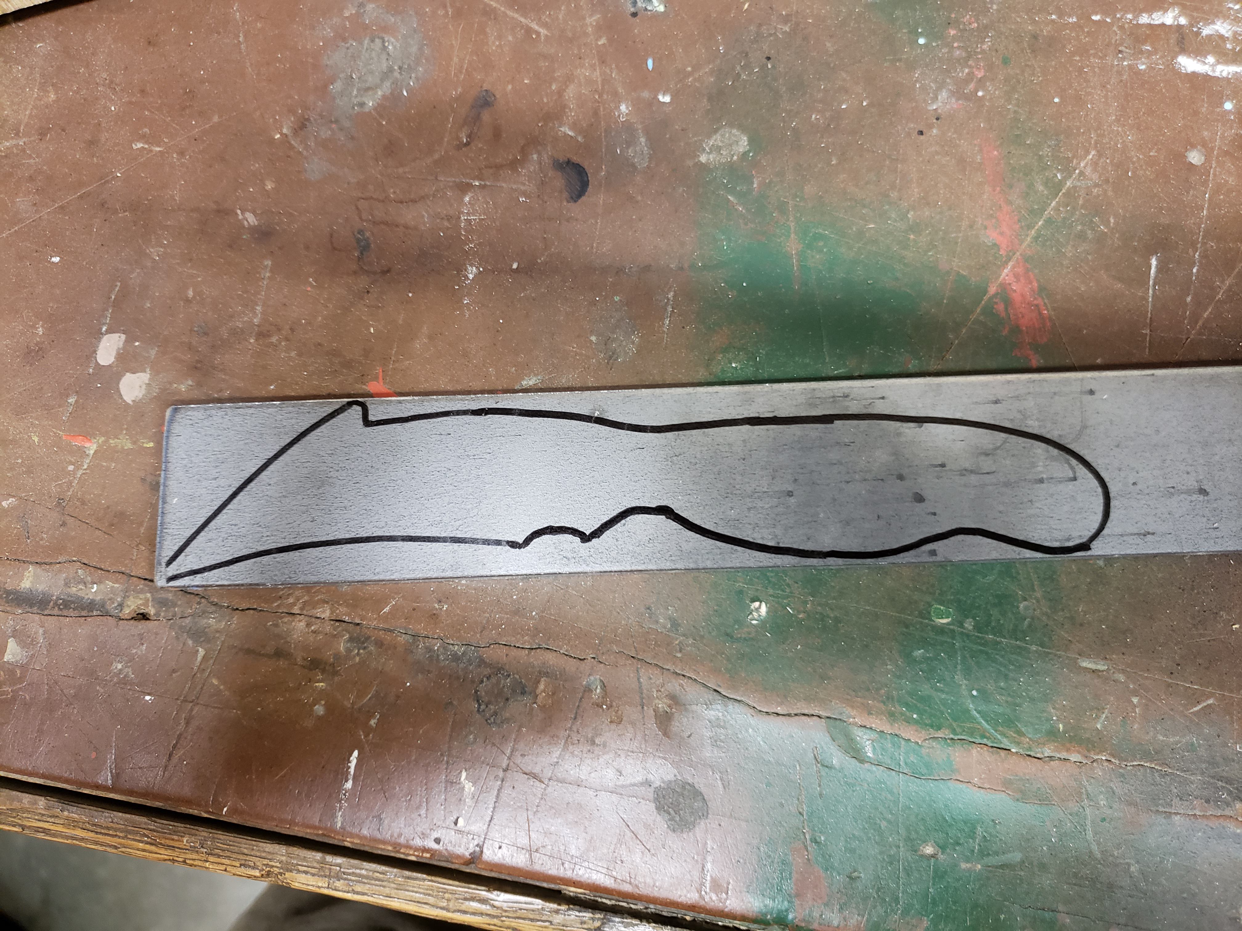

So here it is. This is what got me thinking about it. I found the first picture on pinterest, and want to make a garden knife for my wife and friends (gifts only). Clearly some differences in the handle but the blade is really close.
If anyone knows this knife maker I am more than willing to talk to them.
All this is great info though. All things to consider the deeper I dive in
More like in the top pic in your post #24. I wasn't sure if that was a dedicated finger choil in the original post.
There is another discussion in the general thread about finger guards. I like a little bit of a finger guard + choil (like on an ESEE 6) since they help keep your hand from accidentally sliding down the knife. Your wife might have to hack at roots, prune, etc and you want a little protection if she hits something hard to keep her hand from sliding down onto the blade.
I'm not trying to take over your design. Just a few thoughts on a work tool.

My intent is pure inspiration. The curve of the blade will be great for harvesting. And that "horn" could be useful to scrape out dirt.
And like I said suggestions are welcome. I am brand new, and that is why I joined this site, to learn from others so I don't makethe same mistakes.

If you are making those for friends and family....nobody is going to be bothered. At least they shouldn't be.
Now when you get famous, and you sell those, that will be a problem. Your drop point might not be, but those would. That is a pretty distinctive profile.
Since finding out it was Paul Letourneau’s work, I actually emailed him to ask permission. We will see. But I am with you, I wouldn't think it is a big deal. But nonetheless i will still givethe respect and ask.
Update... Paul gave me permission, and wants to set pictures of how they turn out.
