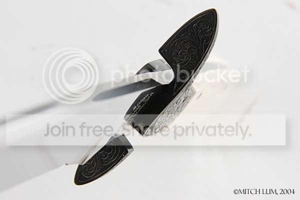

Many years ago, When I was younger and didnt have this knife habit i had the opertunity to be a freelance illustrator. One thing that stands out now is the fact that.,That job didnt test my creative side as much as trying to come up with ideas for knives and handles and guards that doesnt look like everyone elses.:jerkit: Yea I know Waaaaa. But on a more serius note has anyone ever tried using two halves of a guard pinned together without it showing that there are two halves? I've got a good design but I think that the only way to make it work is to split the guard and I'm not sure how to get it pinned so the crack doesnt show. The gaurd material will most probably be brass all tho I was playing with the idea of using S.S. instead. Thanks in advance for any ideas or comments.

I have tried it and its a pain. I modified my design finally because its so hard to make two exact halves with the correct opening for the tang thickness. Mine ended up attaching to both sides. Here is the first one I came up with. I've done a couple of these after this but no pictures.
