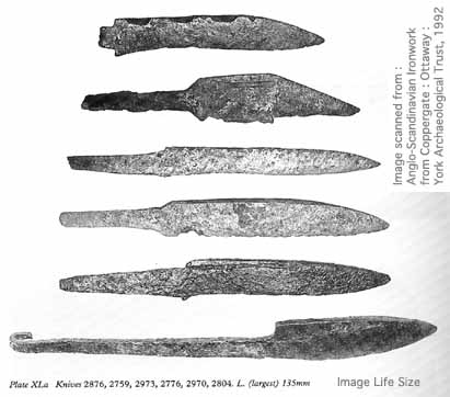

Take the smaller seax for example:

Here's a recreation of a Celtic knife found in Northern France, probably from around 200 BC.
I have one of these knives. In my opinion, it's a fighting knife. Of course it could be for butchering meat, who knows. It could have served for any and all. It's not a noble weapon though. This was a common man's knife and this pattern was a popular one, found all over Europe.
Here's another common, Iron Age pattern:
