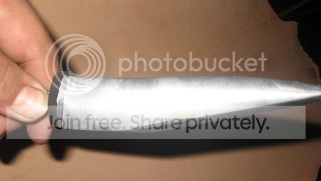

I am working on my first blade. I was smoothing the area on the flat of the ricasso and touched the edge of it with my angle grinder. There is no more plunge left. I did the other side beautifully then destroyed this side. I smoothed the other side to match. This first knife is definately a learning curve. I will post pics tonight. Also, the tang on the blade is pretty short, about 1 1/2". I didn't have anything that would go deep enough into the handle so I had to cut the tang shorter. Going to pin it, will probabally only get one pin in it though.
Since this is going to be a hidden/stub tang, you could put one or two more pin holes in the tang and run short pins through them just to give opposing surface area for the epoxy to hang onto. I would use files and sandpaper to flatten and smooth, it won't be nearly as slow as you expect and you don't have to worry about a 10k rpm grinding wheel going rogue ;)

LOL, smaller knives, very true. I've widdled this blade down a bit. Looks okay except don't like what happened to the ricasso. Live and learn right. Next thing I have to figure out is how to heat treat it, I'm just about at that point. I made the hole in the handle a bit too big also, hope the epoxy will fill it alright. Can you put metal shaving in there, with the epoxy? Will it give it more strength. I use a full day cure. That will be fun too, figuring out a way to hold the blade right where it needs to be.

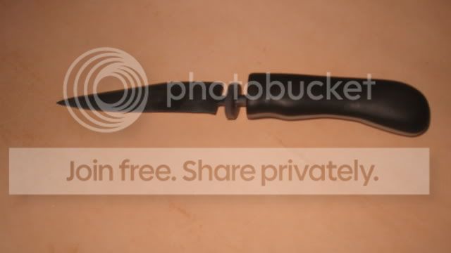

Here are the pics of the first one in works.
nice! whats the steel? and i found that a gentle hacksaw kerf makes nice plunge cuts.
so it does not have a plunge. So what if the guard will not line up seamlessly now that you have no more plunge and flats. Its a learning expierence, as long as you heat treat it right you can cut A BUNCH of stuff. use what you know and make another.
