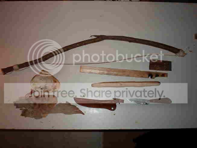

Oh the knife is a Grohmann river knife had it for 18-20 years I bought for canoe camping after my Kabar went to the bottum of a lake during a canoe trip in Algonquin park. I then saw the need to go a little more civilian in my blade. Funny I bought it then moved 75 km from the factory (15 years later I went to the factory on my honeymoon and bought a chef knife. You can buy a kit on the net to build your own now.
I used Cedar for the board and Willow for the spindle.
The board was about 1/2" thick (12mm) the spindle about 3/4" Diameter.
Here it is
The bearing was made from Beech, this is the hardest wood I have ever come across in the N Hemisphere. I dont know if it grew in a super cold and shaded place but man, it takes a chisel and hammer just to split it.
Nice pic.... My cedar is 1/2 for the fire board and the spindle is about the same maybe a little narrower but not much.. I started with inch thick spindles but I've fould I can get it narrower now. We have some willow but its not arrow my house maybe the next time I'm out for a hike I'll spy some to try.
Cool love to see other's set ups.
