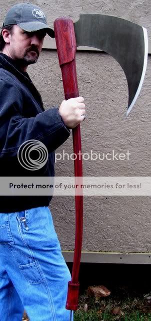

The "Devastator" – Influenced by the Death Dealer Axe:

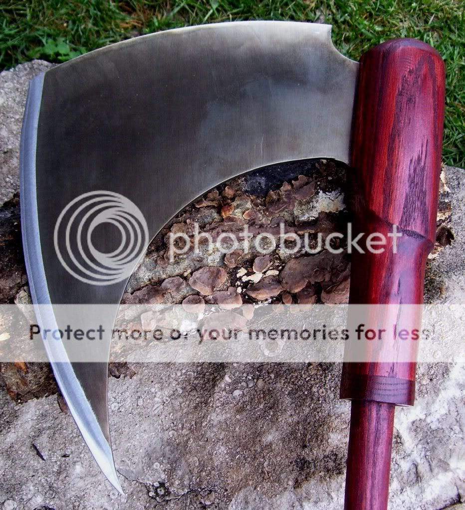

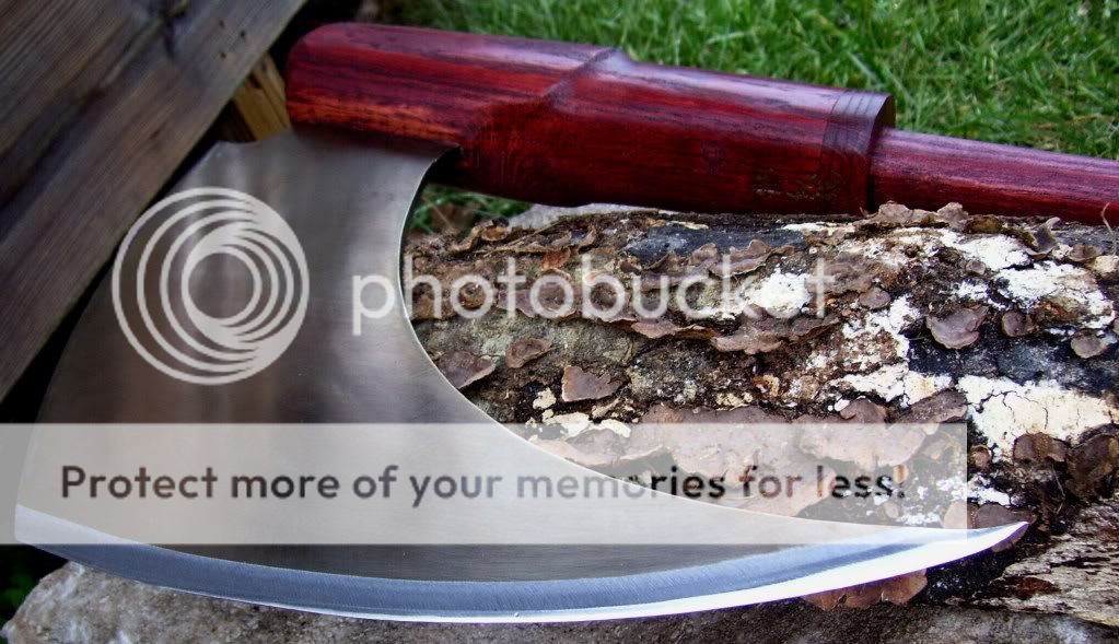

Hi friends. Did this Axe last week for a customer. It’s an attention getter!
Our Youtube Video of the Axe
http://www.youtube.com/watch?v=nA_7kMABAq0

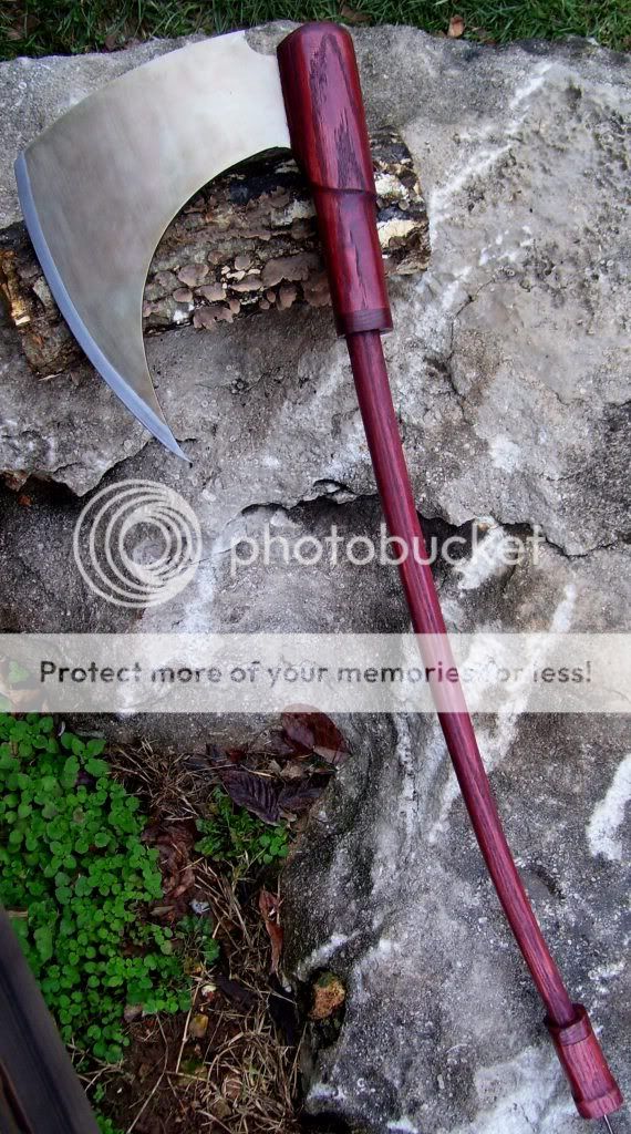

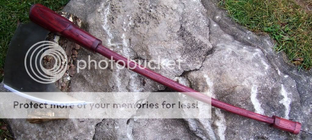

Total Length = 48“ (4 foot)
Blade Length = 14 “
Blade Width = 1 foot 2”
Blade Thickness = ¼ “
Handle Length = 48” 4 Foot
Handle Width = 1 ¼ “

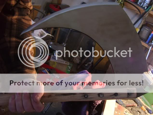

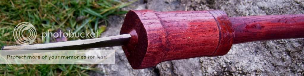

Axe Head Steel & Attachment: 5160 Steel. Attached with 4 ¼” Lag Bolts Gorilla Glued & Cut Off
Handle = Oak. Handle shape is not cut out. I bent it using steam. The same approach I use on my bows. Makes for a stronger handle.
5” Steel Butt Spike
Weight = 9 lbs, 12lbs including shipping

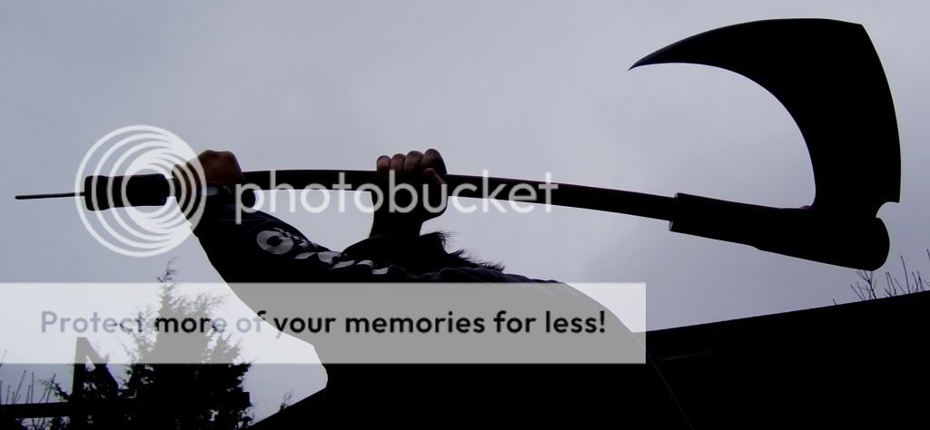

HOLY!! I couldn't really tell how big it was until the pictures of you holding it!:eek:

Looks awesome, but I'd be afraid of the wood snapping during contact with whatever I'm chopping. I would have used some kind of tubular metal. Maybe aluminum. Yes, it would have been heavier, but I like the peace of mind especially if I actually were to commission a piece I'd be using. Having said all of that, how sturdy is the wood?
The tang goes down about 8 inches, and it's bolted with 1/4 inch lag bolts, tightly screwed through the oak and steel, with a heaping amount of gorilla glue.
I would imagine, the way it's designed, it probably wouldn't work good for chopping trees down, but I would definitely go into battle with it, after practice and a little strength building with it. It is 9 pounds, and it's all out there on the end.
The handle is made out of a solid piece of oak, that I steamed and bent, similar to my bows. I thought that would be better than cutting the wood out at that shape. So honestly it is one stout puppy.
The head is clamped around the bolts and tang and also gorilla glued very tight.

I just have one thing, the oak... oak is hard and durable, but not flexible.
Normaly axhandles are made out of ash or hickory because they are more flexible/elastic.
I beleave an equal diameter ash handle will be much more durable.
I wouldn't go to battle with an oak handled axe
