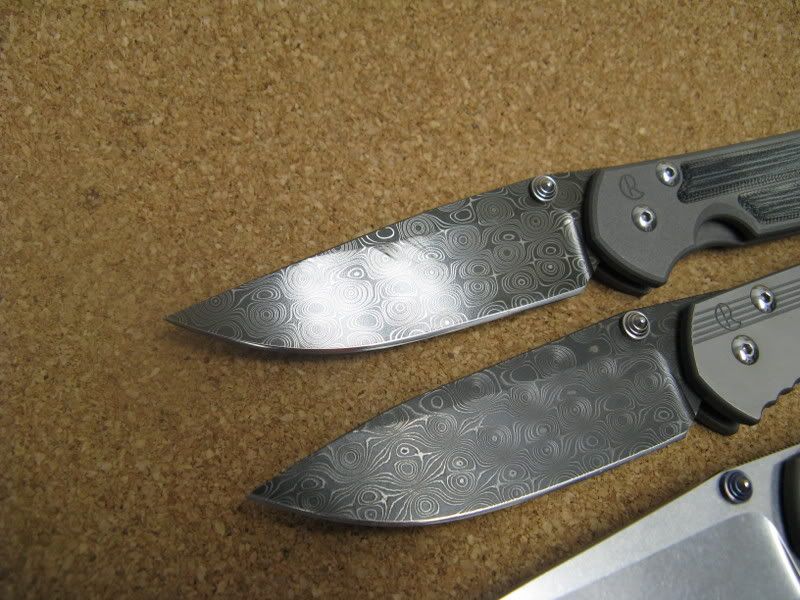

I post sone Pix in the AM, Iv used both... and that coating is NOT made for use. :)
That rub mark in the coating on the Micarta classic was from one cardboard box, I'll poke around some more to see if I can find a better pix :cool:
This is the only other pic I can find, I must of never uploaded the pix to photobucket :o
(You can kind of see the rub mark near the shoulder of the grind line)

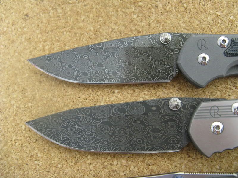

Anyways here is Raindrop HC and SS, I like SS MUCH better for a user
Mostly because you can use it and it does not show, cardboard boxes and all... she will keep that new unused look. :cool:
