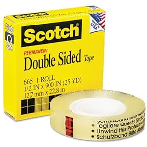

There are some versions of double-sided tape that aren't foam-backed, and more like regular scotch tape, that might also work for this. I have some 3M 'Scotch Permanent Double Sided Tape' that's 1/2" wide. About 3 mil thickness (0.003"), according to 3M's specs; this is about the same thickness as an ordinary sheet of printer/writing paper. Wouldn't lose much, in terms of maintaining a very firm/hard backing under the diamond film. Due to it's 'permanent' adhesive nature, it may not be as attractive an option for peeling off & replacing as needed.

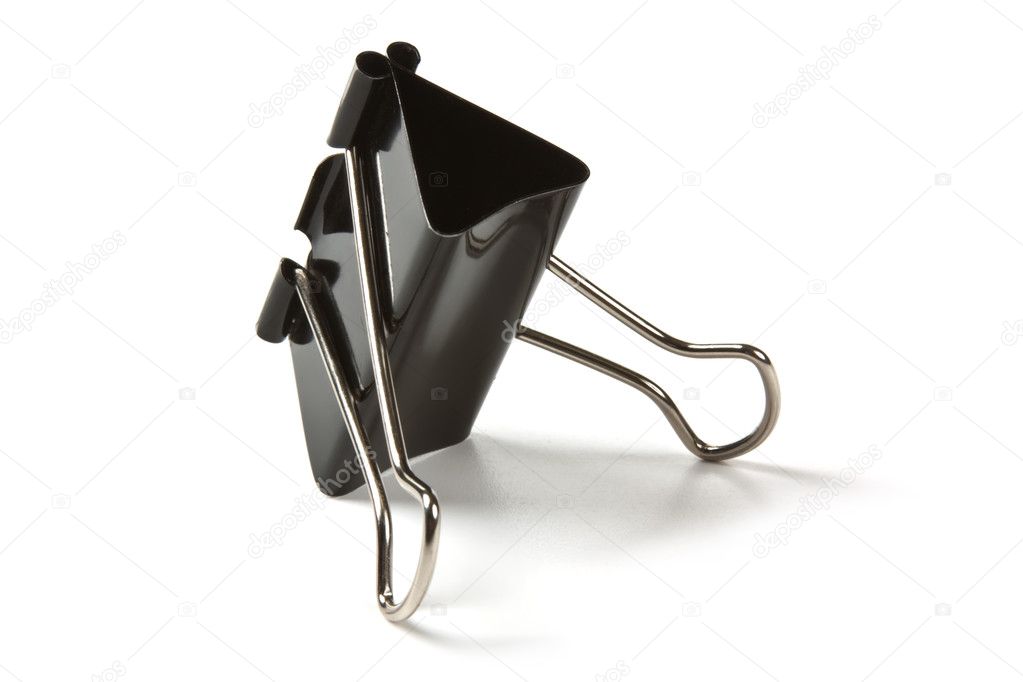

i would stay away from adhesives and just use some type of clamp on both sides. just pull the film as tight as you can and clamp it down. those black metal clips that are used for clipping paper together that is stacked thicker than a paper clip can do. this will allow you more freedom to change films. you would have to clean the adhesives off between changing films or you could get some buildup that chould lead to high and low spots
like this
This is what I use, it is the 3M 6661X 6x6" diamond lapping film attached with the removable version of the Scotch double sided tape, Cat# 667

So, I gather you have no problems with replacing the film on the glass blanks, meaning: tape holds well and replacing it is fairly flawless?

No, absolutely no problems. The tape holds very well and comes of easily without leaving any residue.
