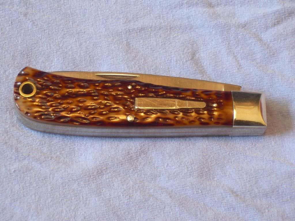

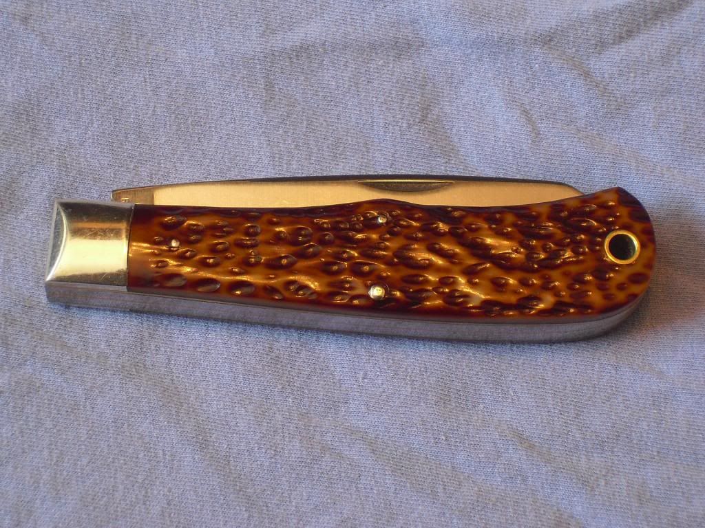

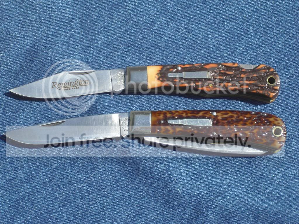

I recently got this knife, and I've heard that it was possibly made by a company called Bowen in the 1970's, or made by Camillus for Bowen. I've seen others like it with blade etches, but you can see from the pics that there aren't any etches on this one, and it doesn't appear that there ever were. I think the scales are Delrin; they're definitely synthetic.
So, what do you folks think?
Bottom knife, shown with a Camillus-made #1306:

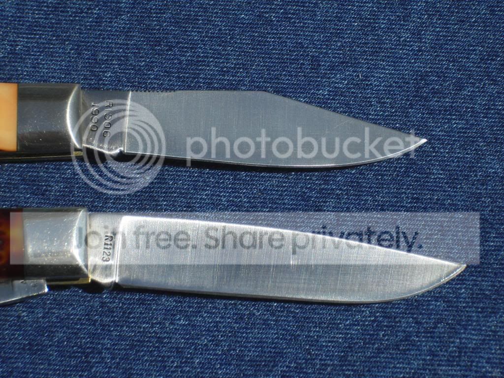

Blades, note the lack of an etch:
Thanks for any input you guys can provide.
~Chris

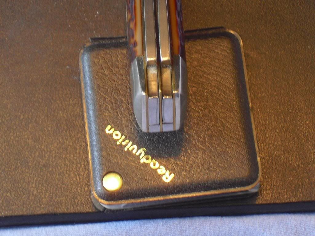

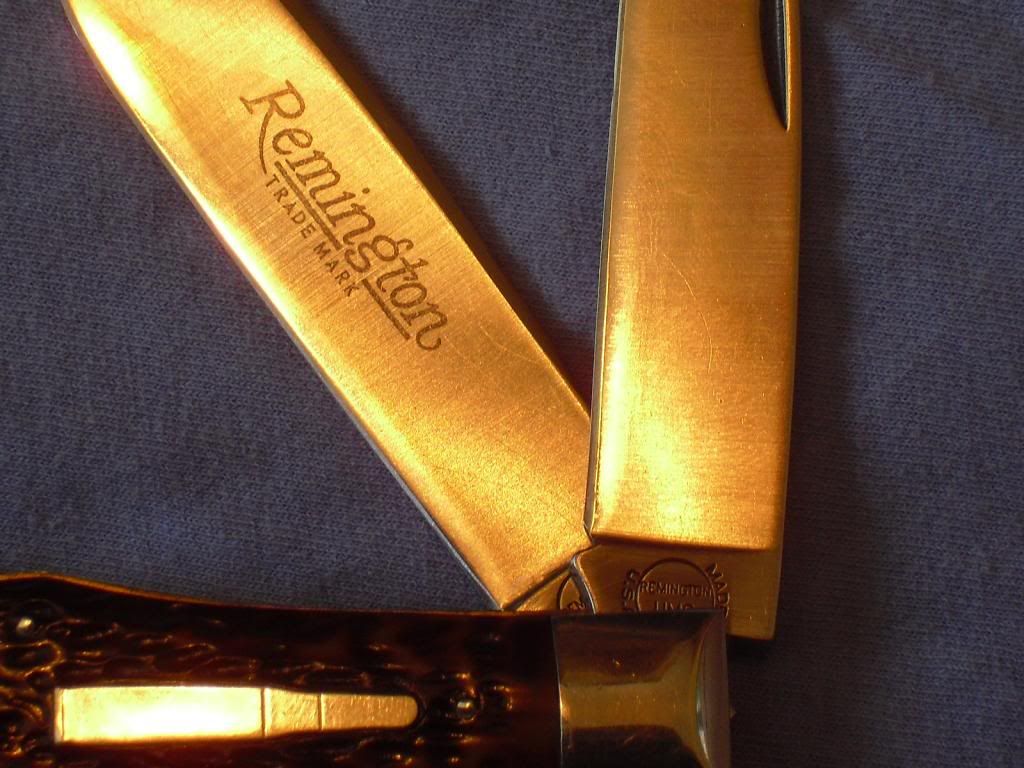

Are the tang square ends flush with bolster ends when closed?

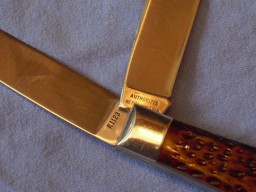

Is the reverse of the Spey blade stamped "Authorized Reproduction"?
If yes, then it is a Camillus made knife from the 70's.
Thanks everyone - Phil, it's as you described. A couple of other questions, if I may: do you know what the blade steel is? (440A maybe?) And was Bowen the only one Camillus made this pattern for? Seems I've only seen Bowen knives with blade etches. This one was never etched from what I can tell.

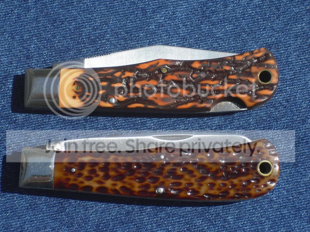

Phil - I'm confused by your posts #'s 4 & 6 above - Here's more pics that may help.
~Chris
Sorry Chris!
What is the confusion?
The knife WAS made by Camillus.
What does Bowen have to do with this?

I know. This old Bowen sure is nice; I've got a couple of Schrade Fire & Ice Trappers made by GEC:
I love the overall quality of them, but the Bowen just seems to have so much more character. And the backsprings sit back just a fraction of an inch, not fully flush with the blade tang & bolster ends:
Even with being made by GEC, these two are at something like 1/2-to-2/3 the cost of a regular GEC 23 & 73. Go figure. As for the Remington #R1123 repros, I keep waiting for a 1982-Camillus made version to come up at a decent price. I'm keeping my fingers crossed.

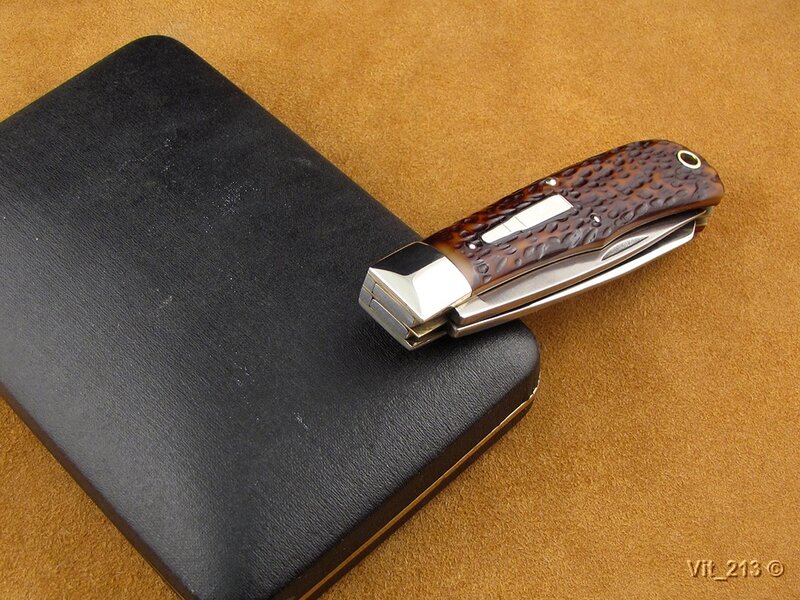

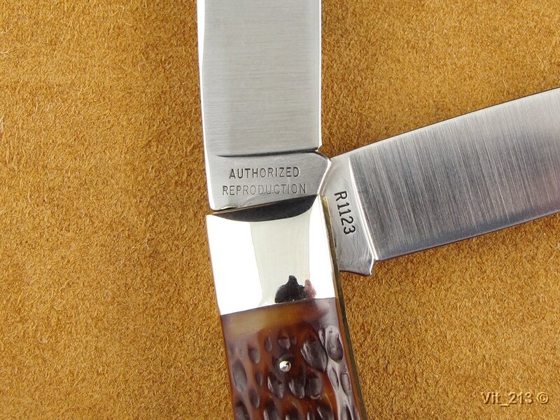

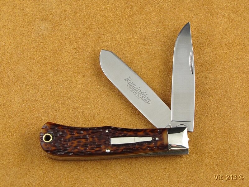

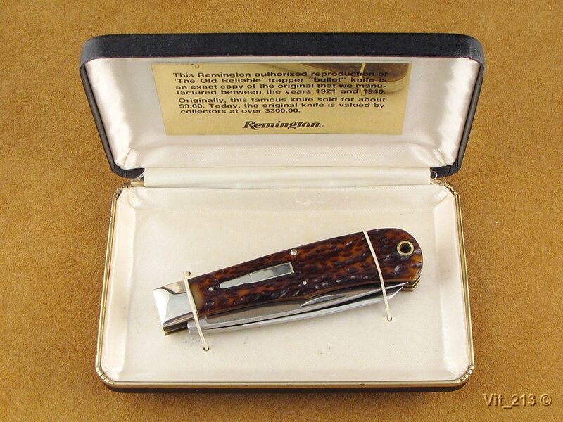

Great knife! :thumbup:
In the case too!!!
I have never seen the case!
Where do you find your knives Vitaly??????
I found it on eBay, but do not tell anyone about it. It's classified information :D
