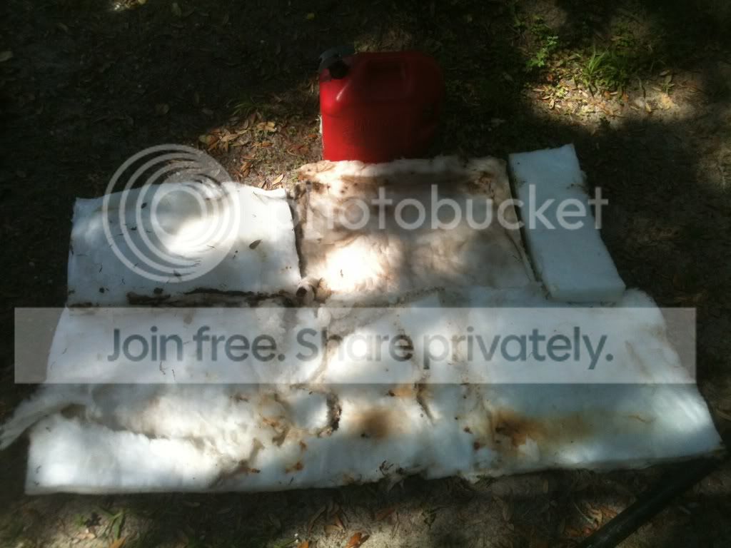

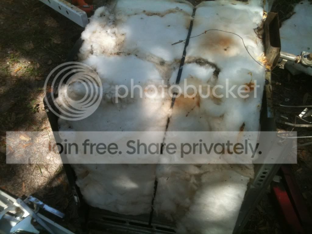

I picked up a gas stove from the curb today. Took it home and took it apart to add the the scrap metal pile. When I got the sides and top off, this is what I saw:
I gently pulled it off the inner part of the stove and laid it all out. If this is ceramic insulating blanket that can be used in a forge, I think this would qualify as a good find:D:D I didn't measure any of it, but that is a 5 gallon gas container. Not only that, but the oven burner looks like it might work for some other things as well. Just have to get the fittings for propane.
Think this ceramic insulation?
seeing as how it's free - you could still test it.
You can always hit it with a cutting torch and see if it melts easily.
But considering the materials and work it takes to build a forge, new stuff is probably cheaper.
Rob, I think what you've got there is the for-runner to inswool. It is meant only as a heat insulation and not to be used exposed directly to fire. It works for heat transfer OK and with the right project it could be used in the outer part of the case away from direct flame.

Yep, that is insulation....not Insuwool. It will work for some shop tasks, but isn't for building forges and ovens.
Herre is a use. Make a hot work table by putting this insulation under a 12X24" sheet of 1/4 mild steel. Make a a sheet metal box to fit this top sheet, put some spacers of soft fire brick to make it flush with the box top, put the insulation in the box, set the top plate on. That way you can set down hot blades,do soldering with torch, or even weld on the top without the underside burning the bench. The hot work box can be set aside when not needed.
