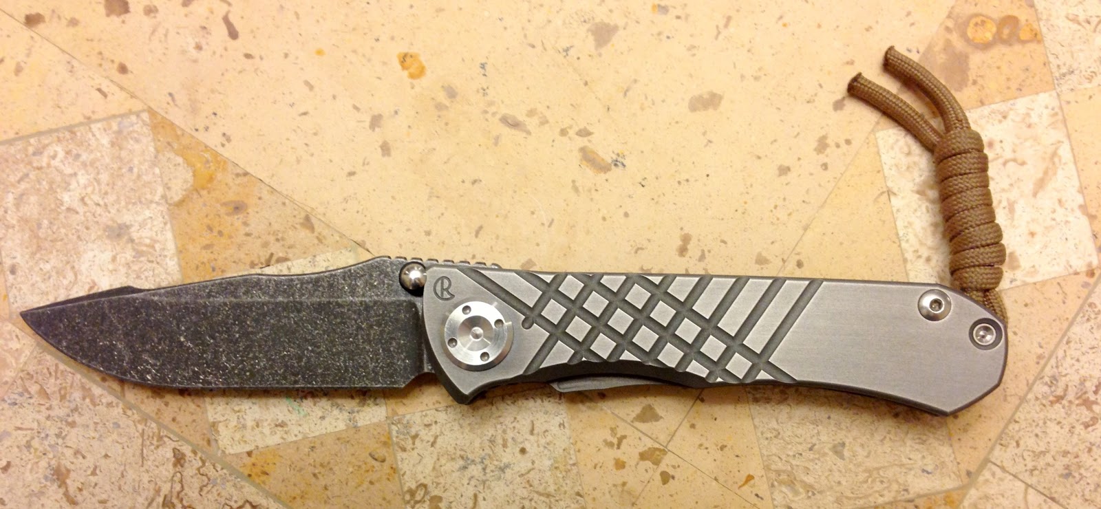

did some zt 560 mods
Thanks guys, left it in the acid about 40 minutes, defiantly wait to reprofile till after the stonewash
And the scale it's a rival one I bought off of a member here

Protect pivot area and detent track with clear nail polish, allow to dry.
Soak in 50% PCB etchant for 30-60 minutes, depending on how dark you want it.
Rinse with cold water, dry thoroughly.
Reapply nail polish if needed.
Put in container with a handful of pebbles, wrap in towel, tape up towel, put in dryer (no heat) for as long as needed to achieve the look you want.
Rinse and dry again, remove nail polish, reassemble.
Reprofile and sharpen.
That's how I did it anyway.

Yes, but I did it because I had already voided my warranty be getting the blade re heat treated. CRK runs their S35VN way too soft, so I had it hardened up to a more reasonable HRC.
Yoko, did you cover the pivot area? I'm wondering how stonewashing will effect the lock up. I've only washed clips and an old Cyclone blade, which now has blade rock.
i put nail polish on anything that would have any kind of contact with anything , no problem at all still smooth no rock
