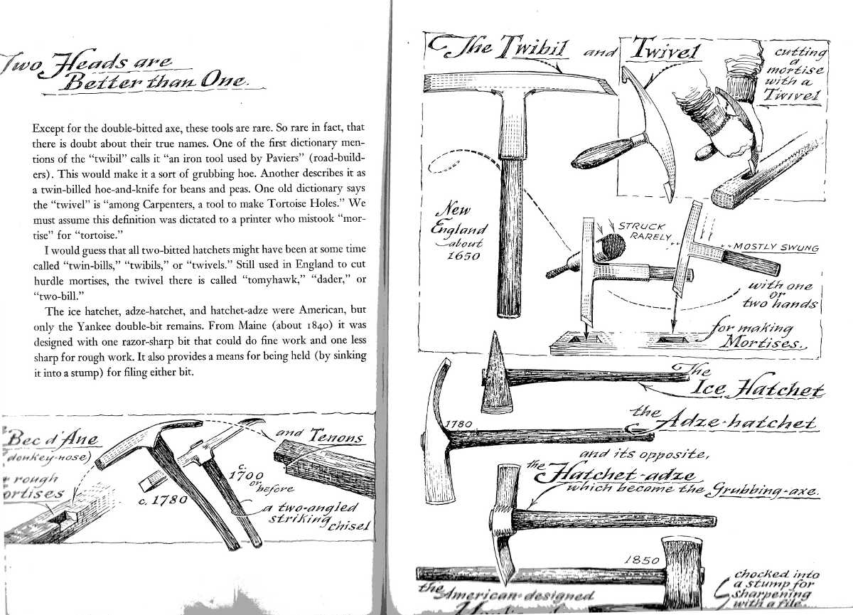

Nice work. That tool is what we would call a twibil. I've never tried one.
Though it's at odds with the current notion, in which a twybil is as I describe down there, I think you are right to associate this tool with the word twybil SP. Here is a 16th century reference to a twybil as a carpentry tool and not a craft tool. I have heard an explanation of the word twybil like this. The word comes to the English out of the German where zwei (2) is spoken out as tsvi, close to our twy in this case, and in German the word for axe is beil, possibly our bil in the translation, for a combination of Zwei and Beil = two axe or double axe.
E.DB
There is some confusion here about what the tool is called.
From 'A Museum of Early American Tools' by Eric Sloane.
Excellent, haven't seen a twybil in a bit. I rived some white oak for chisel handles over the weekend. Does that count? Recreating the pics I didn't take would be way too much work.
It's why the best course is to avoid the word until it all gets straightened back out. In his sketch he shows an incorrect bevel at the mortising end. If he is suggesting it's struck with a maul, he and his sources are wrong in perpetuating the idea because that would only be done in ignorance. On the other hand, you can pare with either bit fairly well from above with a grip around the socket. It seems a wild speculation that the common double bitted axe has its roots in the kreuzaxt, but who am I to say, other than that his beginning point is all screwed up? I don't know what to think of this Sloane character other than that he is popular.
E.DB.
I was struck by how closely Sloane's Adze-hatchet resembles the later undercutter axe. The thing is that people made and used whatever tools they thought would help them do the job. Those tools may not always fit into modern categories - but they suited the users just fine. That's one of the beauties of historic tools.
