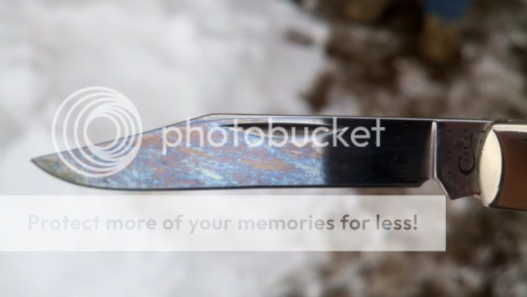

Didn't realize a patina happens so fast

I sat down to this wonderful dinner of grilled ribeye with scallops and shrimp and mushrooms, baked potato and corn. Yum...
This case Texas jack was nice and shinny!
See next post...

I guess the wax doesn't work. I had the same meal again tonight, leftovers. Might as well do the vinegar trick very soon.
if you don't want patina showing up on your blade do you polish it alot? also, if one doesn't want a patina on a cv steel blade, why buy a cv over stainless steel?
I have been polishing it with my dremel and then some maas polish. It's only because of the acidic food though I believe. I've used on other things with no show of patina.
I wanted carbon because a lot of people think it's "better". Ease of sharpening being a big plus. And basically I wanted something different, I have a bunch of stainless blades.
I don't think you should force a patina really posted the link for reference. Letting it come natural is the best. Be careful with the Polish with food.
That's the beginning of a good patina, I'd leave it if it were my knife. Eventually the patina will darken, and give the blade a bit of protection from corrosion. You see a lot of those old butcher knives thatare almost black in the blade, but no rust on them. Leave it go, let it darken.

Sigh. Patina is rust. It progresses less quickly than red rust.
Sorry. Sometimes I just have to say it.
Ok! I will listen to the seasoned traditionalists. I just got some mineral oil and will be using that only. We'll see how she looks in, what, a few months?
Id rather have patina on the blade than Car Wax if I am gonna eat with it. To each his own.
If you want to keep it shiny, try Renaissance Wax. Been using it for quite some time now and that patina that was on my 01 blades (purchased used with a patina started) has not advanced at all.
