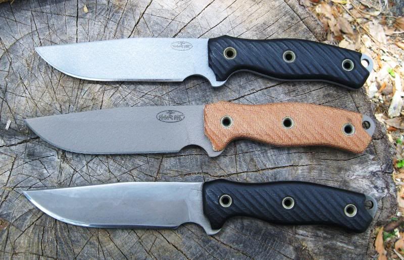

Hard to see the temper line in this old pic, but:
:thumbup: :thumbup:
I stripped my Camp Tramp and Chopweiler today. You can see the temper line in the Chopweiler in this pic. The Camp Tramp has one, too, but it doesn't show here.

When u guy say "stripped" do you mean you've taken off the black powder coat on the blade?
That's exactly what it means. Very easy to do with paint stripper from the local hardware store.
