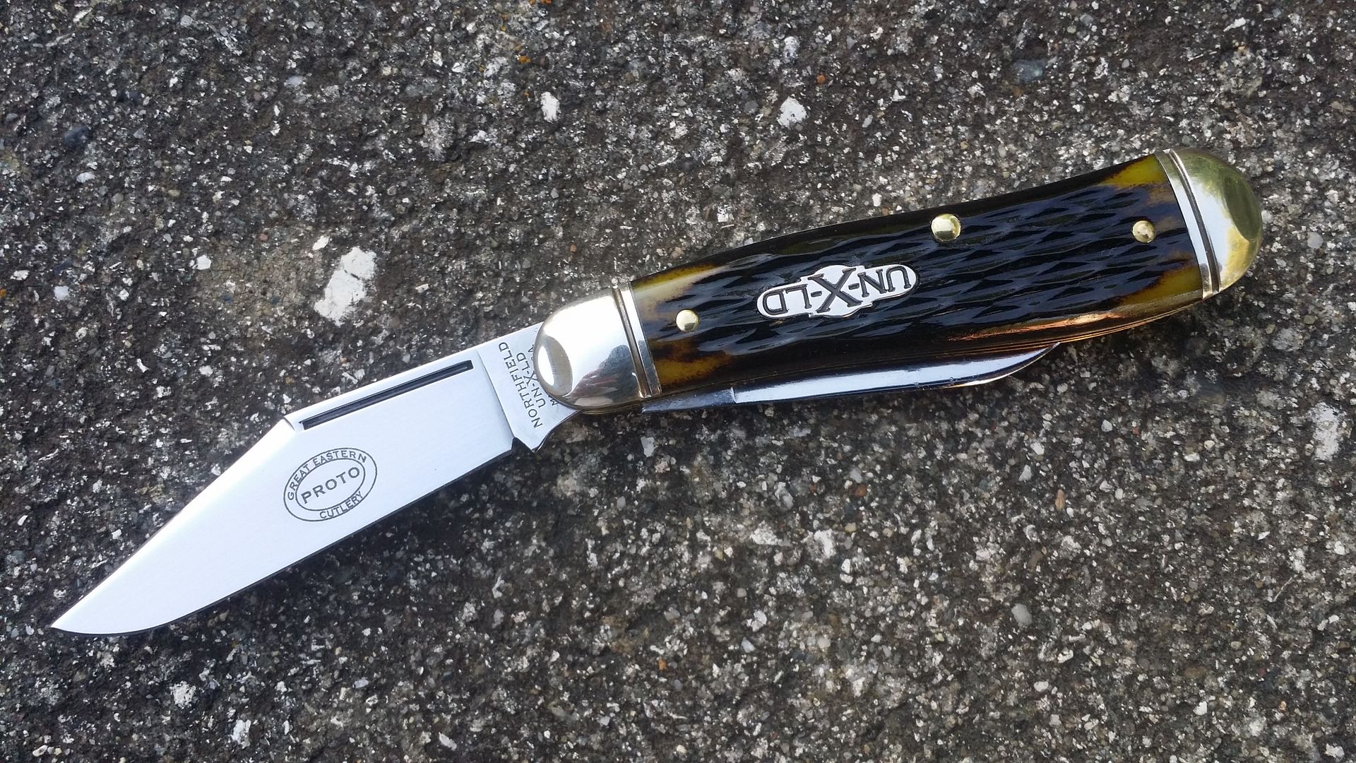

Primitive bone #56 jack with Bisley 45 Colt.
BisleyDogleg.jpg~original

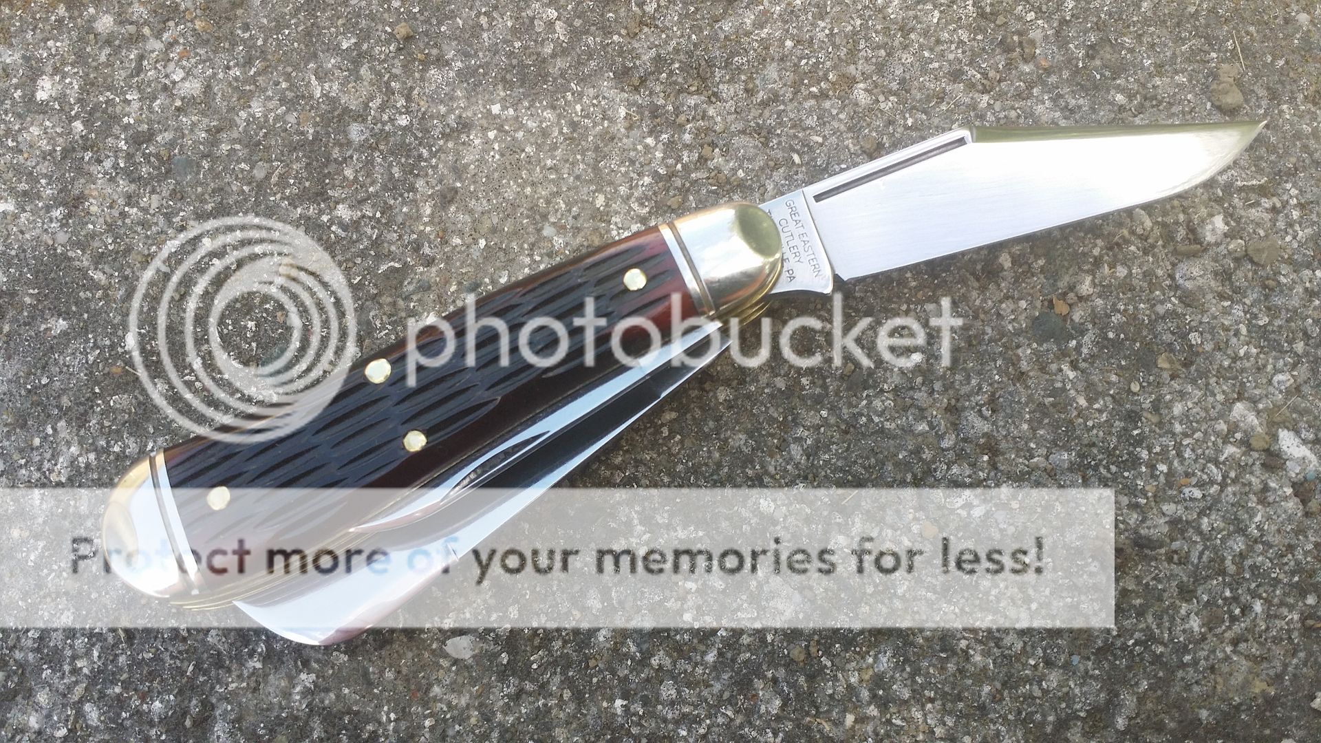

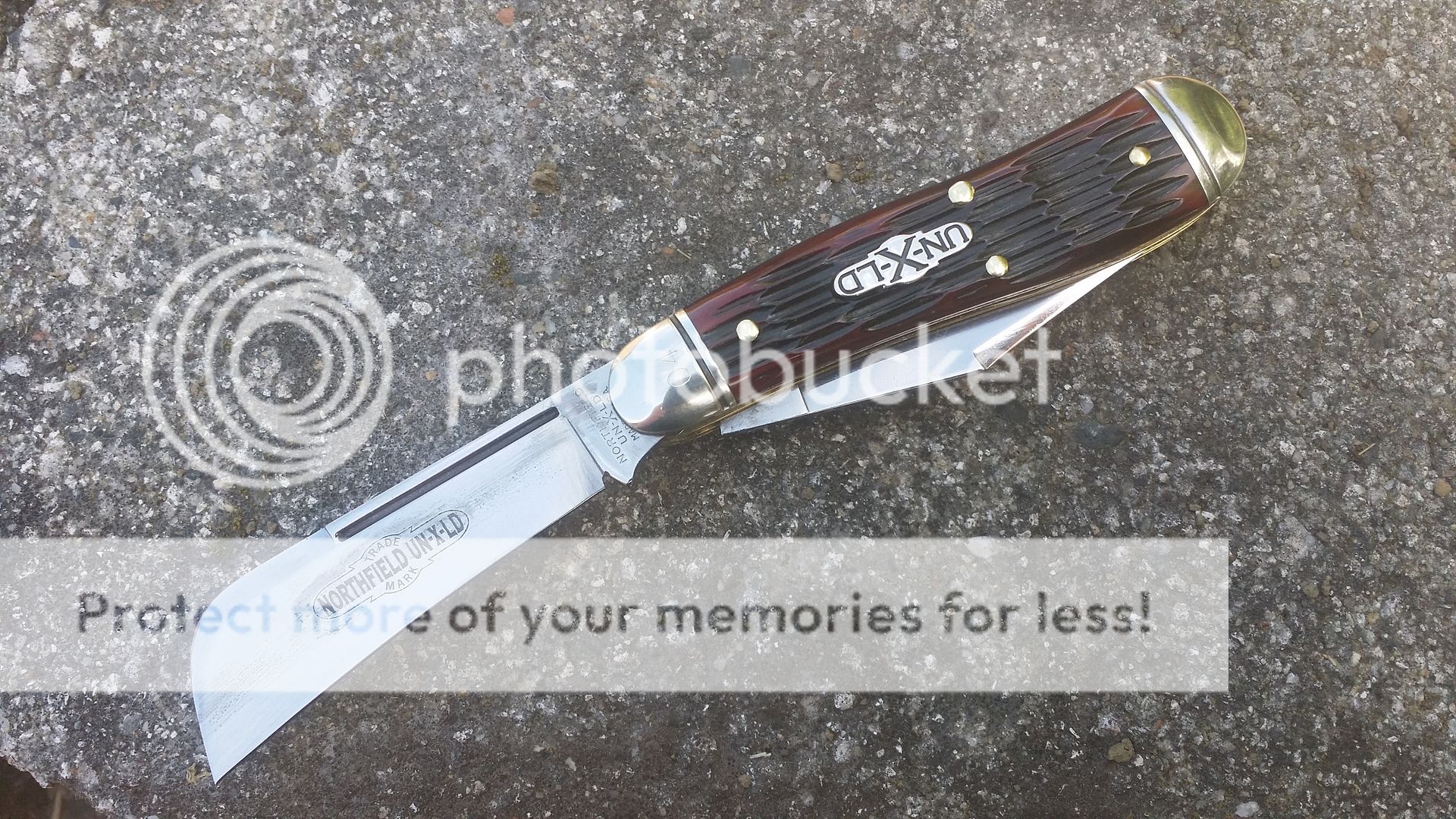

We need some pictures here...... I really like the double long pulls in this Weaver jack. What a unique, useful knife! Personally I prefer the spear blade on the 55, but the wharncliffe seems to be the preferred shape. Good luck finding one without a linerlock. They disappear instantly on the exchange.
Very happy with 55.
Great jigging, Wharncliffe blade, and liner lock. I didn't know if I would like the LL, but it has grown me. Now I enjoy it.

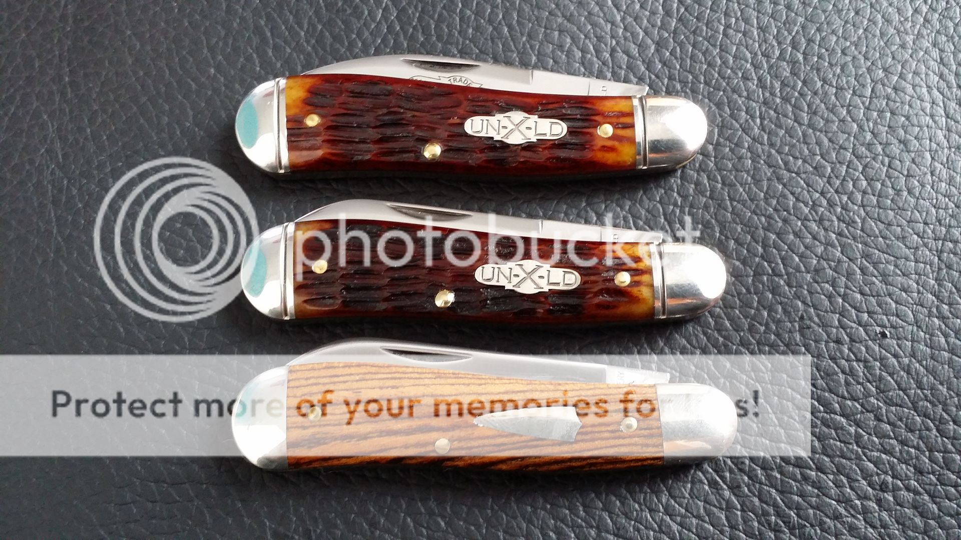

Hey draggat, those are gorgeous! Any chance of a group shot with the blades closed? I'd love to see how they ride.

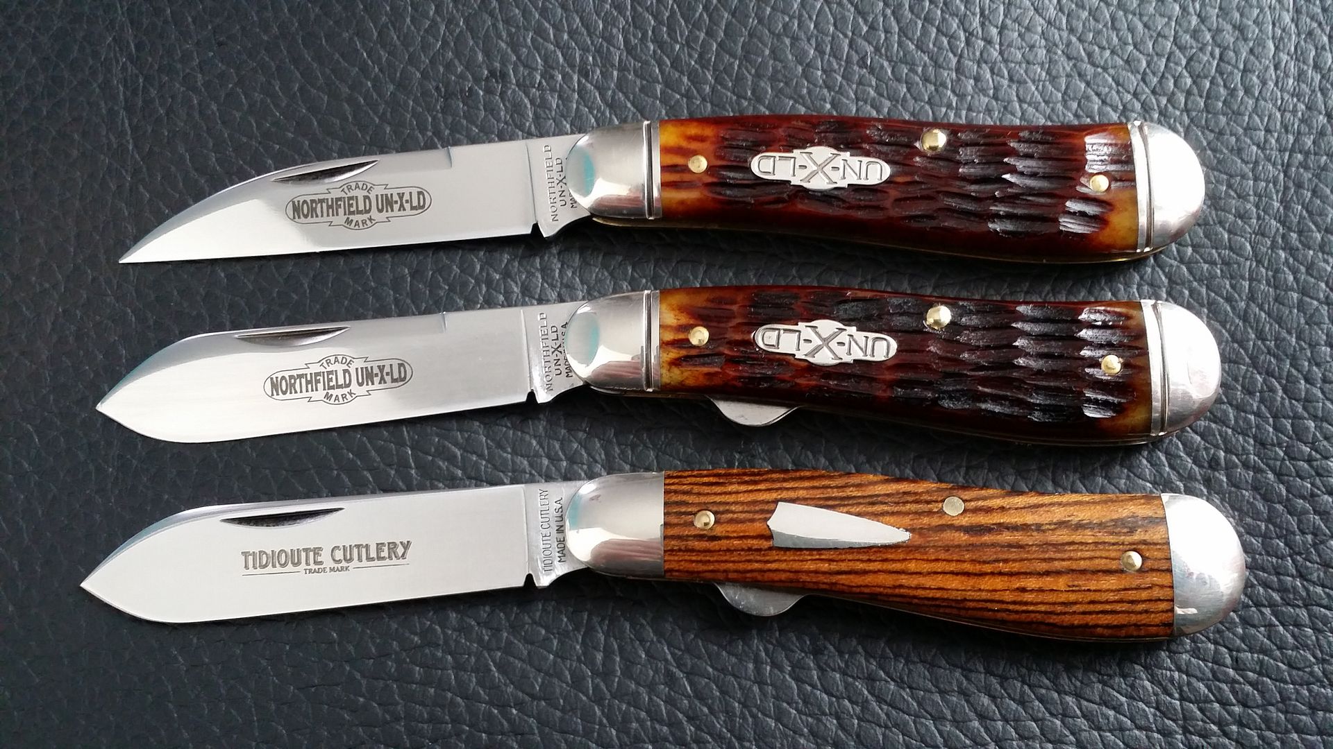

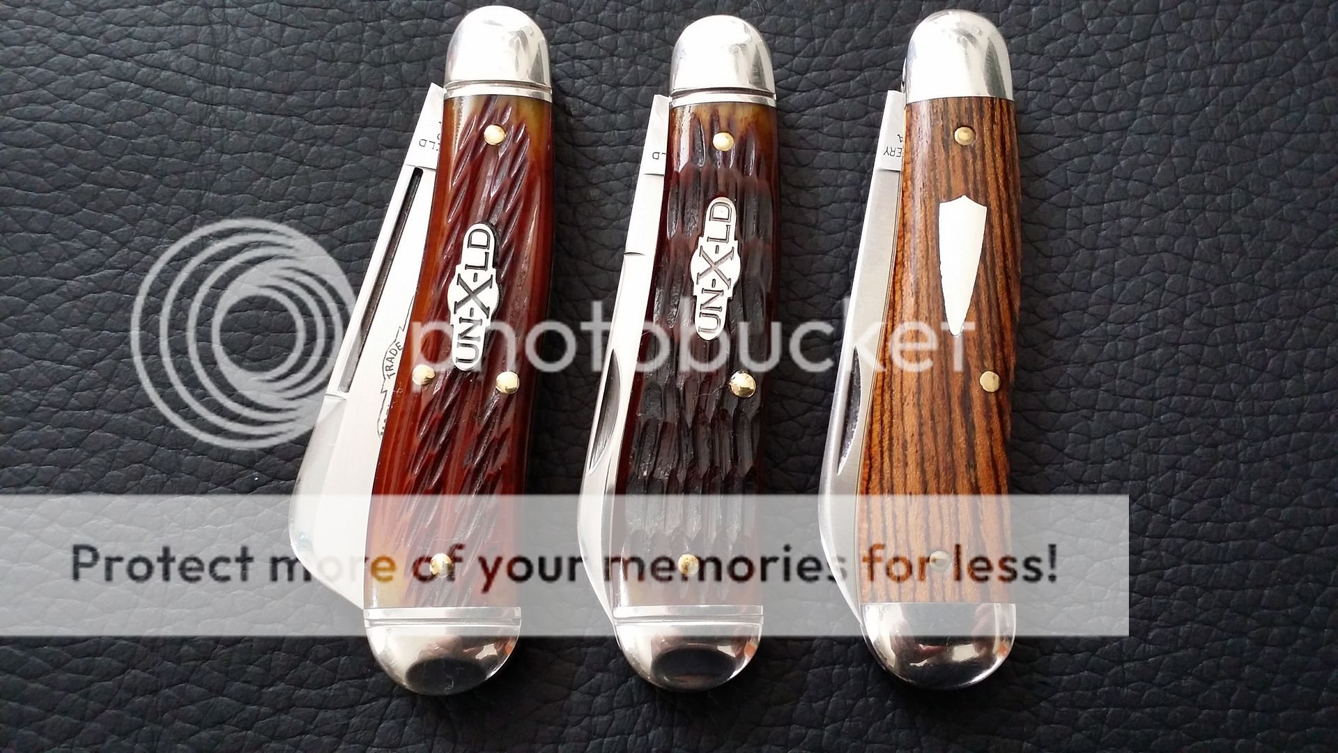

Thanks! Here's what I have at the moment.

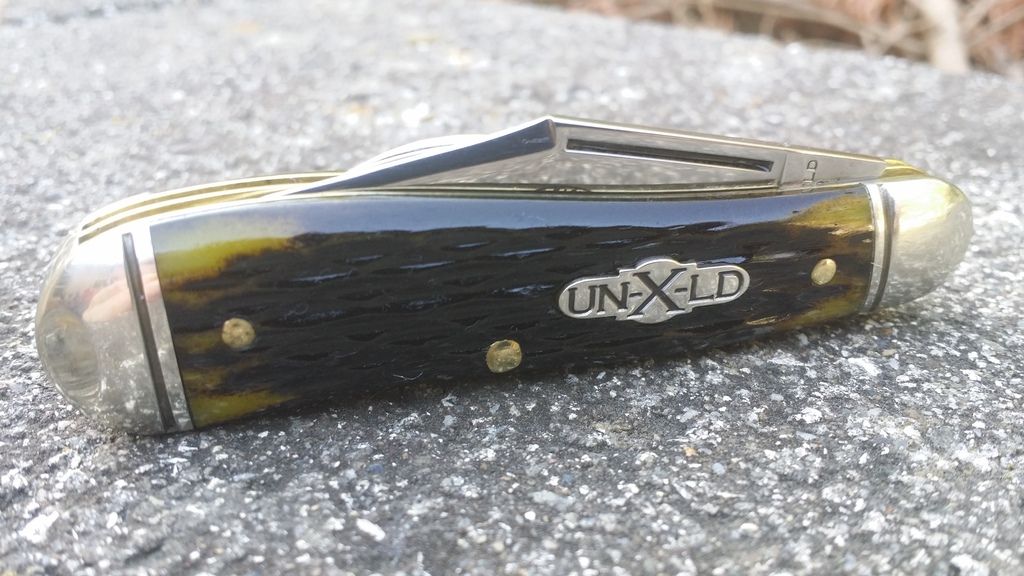

The tip on this clip 56 rides really low, which I like.
Top is a wharncliffe. Other two are spears.

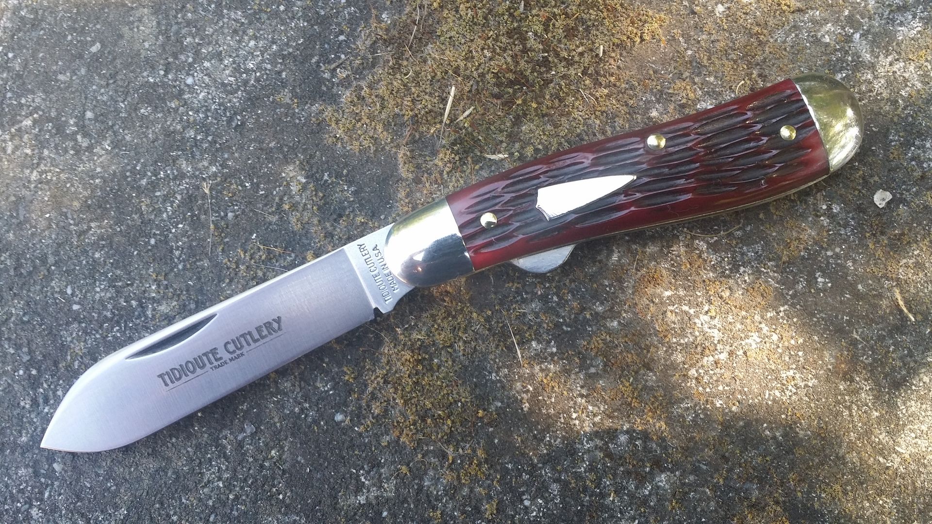

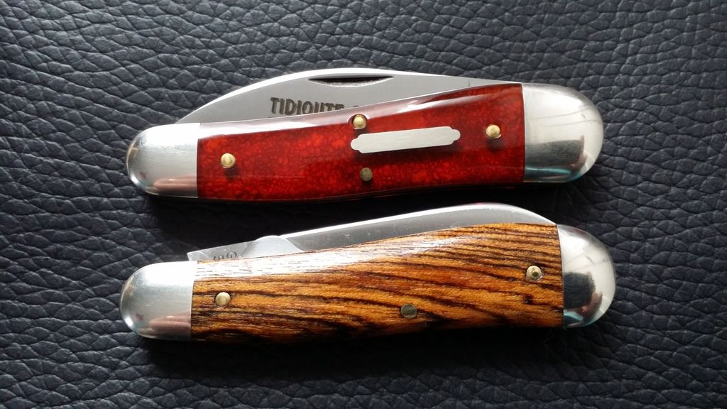

I don't have a shot of the 3 blade Weaver Jack fully closed, but here's a 2 blade (modified sheepfoot and pen) next to 2 spears.
Finally, a 55 spear next to the 57 half whitt, which is the same frame but reversed with a larger bolster.
