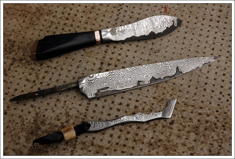

Since I have some knives made with different steels, I thought of posting them together to show the differences in the resulting patterns according to the types of steels used.

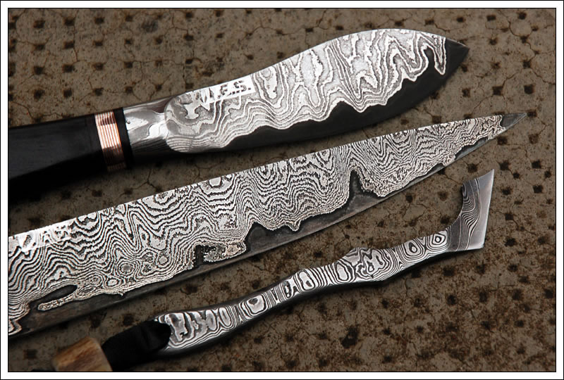

Top knife is a Nessmuk made of stainless 304 and stainless 416, with a D2 core: stainless san mai.

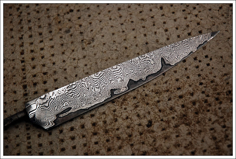

Medium blade is carbon 1070, stainless 304, with a 5160 core: half stainless san mai.
Bottom scalpel is carbon 1010, carbon 1070, with a 5160 core: carbon san mai.

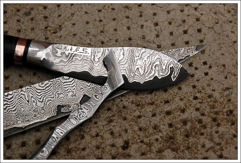

Close up.
You can clearly see the differences on the union lines depending if all stainless, carbon/stainless or all carbon steels have been used.

I will make a tutorial on making 304/416 with a 440C core soon, it's the exact same method I use for D2.
You shouldn't have a problem with any of those combinations if you use a cannister with the paper/kerosene trick.
