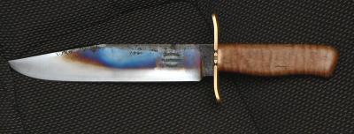

L-6 - differential treatment. Can ya tell?
WYK
