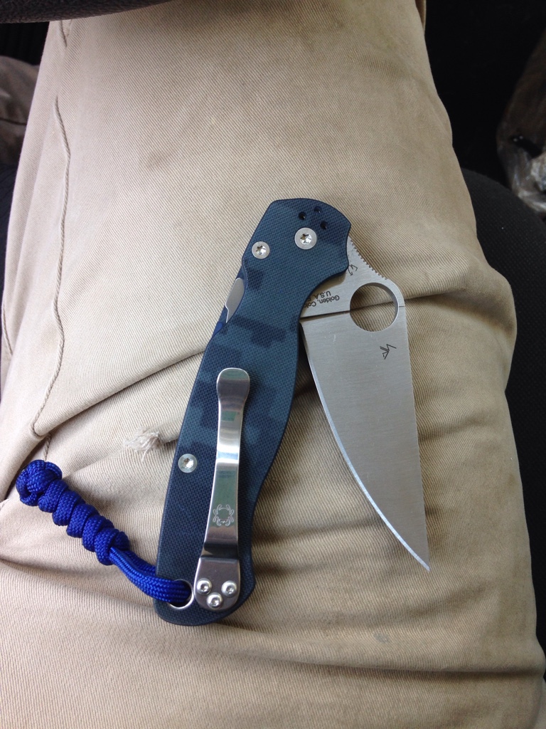

Didn't like the factory digi cam, and I didn't want to buy a black pm2.
So I dyed the scales! Royal blue rit powder dye. The scales sat for roughly 6 minutes total. I'm happy with it, came out exactly the way I wanted.
Thanks guys! I was surprised with the good results. I'd read some horror stories about rit dye jobs simply not working right. One scale is just a tad bit lighter than the other one, but not enough for me to go back and redo the dye, risking making it all too dark.
I saw some pics of a red dyed digicam a little while back, and I've wanted to try blue ever since.

I'm considering putting it in the bath one more time, the pics actually bring out the blue a little better than real life. In real life, the scales aren't quite as bright blue as they look in person. I'm wanting to maybe darken the blue just a little bit.

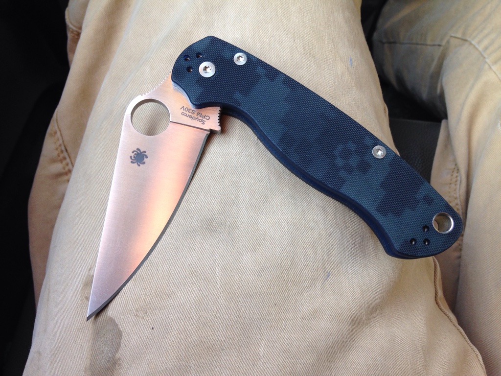

See the difference in the scales?
I can't decide if I need to go darker or not.

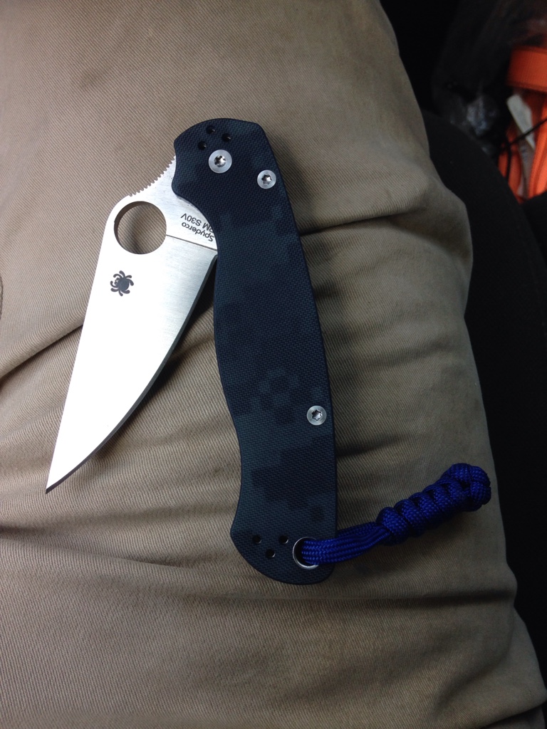

The lanyards going to change too. It was an experiment, I normally carry in my front right pocket with no lanyard, this one is getting a deep carry clip and is going to stay in my right hip pocket so I'll need a lanyard.
Going to make a nicer lanyard with gray paracord (to enhance the blue of the scales) and maybe a stonewashed bead. Pimping on a budget!
Did you take the whole knife apart and dye the G-10 without any parts or did you just dip the whole thing? Did you heat the dye? I've tried dying G-10 and FRN before using Rit powder and for some reason I can't get it to take.
I'd like a more detailed description of this too, I really want to try this out myself, dark blue G-10 looks cool as all living hell.
I disassembled the entire knife and dyed the scales only. I heated the die, and mixed it with vinegar per the rit instructions. I think I am going to do a second die step, to get the scales a little bit darker and more even, I'd be happy to do step-by-step instructions and pictures?
