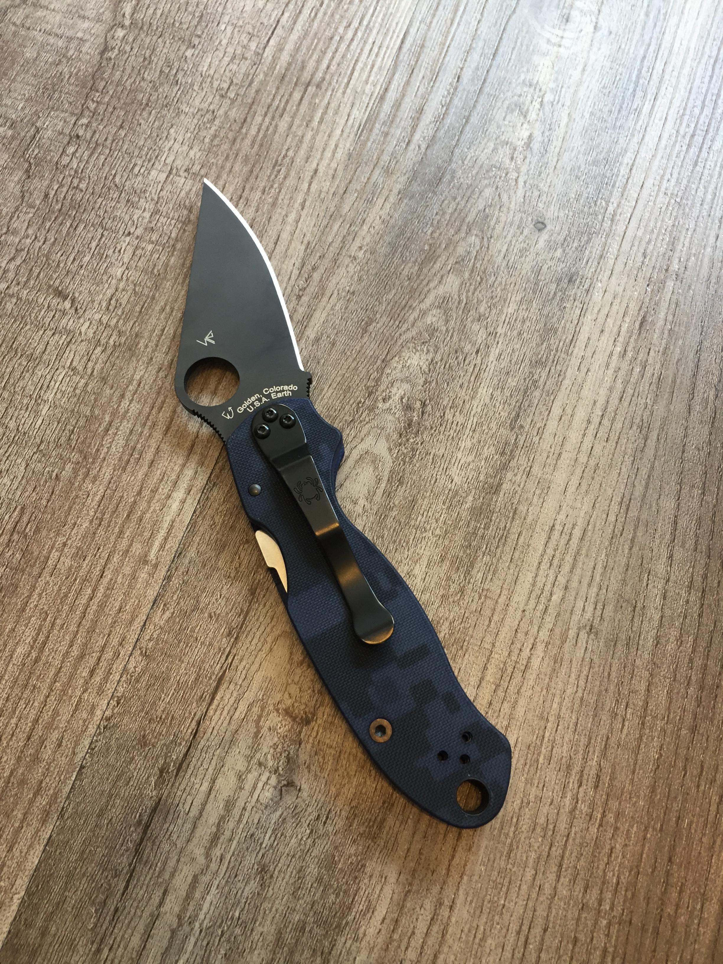

Digicam pm2 dyed blue!
Yeah I used vinegar too. I wish I knew what I was doing wrong. Maybe just super resistant G-10? When I tried FRN it was a yellow Spyderco Ladybug and I even left it overnight because it wasn't taking.
Did you dip the scales together?
I boiled the scales in clean water to clean them off, then boiled half a pack of rit dye in water and vinegar. Probably 2 cups of vinegar and the same amount of water. I brought it to a rolling boil, left the pot simmering on the stove while I dunked the scales together. I left them in for 3 minutes, pulled one out, saw some color, put it back in for another few minutes, checked them again, then pulled them both out and soaked them in clean water for a few minutes. That's all I did, they started taking the color almost immediately.

Did you take the whole knife apart and dye the G-10 without any parts or did you just dip the whole thing? Did you heat the dye? I've tried dying G-10 and FRN before using Rit powder and for some reason I can't get it to take.
RIT dye in water with a little vinegar, boil the scales for 10 minutes or more. With a knife like the PM2 in S30V you can just boil the whole thing.

Would you happen to remember the recipe you used, including amount of water/vinegar/dye, the kind of dye (color, liquid or powder), and amount of time you let them boil for? That looks really good I probably want mine exactly like that, if not ever so slightly lighter.
2 cups water, 2 cups vinegar, 1/2 packet of powdered RIT Royal Blue and boiled for a total of 12 minutes. I pulled them around 6 or 7 minutes and wanted a touch more color. 9-10 minutes probably would have been perfect.
