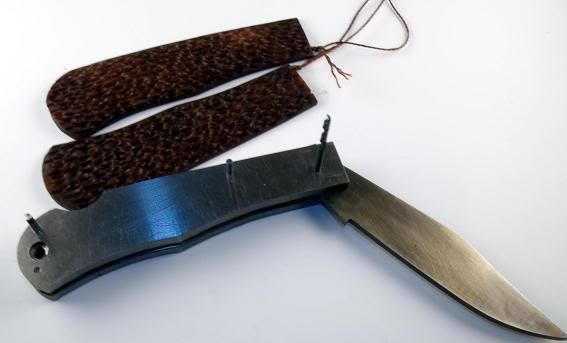

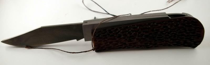

Have a weird request here...
I know the blade length, closed length, and OAL of the knife but would like to make exact measurements of other parts of the knife for a possible reproduction custom. I want it to be as close to the real thing as possible
Does someone here have the knife and would be willing to take measurements of bolster length, handle dimensions, spine measurements, and whatever else you can think of?
That, or maybe you can ship your non-original, assuming you have one, for inspection. I’ll pay shipping and insurance both ways.
-Eric

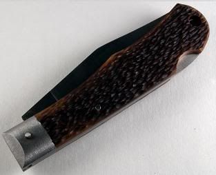

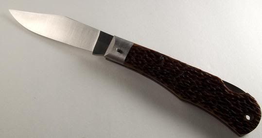

Bolster length 5/8” long, width ¾”
Bone/Stag length 3 ¾” long, ¾” wide at Bolster, 7/8” wide at little middle bottom pin, 1 1/8” wide at end point
Spring is 4 1/8” long
Hope this helps
That should work. I appreciate you taking the time to measure the handle for me. :thumbup:
-Eric

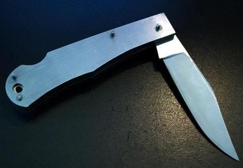

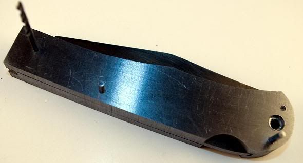

I wish I could show more but those are all the pictures Ken has given me.
Opps... I guess I gave away the answer. ;)

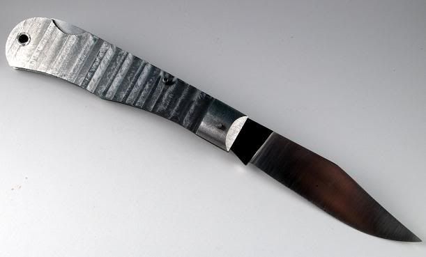

Here's another picture from Ken Erickson I got this morning with grinds done to the D2 blade. The next step according to Ken will be to mill-out the bolsters from the stainless frame material.
