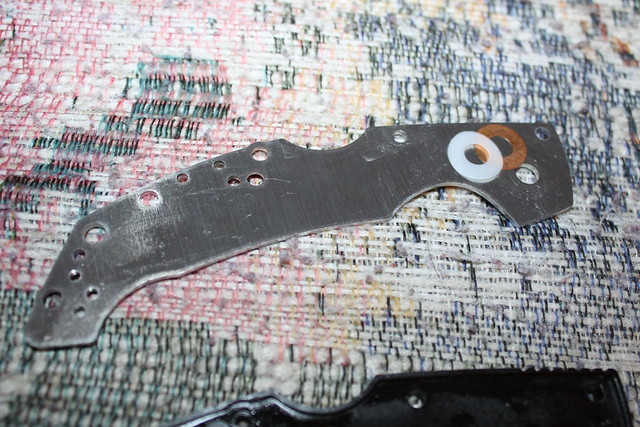

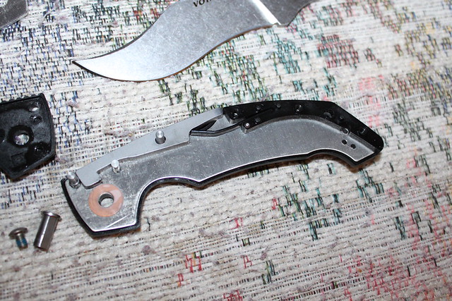

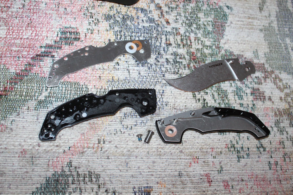

First one is Cold Steel Large Voyager - Vaquero

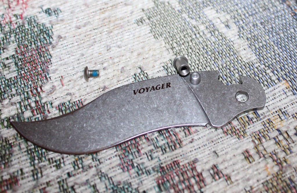

I was surprised by how tight the Voyager is all around, the 4 washers, and uniform screws with loctite. Even without any screws in place it is still very solid. Only $38!
In the next photo with screws removed and grivory slab left off, it still has 100% perfect lock-up with absolutely zero blade-play :cool:
Beefy pivot bushing and thumb stud

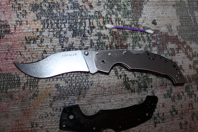

It's been a while since I took a folder all the way down to look it over and give it some love, had to grab a $6 set of mini screwdriver bits at Walmart.
Started out with the Vaquero so I could evaluate how the blade shape does doing little martial arts experiments in the back-yard. So far I like it a lot.

OrdnanceBubba, how thick do you reckon those liners are? I read that they are T6061 aluminum, must be pretty light!
They don't even seem like aluminum to me, I think because of the thickness...rushed and forgot to compare it to the blade before putting it back together. The grivory slabs are basically just a textured cover for the liners - they are very thin. I think it's even stronger now than I did before breaking it down - it's beefy for sure.
Adding this to the knife assembly/disassembly resource thread.
Good to know! Look like a few mm thick from the pictures you posted.. maybe 2 or 3

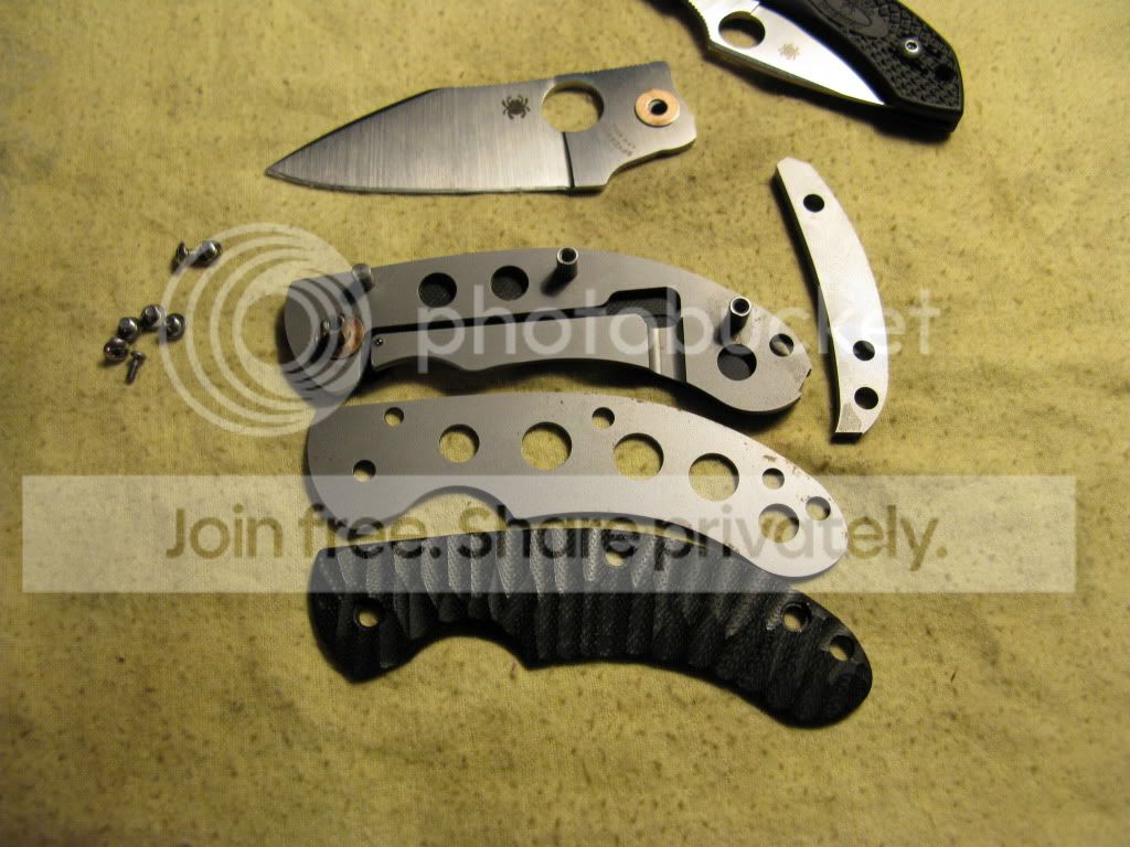

seelow, thanks for adding those, especially the PPT :) Took me a few seconds to realize why the Shallot had different size washers :o
