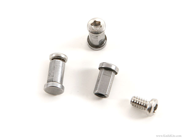

I'm in the process of disassembling a PM2, and I have run into a hitch. The pivot screw does not seem to want to come loose. I'm using a T8 torx driver on it, which fits well enough... its just that it won't budge. Does spyderco use loctite on their pivots? If so, what would be the best way to go about breaking the seal?

I don't know about the PM2 pivot, but for my Chaparral, one side is actually the female end of the screw that is not supposed to turn. The female end is a semi-circular tube that prevents spinning when the actual screw is turned.
See picture below:
I don't know why, but for some knives, a torx pattern is cut into the female end, and that's really misleading.
In that case, I have tried both sides. If it does happen to be that type of pivot, then there's a 50% chance that I'm already screwed, b/c I've already ruined one end.
