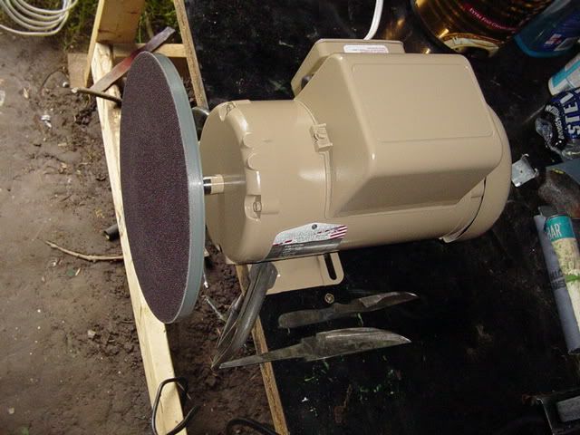

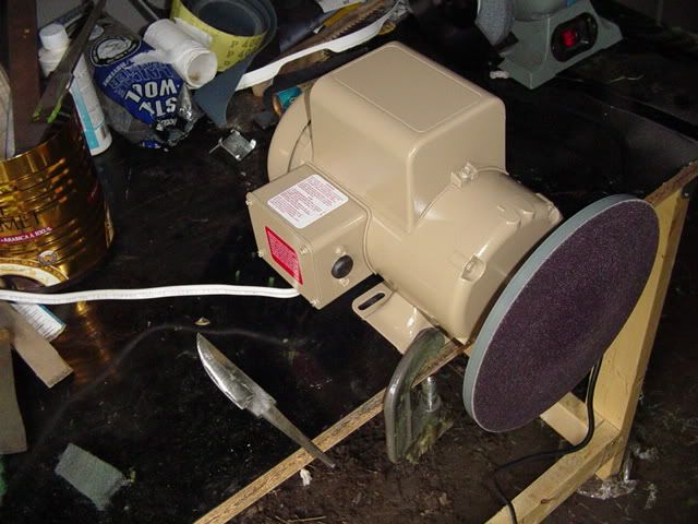

Greg Obach said:
Hi Mike
the disc is this one from K & G.... its a 9 inch steel disc...
http://www.knifeandgun.com/catalog/9__sanding_disc_1530838.htm
no micarta ... just the a 60 grit aluminium oxide psa disc on it...
i love it..... shoulda made one years ago...
Greg
Ah, OK. I guess it was just the angle of the shot. I have the same kind on one of my motors. The one on the right. It's a little dark and hard to make out.
very nice set up.........with speed controllers too !!
excellent set up...
i'm saving my bucks for one
thanks for the pic
Greg
