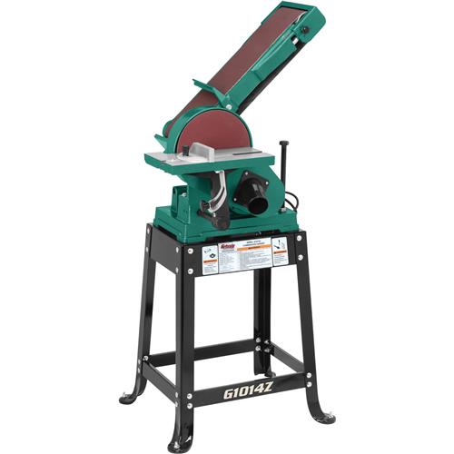

I have multiple disk sanders. I leave one set up with the tilt table at an angle for dovetailing bolsters. It is part of the 4"X36" sander I got for flattening handle materials. It's one of these. Costs about $99 new and I use it a lot.
I have a Grizzly 6"X48" with a 9" disk as well that I use for more heavy duty work and I leave the table on that one square to the disk. (I got it off Craig's List for cheap.)
I can also remove the table on it when necessary.
I could use my KMG for most of that kind of work, but having the extra disks available saves a good bit of time in the shop
Keep an eye out for deals and you can find what you need as you go.

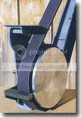

OK, if the suggestion is to just build one, wouldn't the Coote sanding disc attachment work the same? I'd still have to build a table for it. If you haven't seen the Coote disc, it mounts to the side of the large contact wheel.
Do you think it might be easier to build a table for a stand alone disc sander than to try and mod the Coote?
