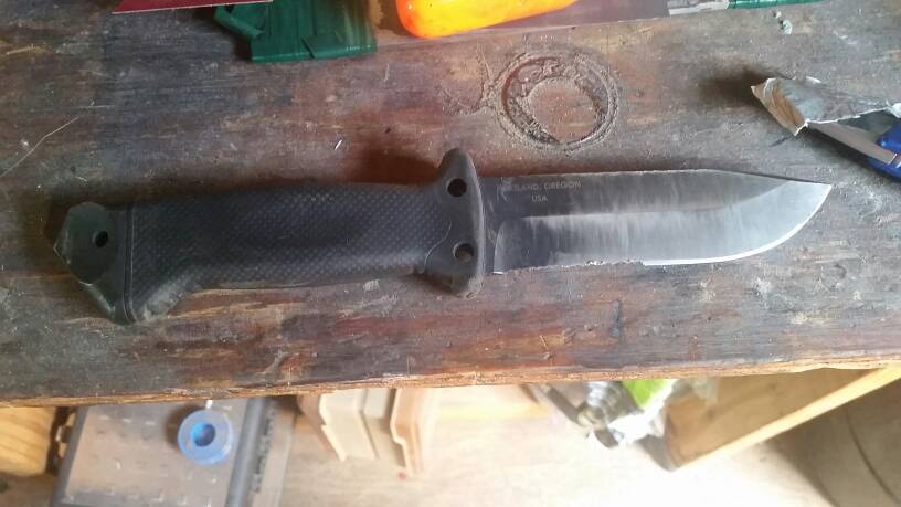

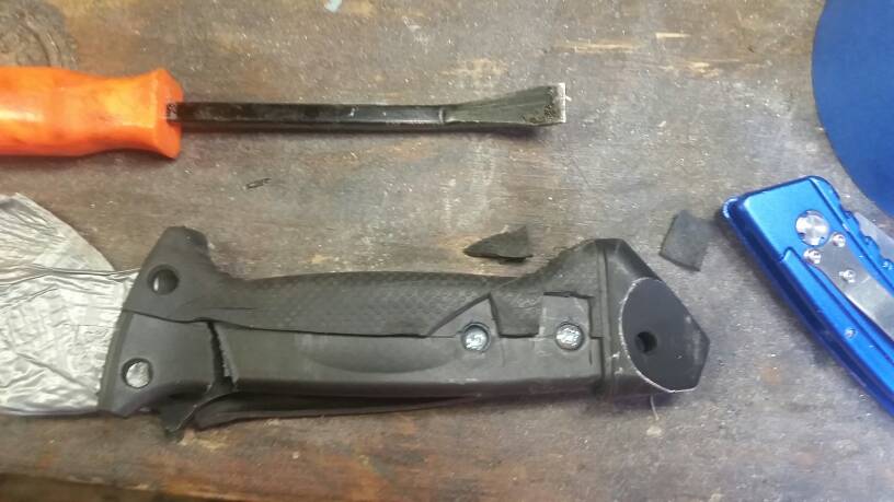

This knife sits next to my woodstove and has been used for nothing besides splitting kindling for many years. The handle finally started getting loose so I decided to see if I could rehandle it because, why not?

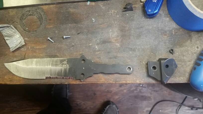

Hmmm... not what I was expecting. Looks like I may need to make my first hidden tang. The pommel is probably a lost cause.
I'm headed to the cabin for a few days so I have plenty of time to think it over.
I'm open to any suggestions!

Personally, I would grind the guards flush and then use the original guard/handle attachment holes as new tang shoulders, and grind/file off the excess. From there, do a hidden tang. Not sure it would be as strong as the original, but it would look a lot better and give you a lot of handle options.

it would be easier to do a frame handle with 3 pieces of wood. you would omit making the hidden tang slot which is not much fun, and avoid reshaping the tang.

I would do a mortised handle ( or a frame handle) and use Corby bolts through the four holes (three in the tang and one on the pommel).
Use good 24 hour epoxy and screw the Corby's down snug.

I think that is what I'm going to try, but I think I'll try to drill a new corby hole in the tang. The 2 front holes were never used for bolts, but were holes for lashing the knife for a tacticool spear. I plan on grinding the little nubs flush and I'm afraid it the holes will end up too close to the edges.

Although I'm not impressed with how it is put together, I can say that this knife has withstood a life of abuse that I would never attempt to put another knife through. Literally nothing but battoning for the past 6 years. I wouldn't try to claim warranty because I feel it lived up to its purpose.
I believe the tang and pommel are separated to keep the handle completely insulated from electric shock.
