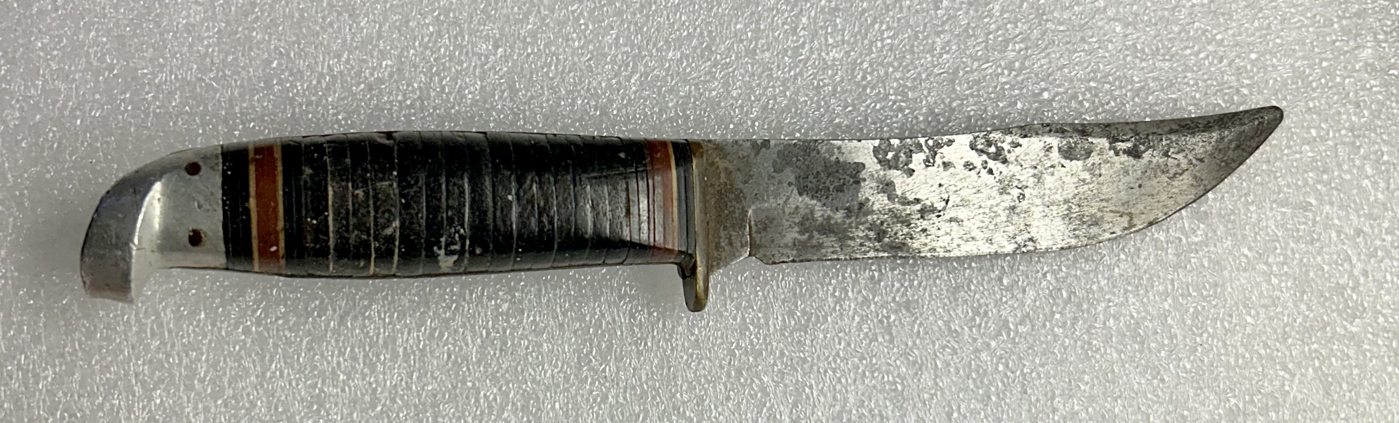

Anyone ever make a distressed sheath?
One that looks as old as this old Boy Scout Knife?
Top tips? Tricks?
I’m thinking it’d be odd to put this old soldier in a shiny new sheath.

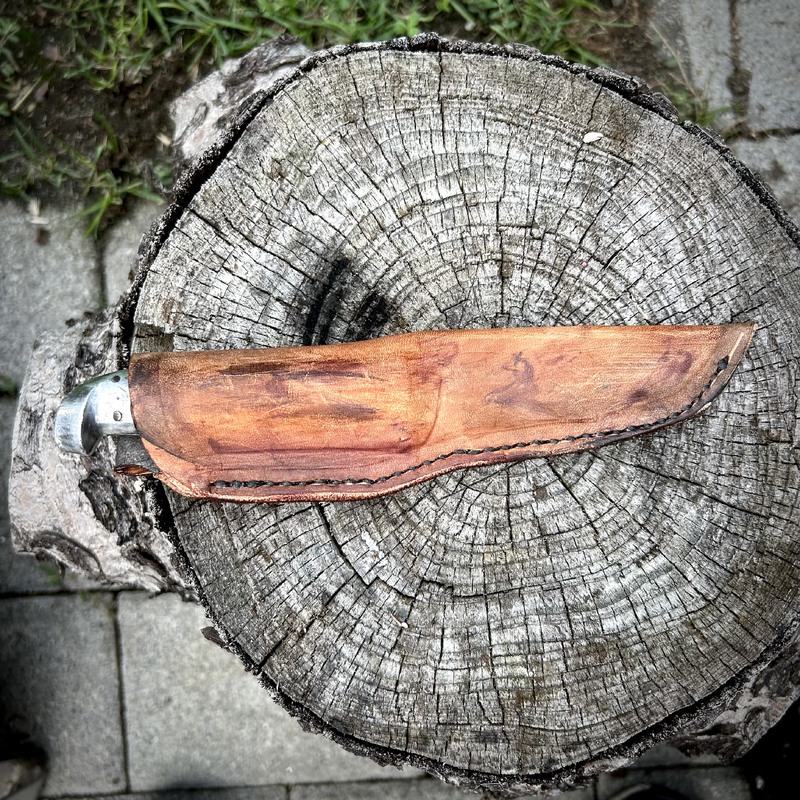

Well here it is…. Since it’s pretty much an experiment I knocked it out in an afternoon.
Did the whole process while the leather was still “wet”
I started with Russet dye & a Qtip, which soon devolved into rolling the Qtip with my gloved fingers and then an alcohol soaked rag.
Added some mahogany dye and a couple smears of black antique.
All with the same rag.
Texture was applied with 2 different sized pruning saw blades, a rock (scraped across the surface) and some very coarse Emory paper. Oh and the bone burnisher.
The scraps that I stepped, pounded and hit on with rocks road and gravel didn’t look worn. Just like a really bad embossing job. And they got full of dirt and grit.
I’m pretty happy. Think I may finish it with sno-seal so it’s not too shiny and pretty.

Very cool! Matches the blade well!
