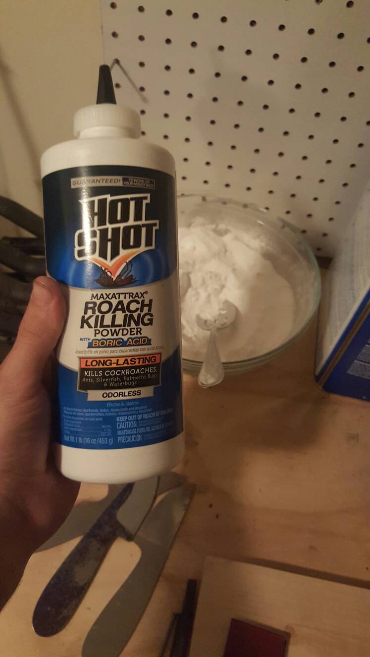

I've been using roach poison for a couple yrs as an anti-scale for carbon steels. Heat blade a small bit so powder melts forming a clear glass looking coat. Stays on during HT just fine, then soak in hot water and melts right off.
Ken H>
Roach Powder - Boric acid. When heated it melts and forms a thin layer of what is called "borax glass", which helps exclude oxygen. The glass is water soluble, so a soak or boil in hot water removes it.

I got this stuff at Home Depot for 2.98.
Sent from my SM-G925F using Tapatalk

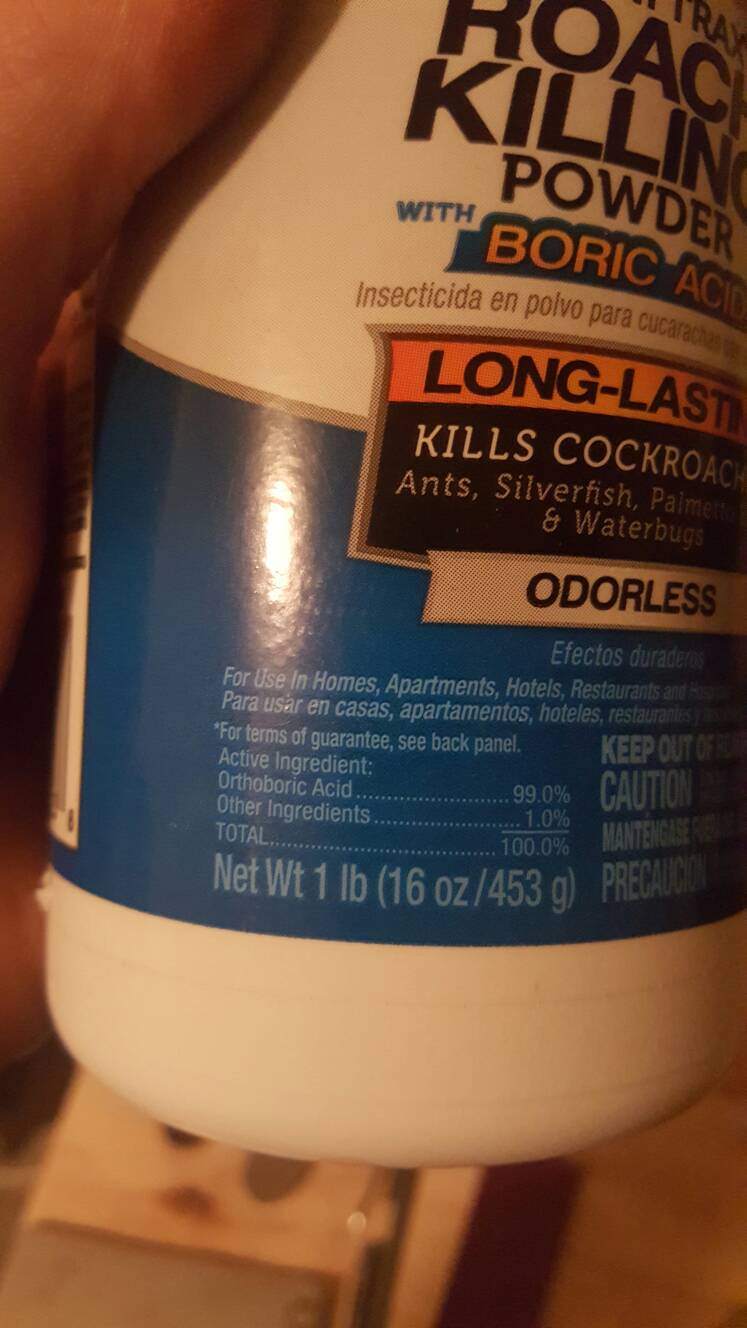

The problem with using something like generic roach powder is that if you look at the ingredients list you see it is marked "active ingredients". That is 99% boric acid, but the inactive ingredients .... which are not often listed ... may be as much as 50% of the bulk. These can be lime, gypsum, silica, chalk, etc.
99.9% boric acid sells for about $2.50 a pound, so it is just as cheap as the unknown grade roach powder.
I just checked eBay and a five pound bag is $12.50 with free shipping. 10 pounds is $19.95 with free shipping. If you buy it by the 50 pound pail, it cost a dollar a pound.
It's been working well so far. And if you sand to at least 220 grit it will flake off when you quench.
I am sure it works fine for our needs. I was just pointing out that many folks think it is cheaper than boric acid, which isn't always so.
