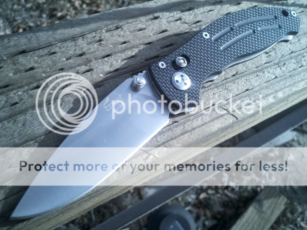

The Enlan EL-04, an axis lock knife that has identical handles to the Spyderco Manix 2; Combining two great designs from two different knife companies.
I chose to use Matte Black color on the blade and pocket clip, for that tactical look :o

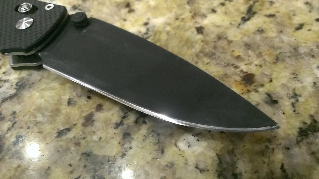

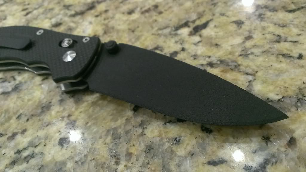

Aluma-hyde II is a thick coating, you can see the texture here:

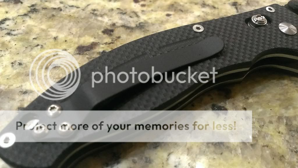

The pocket clip will be the test of wear and tear:
After resharpening (the coating took more than a few passes on the stone to completely remove):

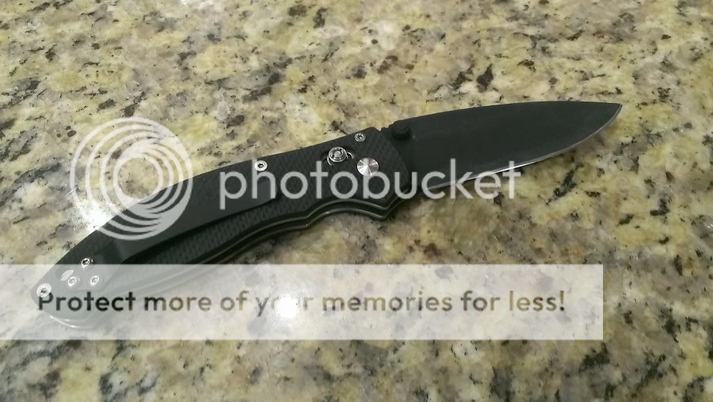

EL-04, tacticalized:
there is some residue on the blade here, dust from the sharpening stone.

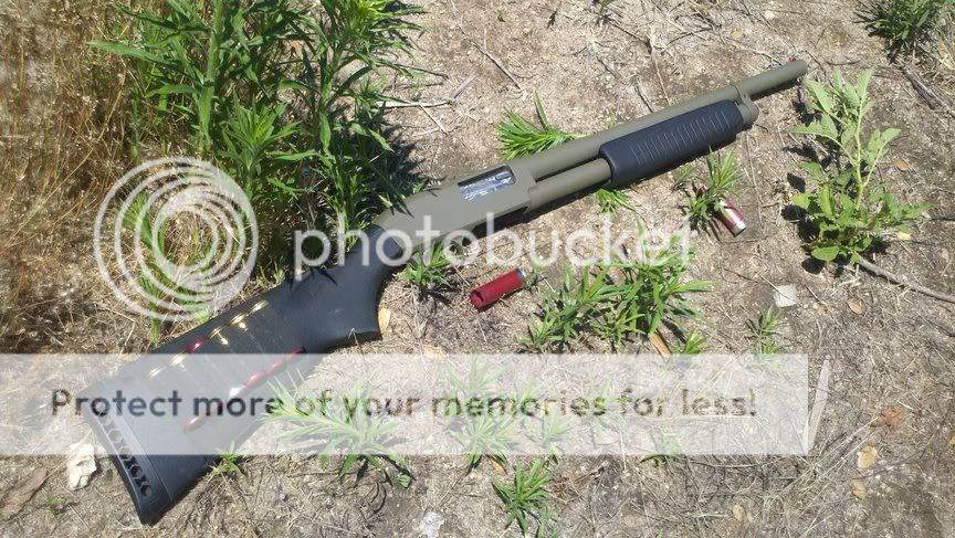

And just for giggles, here is my shotgun I Aluma-hyded over a year ago with OD Green:
