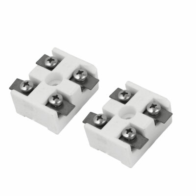

I was able to get my homemade oven up to 1796°F however the ceramic terminal block in between the high temp cable and the element now has melted lead in the terminal block. any suggestions it's a 30 amp rating and I'm using 120 VAC?
Picture ?
Did you twisted Kanthal wire from elements on ends ?
No I did not, I'm assuming I should have? I tried uploading a pig but it's telling me I need a URL which I don't have
online instructions often refer to twisting the end wires (where you have doubled back the long end wire to produce the twisted section, or better yet twisting AND bending 180 degrees and doubling over at the contact point to reduce the resistance (and thus heating) at that point. You want the wire heating inside the oven (single strand), but NOT to heat at the connector block (you do this by NOT having a single strand attached to the connector. You really can not have "too many" parallel strands there - you just need the bundle to be small enough to fit into the connector.

You can use Imgur for picture. I hope that ceramic terminal block is outside hot zone not inside chamber? I mean Kanthal wire goes thru the bricks out and then on ceramic terminal block , right ?
The terminal block should be a high temperature ceramic block with stainless steel metal parts. Brass screws are 360 brass, which melts at 1700F/950C.

I agree with Cushing that making a proper coil is pretty easy. I disagree that connecting two coils in either series or parallel is bad. If one coil is connected to a proper stainless and ceramic terminal block, two will connect just as easily.
Use connector block like this:
For series, connect the coil to opposite sides of the same terminal. For parallel connect each coil to a separate terminal and jumper/double the power wire to both coil leads.
