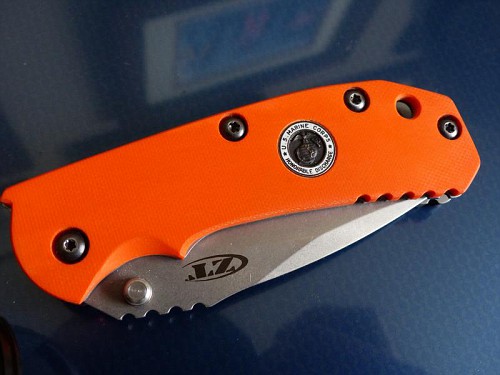

ZT 0550 Made Scale and added my USMC pin

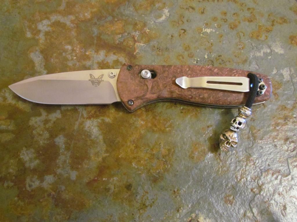

I'm not a huge fan of all the different textures on handle scales, they can certainly be cool but sometimes I think simpler is better. This is probably my favorite example, now I really do love my Ripple more.

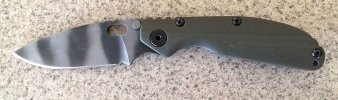

I modify many of my knives, and I certainly enjoy them more. I generally don't do a lot of blade/pivot polishing unless it's pretty rough, but I make ergonomic adjustments to handles, rounding sharp edges, adding scallop type relief to get at thumb studs better. It's amazing how much you can improve the feel of a knife just with a few minutes and some sand paper or needle file (and of course safety glasses and respirator). Many times the changes would be tough to see in a picture unless you knew what to look for. It used to make me nervous, but I've yet to rework one that I didn't like better when I was done, though admittedly a couple have been pulled from the brink of disaster. There are very few knives I keep that I have done nothing to.

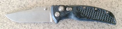

A hogue EX01, I hated the deep sharp index finger relief, so I smoothed it out, I also put a radius on the top of the handle edges that were pretty much 90 degrees.
A strider SMF CC, got a hard user super cheap and remembered why I got rid of my first SMF, that square hump on the back of the handle digs into my palm during extended cutting, so it went away, had to take a lot off the edge to restore it. It went from one of my least favorite to most after the mods.

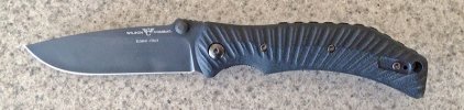

A Wilson Combat ELC elmax that just arrived, this one went from a "well maybe I should dump it" to one I really like now. Did a lot of edge radiusing and added more relief to get at the thumb studs better, it now feels like it melts into my hand.

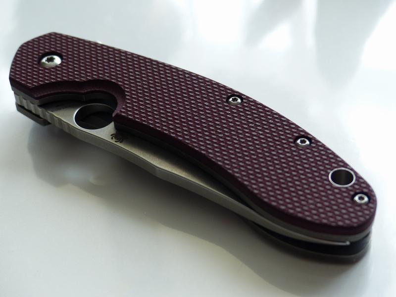

Manix 2, what started as a simple carbon scale/jade ghost liner upgrade almost went horribly wrong. I decided to just use the carbon scales not the ghost liners. That required grinding down all the screws and changing the pivot screws to pan head screws because the taper heads would bottom on the pivot with the thinner scales. I also had to put a couple clip screws in the non-clip side and grind the lanyard tube down a bit, in addition to one long clip screw that went through both liners because with the thickness reduced the lanyard tube was no longer holding things tight. I really like it, but I would never mess with the scales on a Spyderco with that press fit lanyard tube again.

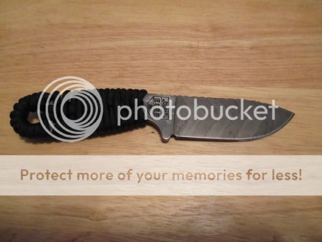

Becker BK14 with cord wrap handle and patina.
