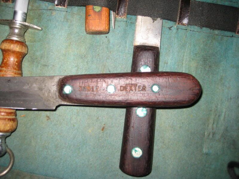

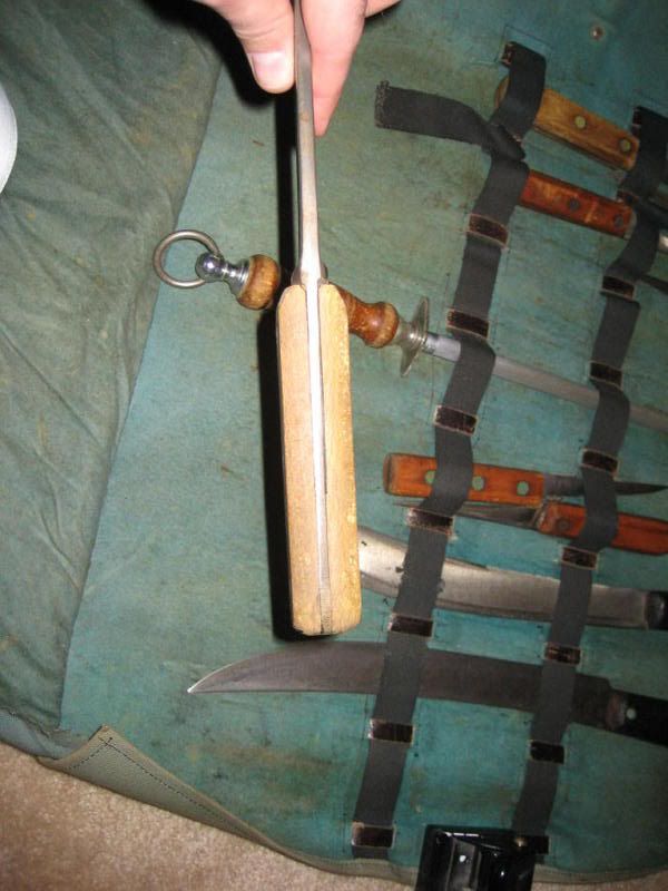

Here are some of the knives I am looking to rehandle.

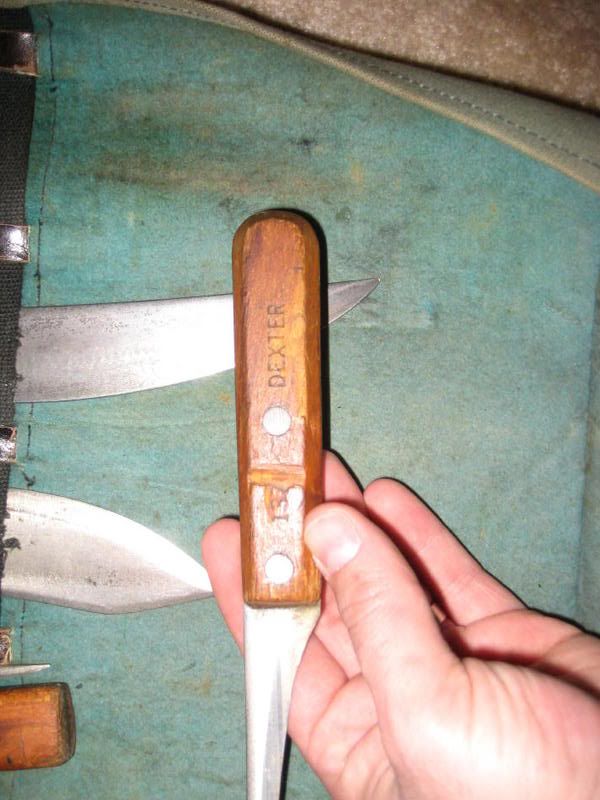

I going to start on one of the smaller boning knives, I think. My thought is that if I mess one of those up it won't be as bad since I have a few of them.
Ideally I'd like to complete this one myself and have it look nice and be of quality work.

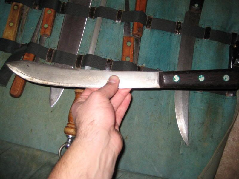

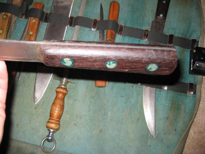

Some other pictures of them.
Those are cutler's rivets. The big knives have kingwood scales. I believe you can do a good sanding job on them and have them looking really good without rehandling. Sand them to 400 grit, and then buff with 0000 steel wool. Finish with paste wax or neutral shoe polish.
