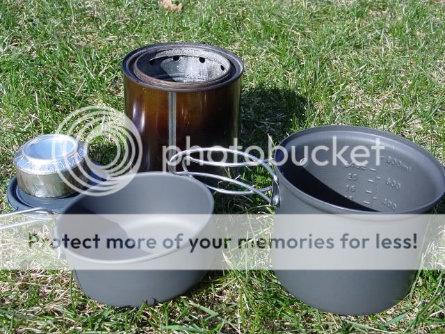

Same stove as posted above. With Coleman pots= huge value. I also include my alcohol penny stove that is DIY. I have not found a better system for cooking for me.

Take a look at the "One Egg Wonder" from T-Fal. All of about $6 at Target or Fred Meyer. I cut the handle down more to ease packing than for weight savings. The skillet weighs 4.2 oz. The lid was custom made by 4 Dogs Stoves and adds less than an ounce. Despite its name, I have cooked two eggs at a time in it and it makes a great bannock/skillet biscuit.

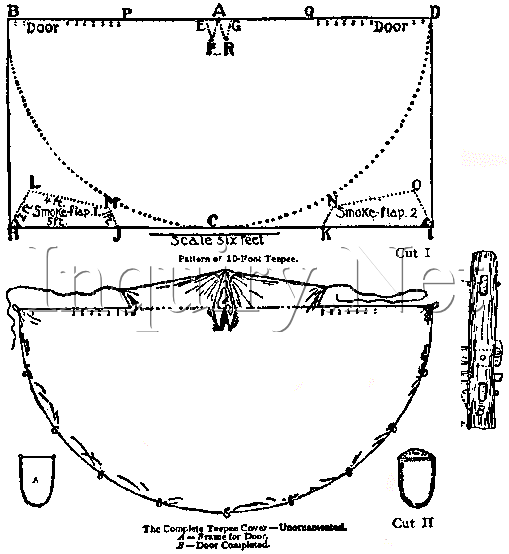

Seeing the tipi posted, I thought that I would share the one I made with a friend this summer.
We recently took it up to the BWCA for some winter camping.

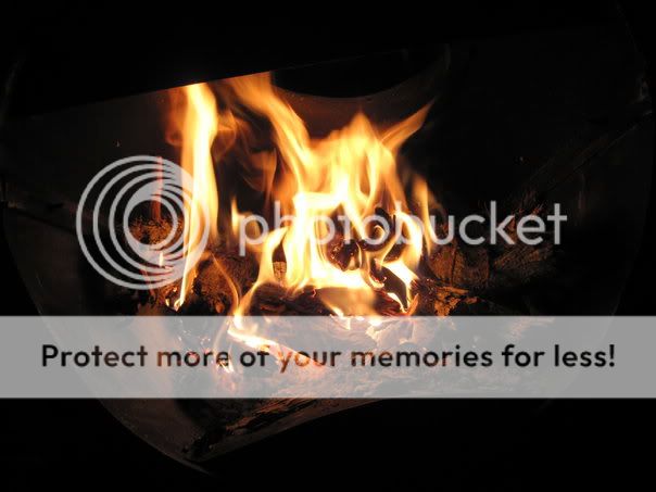

We also made a woodstove from some black 22 Ga. stovepipe.
Plenty of heat for cooking from the stove.

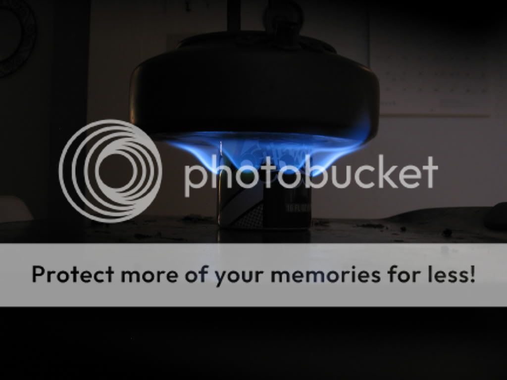

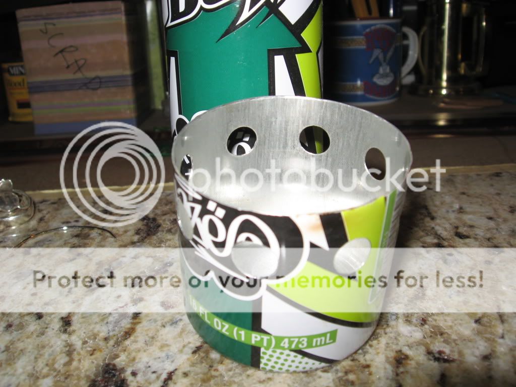

here is the two stoves I use. one is from a aluminum mountain dew bottle and the other a red bull can,.
the woodstove is great! I bet it's a light weight one, too. I've been thinking about pounding up some 1/8 inch steel into a little box stove.

hrm. how shallow can those be made, reasonably? We go through 5 or 6 mink oil tins a year.....
I think even a 1/4" deep can would work good.
Disadvantages: soot (depends a lot on the quality of the wax)
and you have to wait for the wax to cool and solidify once you put the flames out.
the problem with 'light' stoves is I have seen many literally melt due to the heat of the fire inside.
I think that's just dependent on a bit of care and thought. We have a very hot and fast burning wood locally, hackberry- and I've managed to make my cast iron stove glow with that at full tilt. but with a gentler fire in a tubular stove like the one in the thread - with a grate- I've spent a few nights in a friend's tent and never had a problem. toasty, but doable.

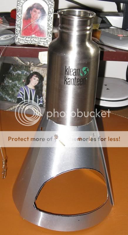

Here are a couple of "Caldera Clone" stoves I made to use with an 18 oz. Klean Kanteen.
This one's the two-piece with holes cut for use with Esbit tabs or an alcohol stove.
Here is a three-piece version I cut holes in to use as a wood burner.
Once I have the design perfected I'll probably try one out of titanium. (I hope the material can handle the folded flanges.)
